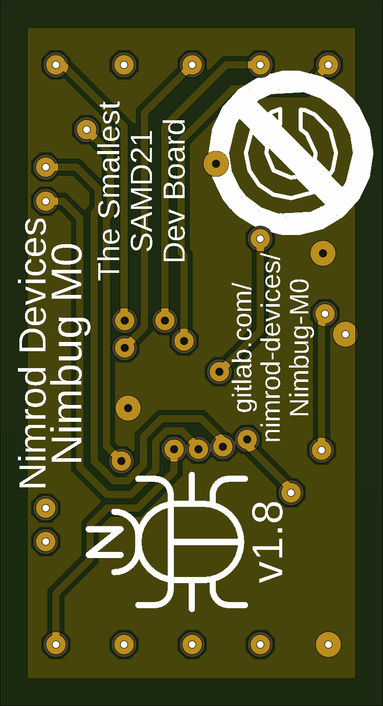

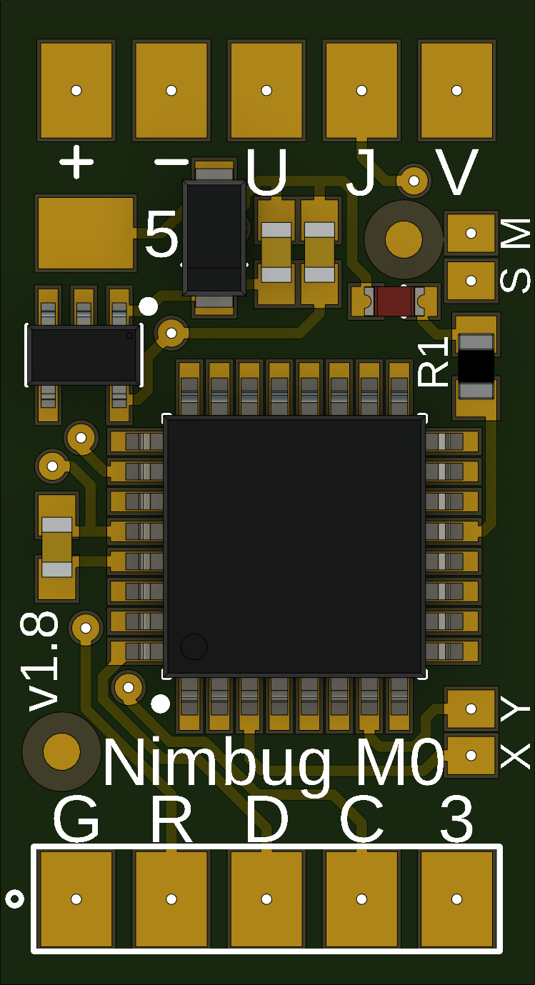

I designed a PCB (an improvement on the Rebug SwitchME M0) and ordered 30 (0.6mm thick) for $5 from JLCPCB with the slow ~$3 shipping. Then I ordered the parts from DigiKey, enough to make 3 boards (because shipping was way more than the BoM cost, and there were price breaks on most components).
Improvements over the Rebug SwitchMe M0:
  • Solderable by hand without reflow soldering. (You will need flux and solder wick though.)
  • Fiducials make it ready for automated production.
  • Careful "repair-friendly" layout prevents ripped pads from interrupting signal flow.
  • Exposed solder pads are anchored by vias, reducing the chance of wires ripping them off.
  • Pads are more easily labeled with ease of installation in mind. (U = USB, J = Joy-Con, V = Vol+)
  • Pads unused in a modchip install are moved to mini-pads, allowing the other pads to be bigger for ease of soldering.
  • The APA102 "DotStar" data and clock lines are broken out onto mini pads. In case you wanted them!
  • Seeing as most modern modchip software has a method for entering bootloader mode without the reset button, it was omitted.
    • The R pad is the reset pin if you do want it. It's right next to ground (G), and some tweezers can act as a temporary reset button.
  • It's got a cute little bug mascot too! ;)

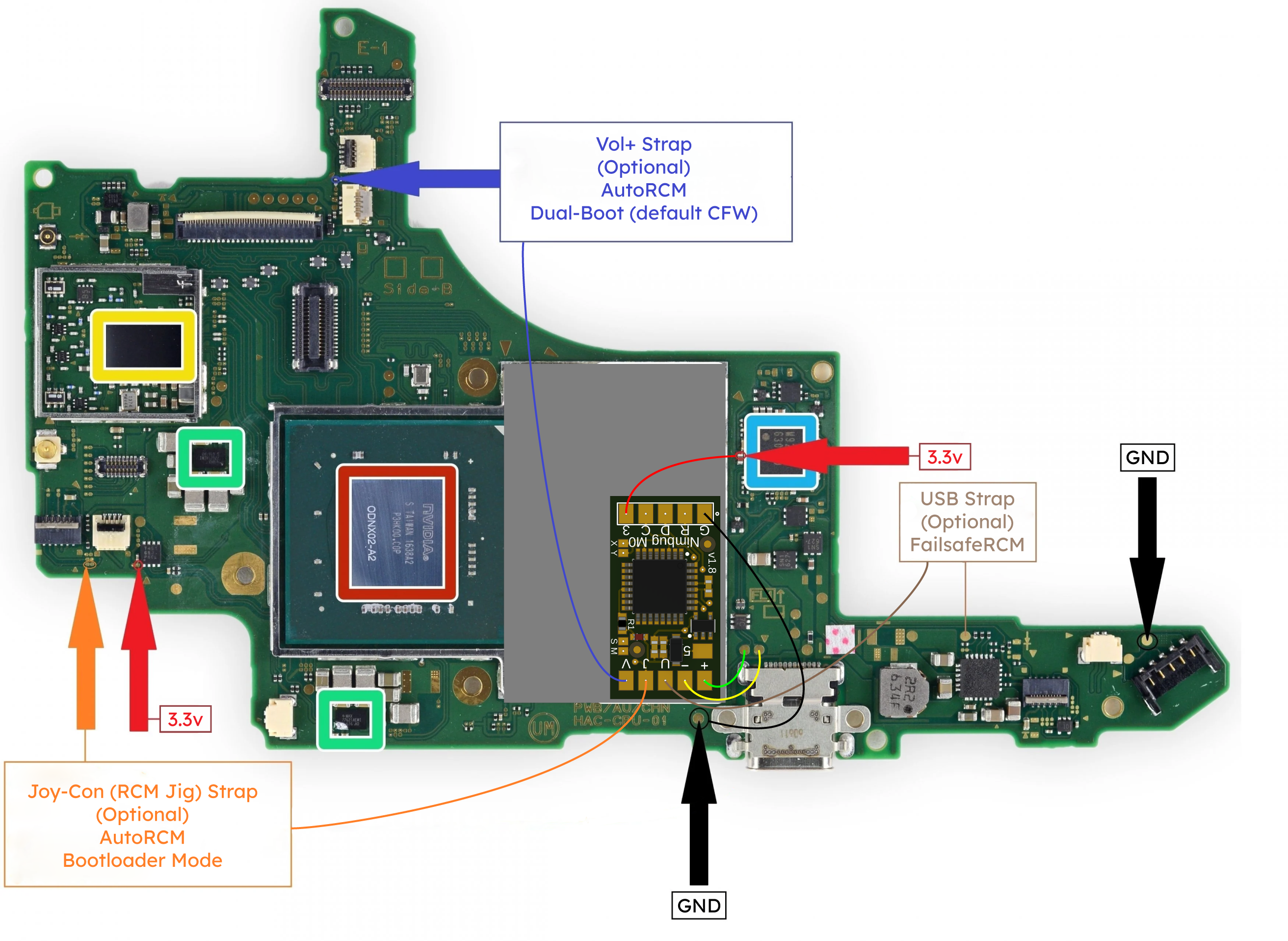

You can upload any software written for the Rebug SwitchME M0, and following the pinout chart, you can work out which pins correspond to the Rebug pads. If you're installing as a modchip, use this image (ignore the function descriptions, they are for an experimental minimalist modchip software I'm working on called Hekate-NIMBOOT):
Here is my install pic (Kapton tape removed so you can see):
You can make these yourself if you want! Just order the PCBs from JLCPBC (or similar), then order the components from DigiKey (or similar), and finally solder them according to the images! After that, you will have to flash the UF2 bootloader with a SAM programmer (you can use a Raspberry Pi or another SAMD board like the MKRZERO). Finally, you can follow the instructions to install your preferred modchip software, such as Fusée Suite.
