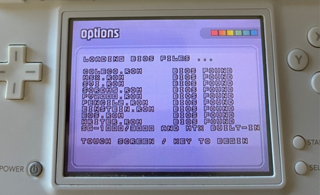

  • Tatung Einstein support. Only .COM files run and requires einstein.rom BIOS

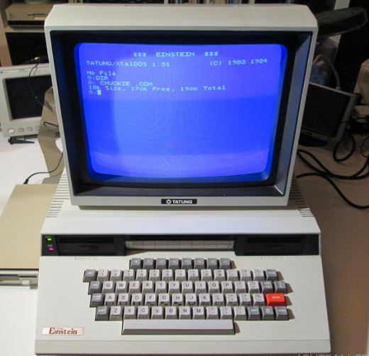

I spent an evening reading and re-reading the Tatung Einstein hardware manual to try and figure out why my emulation is so poor. The only working Einstein emulator is MAME and it's not very well commented. I feel like I'm doing everything reasonably correctly and yet the compatibility is very poor.
The Tatung Einstein TC-01 and 256 were high-end machines with floppy disks built in plus a serial port and all kinds of really nice hardware possibilities. Apparently more than a few Z80 developers used these machines to program their games for other machines (Speccy, MSX, MTX, etc).
The hardware manual has been invaluable in getting my knowledge up on this machine. But the problem in my emulation has been elusive... until this morning with coffee when I realized something: it's not what the hardware manual INCLUDES but rather the manual is MISSING.
Namely that when the VDP (video display processor) hits a Vertical Blank (50 times or 60 times per second depending on PAL vs NTSC), there is NO interrupt generated. This is highly unusual. Every other Z80, TMS99x8 system ties the VDP vertical sync to some interrupt source on the Z80 microprocessor. Except this strange beast of a machine!
So I'm really amazed that my emulation works at all... since I'm calling the standard interrupt source on vertical blanks. Maybe some games (the working ones) don't care... they might not do anything with the interrupt source. But most games will want to hook into the interrupt source and my firing this interrupt will cause the Z80 CPU to jump to a vector for the wrong reason. I don't know if this is my problem - but it's 90% sure to be a major problem with my emulation of the Tatung Einstein. When I get home from work today, I will certainly try it!

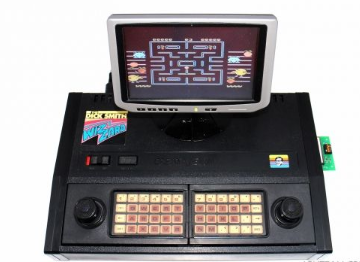

In 1981, a system called the CreatiVision was like the Colecovision and Intellivision had a child out of wedlock. This thing featured the same video chip (TMS99x8) and the same sound chip (SN) as the Colecovision but rather than a Z80 CPU, it featured the M6502 chip (like used in the Apple or Atari or Commodore systems).
And... as it turns out... someone ported ColEM (the baseline emulator I started with) into a CreatiVision emulator (called FunnyMU). This swaps out the Z80 core for the M6502 core.
And so all I have to do is port that port to my port and.... we will have 17 exclusive games to play on this weird system!

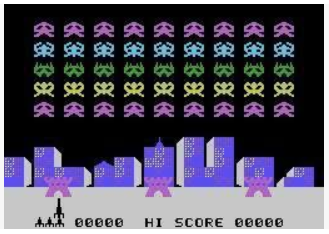

The CreatiVision (aka Wizzard) emulation is in... all 20 or so games work but there is a small issue with sound on a few games. For example, the harpoon fire/shot does not make a sound in Deep Sea and Planet Defenders (same game, different theme/graphics). And Sonic Invaders has a high-pitch tone that is annoying. Both of these audio artifacts are present on the source emulator FunnyMU and not present on real-hardware. So I'm not sure what's going on... but I will debug it another day. The missing sound in Deep Sea and Planet Defenders is really minor enough - those are still fun and playable. Other games seem to have generally correct sound. Maybe there is something unusual about the hardware for the CreatiVision and they assume some frequencies/tones won't be produced by the hardware...
EDIT: I patched Sonic Invaders so it's not high-pitched screechy. Not a perfect fix but good enough for now.
You will need a bioscv.rom BIOS for this machine and rename the .BIN/.ROM files to .CV so it loads up the right driver.
