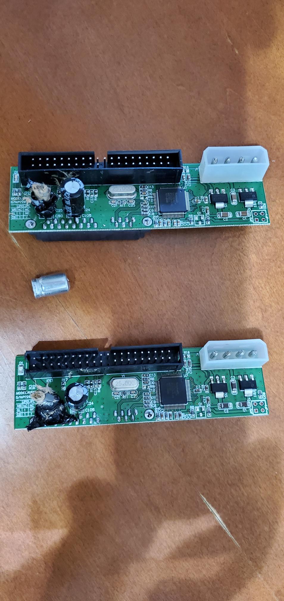

I have two of these original XBox.
One is a V1.6 Mother Board, the other is a V1.0.
I managed to put an ADATA 480GB SSD in the V1.6 with an adaptor I had several of. Since the newest build of the soft mod tools supports Partition tables, it was breeze, and now I have my whole library on the SSD.
I ran into ... uh ... problems on the V1.0 board though.
I tried the same setup, and the adaptors literally exploded with shrapenal when I turned the xbox on. Were the V1.0 XBox known for PSU over voltage failures? Because original drive still works, but it no likes my adaptors...
Do replace the capacitors if they're buldging, and most certainly always remove the clock cap if your mobo revision is a 1.0 up to 1.5.
Aahhh, I never removed the clock cap.
What was the problem with that cap? What issues did it cause (besides burning out)
That capacitor is prone to leaking acid all over the motherboard, damaging traces. Its been a common problem in most of the OG Xbox's lifespan.
