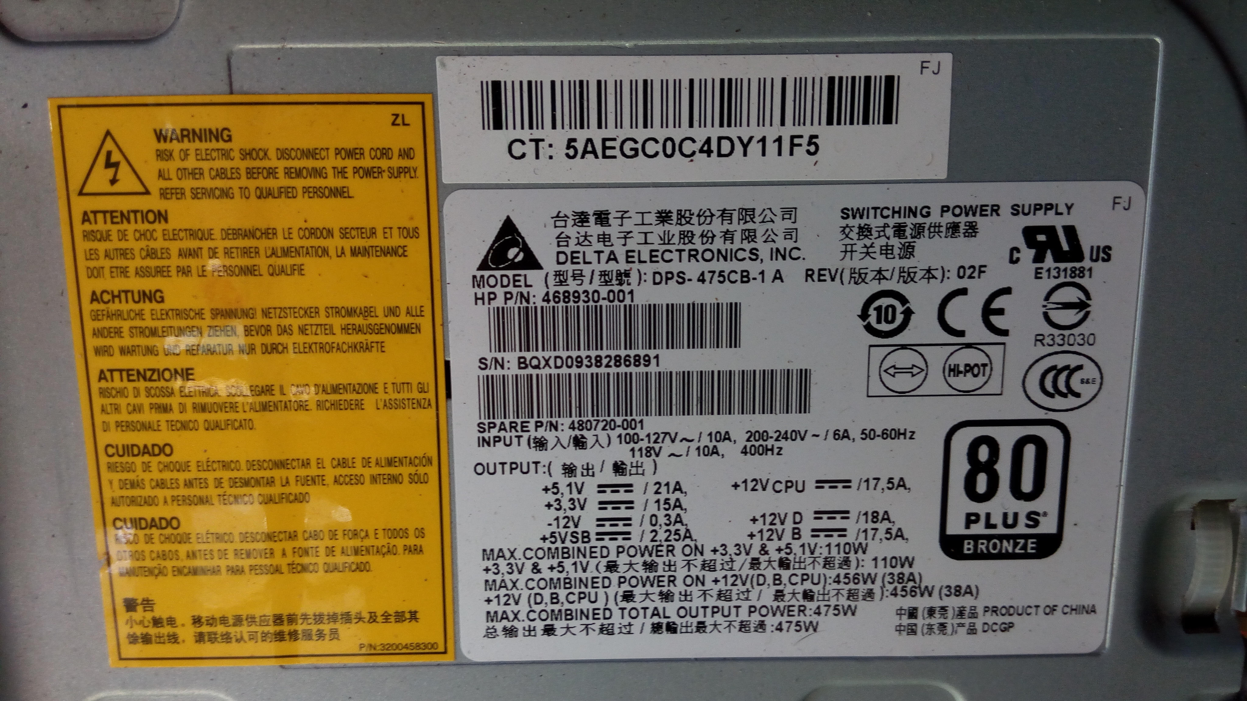

Hardware Can my computer power this gpu?

Here is what I could find.
MOTHERBOARD
CPU (Not sure if this will work. [also not sure if this uses the right type of socket.])
RAM
GPU
I need someone to find me a PSU that will work with all of this.
MOTHERBOARD
RAM
GPU
My current CPU is x64.
All CPU nowadays will be x64.
Everyone else will have good advice on that particular setup, but a cursory look seems like it'll go well together. Personally, I set a budget and a goal (I want to play X game at 2k @144hz), and go from there.
Also, might be worth looking into monitors to compliment your new hardware (like 144hz, HDR, and other stuff).
as far as PSU goes, i'd say bare minimum of 500watt, but I'd feel more comfortable with a 750watt. do a gold or platinum if you want your electricity bill to not be crazy.
I currently have two monitors. 1920x1080 60Hz (Primary) 1360x768 60Hz (Secondary, but used as if Primary.)
I the highest framerate that I want is around 70Hz (so that there isn't any lag)
The main reason that I'm trying to upgrade my rig is so that I can play Dragon Ball Xenoverse 2 at it's highest settings. My other games play at around 30Hz
I think a 1080 alone can run xenoverse 2 at max settings, so you might be able to save some money...if you can find them. But I don't have first hand experience, so someone else will have to weigh in.
