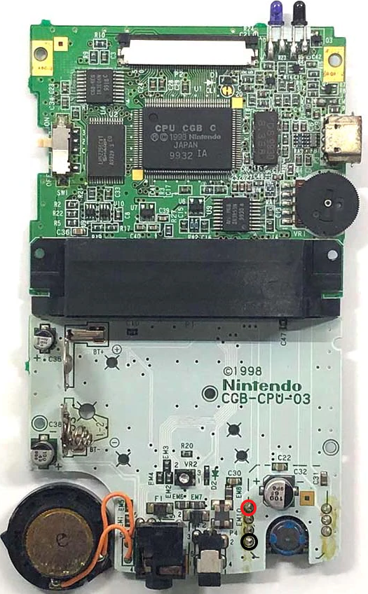

I'm currently trying to mod a GBC with some LEDs for the buttons, but I'm a noob at this and I'm a little lost because there aren't any build guides. The way I have it now, the LEDs are on any time there's power to the console regardless of if it's on or not, which I don't want. How can I wire them so that they only turn on when the console is powered on? Obviously, I'm really not great with electronics yet, so if you can answer me with baby-simple language, that'd be great!

Oh, my gosh, thank you! How did you know to use these pins specifically?
I have a speaker amplifier mod on my GBC. I use those pins. It's 5 volts and ground. The pins you are using are connected to the batteries so even if you didn't have the console on the leds still took drew power from your batteries.
Oh, okay! Thank you so much for your patience with me!
No problem. Let me know when you got it all set up. I'd like to see the finished product.
Will do! I actually wanted to do two LEDs, is there another set of points you might know of that would provide the same power? Also, the first two worked, so endless thanks for that!
You can wire your extra leds to the same pins.
