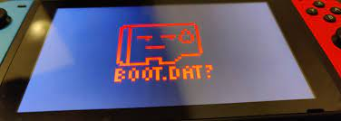

I had a modchip installed on my Switch V2 (Mariko) last week by a guy found on Marketplace. So I can't confirm exactly which chip was used, but he told me it was HWFLY. During the modification, he supplied a 256 GB microSD card (SP Silicon Power). Everything worked fine all week long.
I quickly realized that 256 GB was not going to be enough so I ordered a Sandisk Ultra 512 GB card to increase my capacity and at the same time have better performance with a better card (Sandisk instead of SP).
I followed Rentry's guide to migrate my emunand to my new card and that's where my problems started. When the process was completed and I restarted the console with the new card, I got the error in red "boot.dat". I didn't panic at first because I told myself that I was going to put back my 256 GB card that I hadn't touched and that everything was going to work perfectly. However, I still had the "boot.dat" error. However after some trial and error by pressing the power button 2 times (sleep - unsleep) finally started it in Hekate and worked normally.
So I took the courage to try a second time with the 512 GB Sandisk card, but this time I tried a "clean" install from scratch following rentry guide for , but again the "boot.dat" error.
When I put my 256 GB card back, I still had problems with the "boot.dat", but I was able to bypass it again with clicks on power, but it was more complicated.
I'm now afraid to try other things and even my original card won't work.
I found several forums on the internet mentioning this kind of error, but few concrete solutions. A few times it's mentioned that the SD drive is probably dead, but I'd be surprised since before installing the modchip I never used an SD card and I used it less than five times since that.
Have you ever experienced this?

Maybe but why I started to get this error when swapping the sd card? The 512 gb have the exact same files structure including the same boot.dat from the 256 gb.
And why I have the same problem now with the 256 gb sd card? However it seems I can bypass it on the 256 gb doing sleep - unsleep with the power button. Is it normal when you start Hekate for the first time on a SD card?

I could understand that my 512 GB card was not well formatted. I must admit that on first try it was even in exfat straight from the box or maybe one of the files was corrupted, etc.
However, what can explain that after the two failed attemps when I put back my "working" 256 card I got the same error "boot.dat"? The two times I could however remove it pressing power button two times (sleep - unsleep)
Should I exclude a faulty SD card reader if I can play normally on my 256gb microSD even if basically every solution on the net to solve this error looks as to replace the reader?
