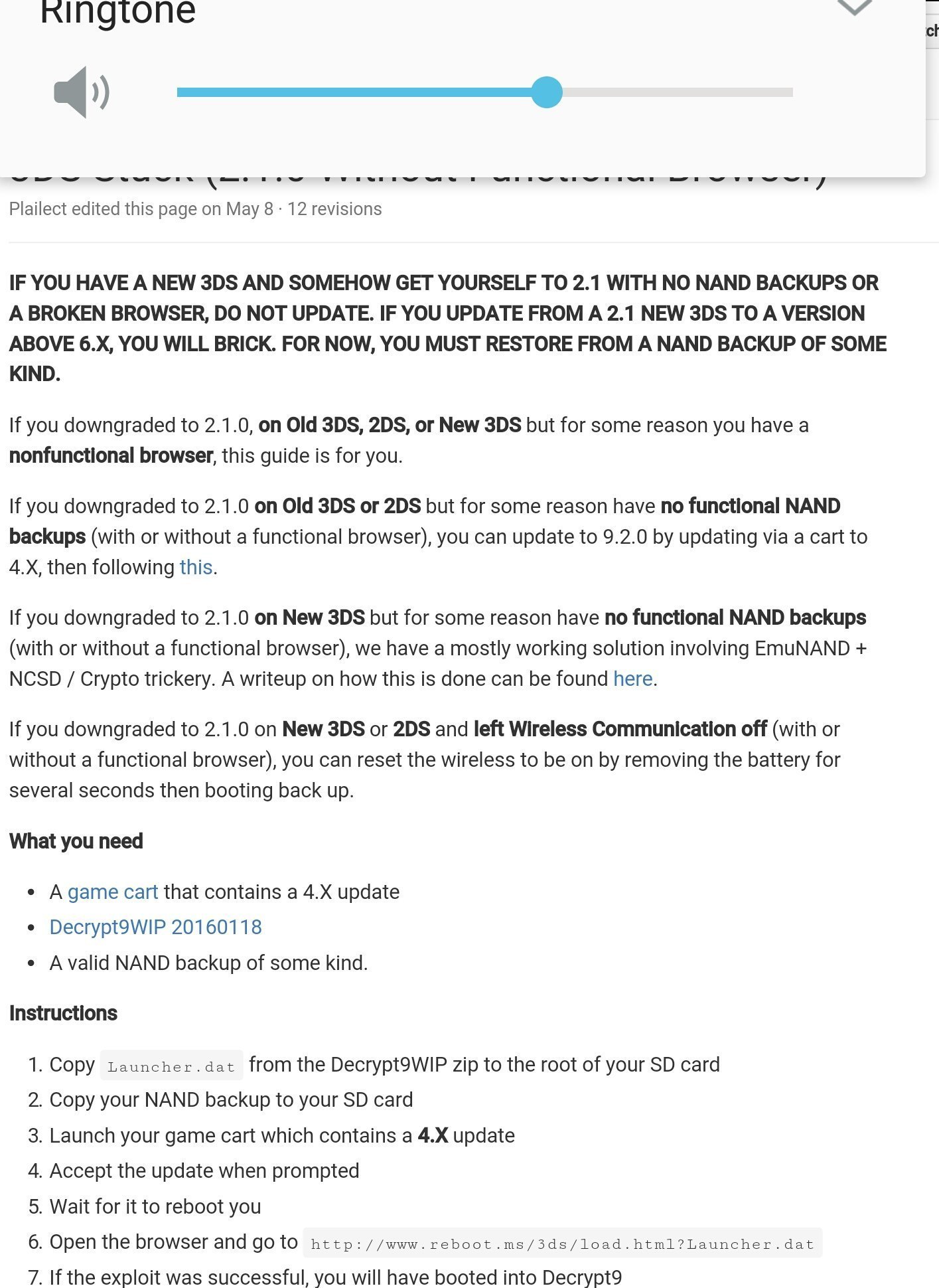

I wanted to install the arm9loader and downgraded to 2.1.
i followed this guide here https://github.com/Plailect/Guide/wiki/Part-4-(2.1.0-Downgrade)
Everything was fine and i wanted to start part 5 (arm9loaderhax) but i was stucked on 2.1.
My RedNAND and my SysNAND was on 2.1 and i thought this guide would help me https://github.com/Plailect/Guide/wiki/3DS-Stuck-(2.1.0-Without-Functional-Browser)
So i put the mh4u cartridge inside my n3ds and updated the system.
i thought i could start now the web browser but it always says that i have to update my system if i want to use it.
So tried to install the supermysterychunkhax but the system told me i have to update it if i want to play it.
So i updated to 10.2.0-4E (i guess) and started the game but i got always an error.
I can't open the configurations, the camera or the web browser i always get a black screen.
I did some backups bevor but i don't know how to restore it because i can't get access to the homebrew launcher.
i really don't know what to do anymore.
can anyone help me?

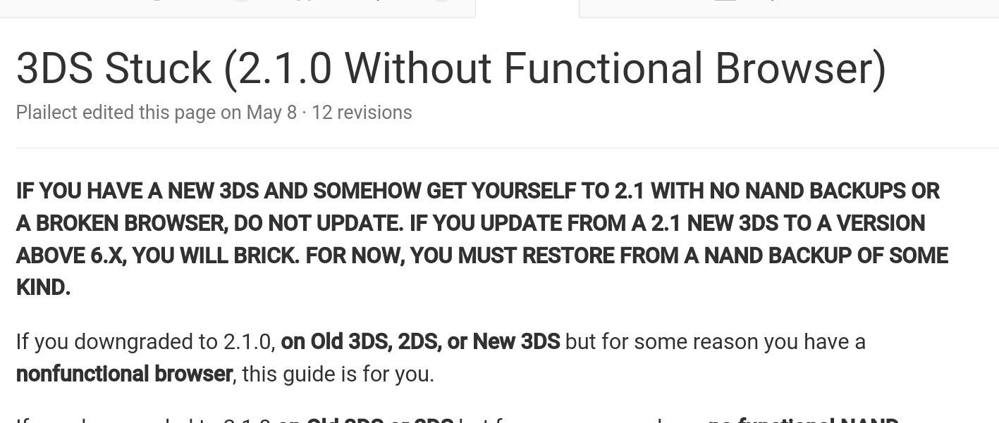

why the hell you updated did you get your otp
IF YOU HAVE A NEW 3DS AND SOMEHOW GET YOURSELF TO 2.1 WITH NO NAND BACKUPS OR A BROKEN BROWSER, DO NOT UPDATE. IF YOU UPDATE FROM A 2.1 NEW 3DS TO A VERSION ABOVE 6.X, YOU WILL BRICK. FOR NOW, YOU MUST RESTORE FROM A NAND BACKUP OF SOME KIND.

The guide said that i don't know :O
I still have my backups on my pc but i don`t know how to restore it.
Is it possible to get into the homebrew launcher or is it over for me? :/
if i get it right you updated your console to directly to 8.1.0 with monster 4 ultimate

i updated with mh4u and then i update with pokemon super mystery dungeon to 10.2.0-4E (i guess... can't take a look)
I can't use the cubic ninja hax because i can't update the qr code on the site to 10.2.0-4E only 10.2.0-7E...
That's why i'm so confused i tried so much :/

Wtf can't you read? The guide says clearly to not update your system if it's a new 3ds. It's on top written with capital letters. You have no chance you must hard mod the system. You messed up.

but i didn't updated through the ninendo service to 11.0 only trhough the game and my wifi was turned off :O

This doesn't matter. An update is an update and it's irrelevant how you installed it. Nobody wrote that you need to update the console. Believe me you can't get the device working again without a hard mod and a valid backup.
You can still use the QR code for -7E. Ninjhax 2.x doesn't use the browser.

it doesn't work...
but i have an idea!
can i use the 3DS from my cousin, install ninjahax to the save file and use it on my n3ds?
i mean i only need to open the qr code option and i must be in the homebrew launcher after that or not?

it doesn't work...
but i have an idea!
Oh I just thought of something. You have internet access on your console right? The QR code won't work without that.
But yes, if you want to you can use a homebrewed 3DS to add a save file to the CN cartridge. Might be hard to find those save files though.
