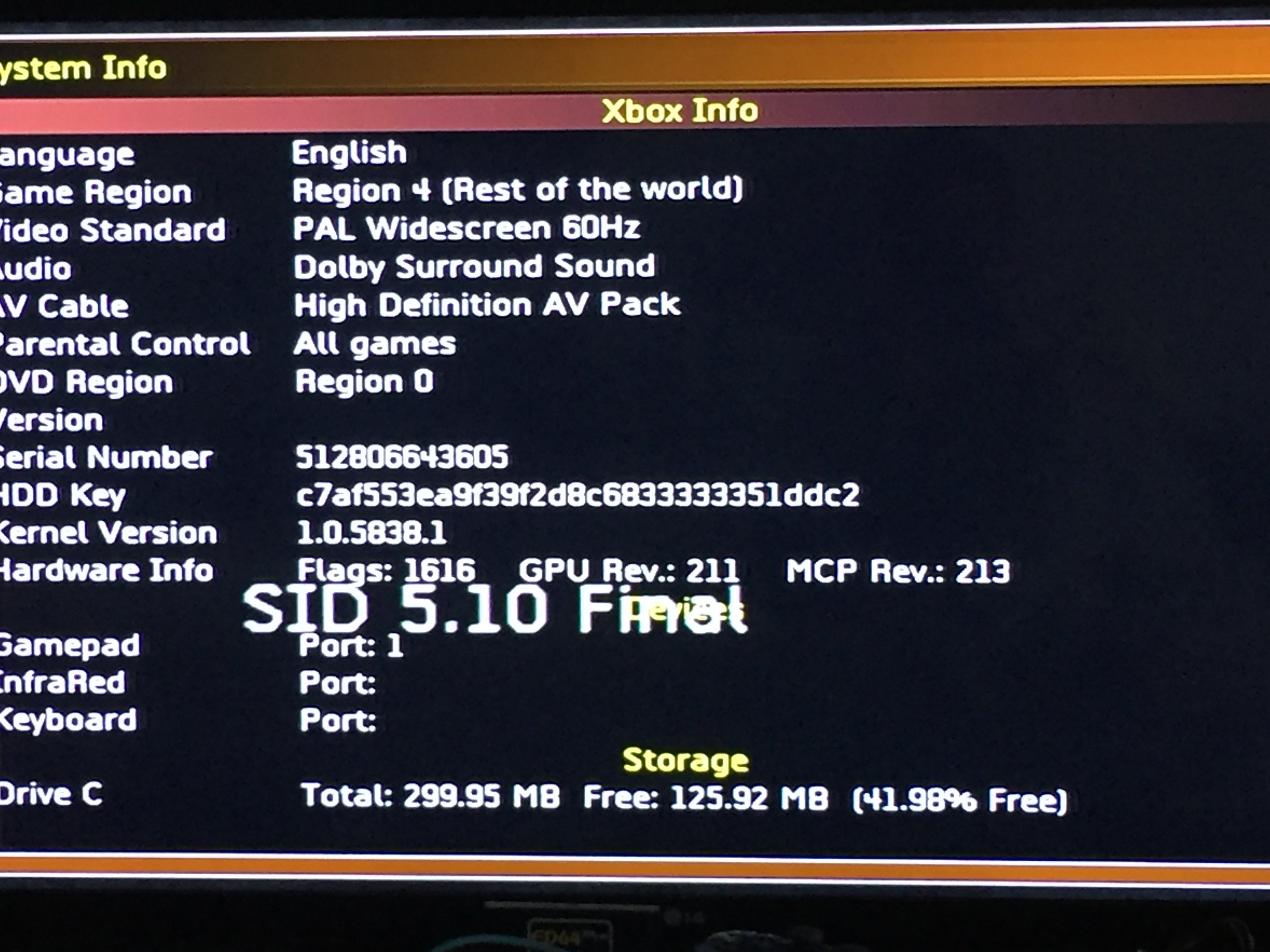

Ill bet its a 1.6 xbox. Arctic Thunder and a handful of others, csnt run 480p without a patch on a 1.6 xbox. Video chip differences. The patch is easily installed in xbmc.

^system info on the offending crystal xbox, noticed the blank version info whereas the box that doesn't have the issue says version v1.1 (0b)
