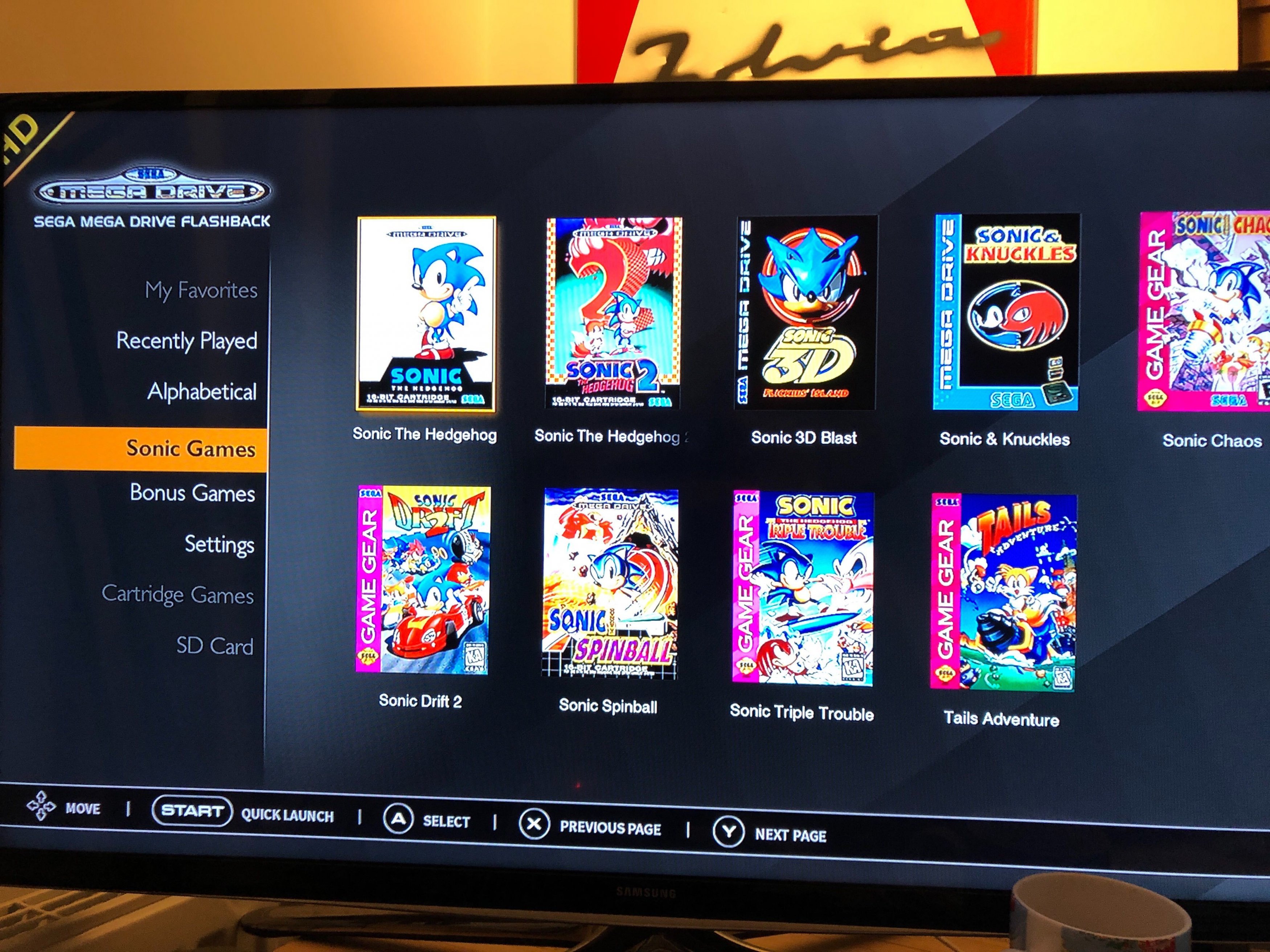

Turns out all it needed to complete successfully was unchecking the top row (parameter), I then flashed all the other partitions and it's working great again.
Thanks again for your help!!
