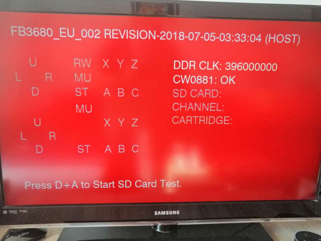

I have bought some second hand at @ames Sega Mega Drive Flashback, i has been good price. But when i connect to TV i got this on screen?
Red screen with some error says press D+A for SD CARD TEST
Anyone got the similar problem, is it possible to fix this somehow, i hear music in the background?

yep. its stuck in test mode. you would need to reflash the system.img to fix it. I would not recommend that if its brand new though. just get it replaced.

Thanks,it is second hand not new one, but how to reflash, i have tried to put sega_update.img on SD card and reboot, nothing happens? Any other flashing method that i can use, maybe to open it up?
