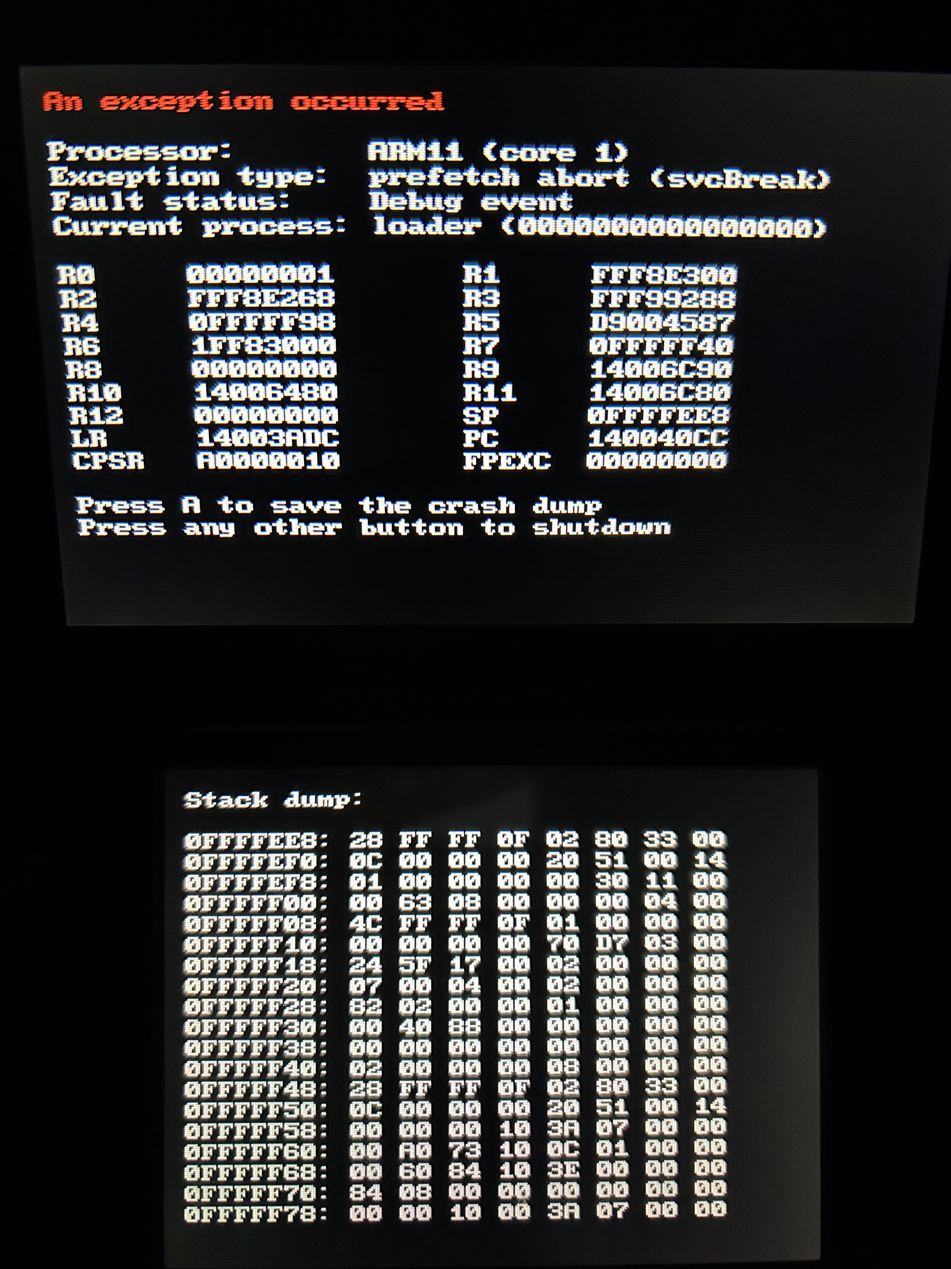

Every time I try to load Animal Crossing through cartridge this error comes up
First, disable all mods, cheats, and plugins to eliminate the potential cause. If this works, congratulations! You've found the problem.
Then, try cleaning up the cartridge contacts and reader contacts using isopropyl alcohol, and then dumping the cartridge to digital format (for instructions on how to do this, see https://wiki.hacks.guide/wiki/3DS:Dump_titles_and_game_cartridges)
If NONE of these options work, try using the cartridge fixer to fix the corrupting cartridge (https://3ds.eiphax.tech/cartunfuck)
