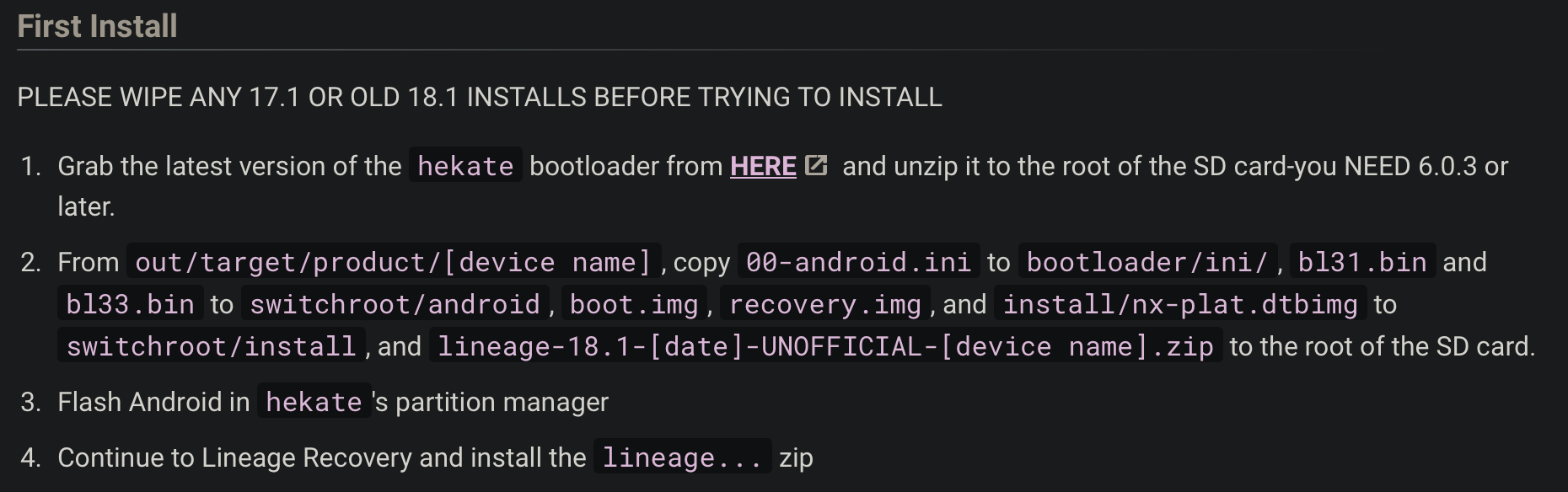

im trying to boot to the android recovery on my mariko switch but i get L4T error path missing. how do i fix this. I am doing this on a modded switch oled.
Weird, I haven't encountered this issue. Have you ever check your hekate's version yet? You must ensure it's the latest version.

i am using the latest version of hekate (6.0.4) i even tried 6.0.3 but i get the same error. even tried different sd cards. if i google the issue on google i only get ubuntu results, but ubuntu works fine on my switch.
gotcha. the .ini file in bootloader/ini was wrong. correct it to:

notice that there was a underline _ between 'boot' and 'prefixes'.
