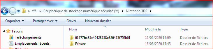

1- I just tried the formatting (quadruple) but when I use "guiformat" it refuses to format my card with this parameter 32768
guiformat automatically suggests 16384 and it formatted it with
the other stages of the quadruple work perfectly

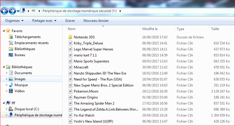

2- and quad I tried to update to boot9strap-1.3, I can't find a Luma3DS folder in my sd card to continue the copy of the update method,
Here's what's on my SD card for my hack.
thank you very much for your help
I write this message with https://www.deepl.com/translator
how did you know I was translating my message?

@lyokohack, download and rename these two versions of SafeB9SInstaller v0.0.7.
  • SafeB9SInstaller.firmboot.firm
  • SafeB9SInstaller.binarm9loaderhax.bin
Here is where to download boot9strap v1.3.
When following these guides,
, place the files on the SD card like this.
  • sdmc:/boot9strap/boot9strap.firm
  • sdmc:/boot9strap/boot9strap.firm.sha
  • sdmc:/boot9strap/secret_sector.bin (New 3DS series only) *
  • sdmc:/arm9loaderhax.bin (BIN version of SafeB9SInstaller)
  • sdmc:/boot.firm (FIRM version of SafeB9SInstaller)
After upgrading or updating to B9S v1.3, delete those above five (5) files.
Download and add Luma3DS v10.1.3 to the SD card.
  • sdmc:/boot.firm (Luma3DS)
Follow this guide.
To make this slightly easier, here is a CFW starter kit. The following will need to be completed.
  1. System update the 3DS firmware to Sys 11.13.0-45E.
  2. Install homebrew apps onto the HOME Menu (*.cia versions) and/or Homebrew Launcher (*.3dsx versions).
  3. Install CTRNAND Luma3DS. This is to allow the 3DS system to boot without an SD card.
  4. Make a backup copy of the SysNAND *.bin image. Keep this file safe on computer or external drive.

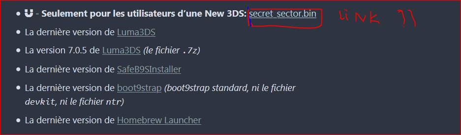

but I didn't use this file "secret_sector.bin" (I have a doubt for my console (I have a new 3DS LL ? ))
and under firmware 11.4.0-37E
so should I put it on or not ?
when I switch to the Download play Nintendo app and I realize and then " I quit the app to go to the "Homebrew Launcher" step.
when I switch to the Nintendo Download play application and then select "“Switch the hb. title to the current app." "Homebrew Launcher" step and run Nintendo Download play
I have the problem of
 Am exeption occurred
Processor : ARM11(core1)
Exeption type : prefetch abort (svrBreak)
All New 3DS series [ New 3DS | New 3DS XL | New 3DS LL | New 2DS XL | New 2DS LL ] from any region [ JPN | USA | EUR | KOR ] has this file.
The secret_sector.bin is also known by this other name.
  • [S:] SYSNAND VIRTUAL/sector0x96.bin
If your n3DSLL has the older A9LH custom firmware, secret_sector.bin is required to upgrade A9LH → B9S.
If your n3DSLL has the newer B9S custom firmware but an outdated version, having this file there or missing at:
, the SafeB9SInstaller (FIRM version) will still update B9S v1.0 → B9S v1.3.

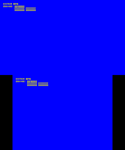

Can you take clear picture of this crash, and upload/post the picture here? Your error is not expected.
This is the common error new users usually encounter with Homebrew Launcher.
An exception has occurred
Processor: ARM11 (core 1)
Exception type: undefined instruction
Current process: loader (0000000000000000)
This problem is due to missing new-hbmenu.
  • sdmc:/boot.3dsx
