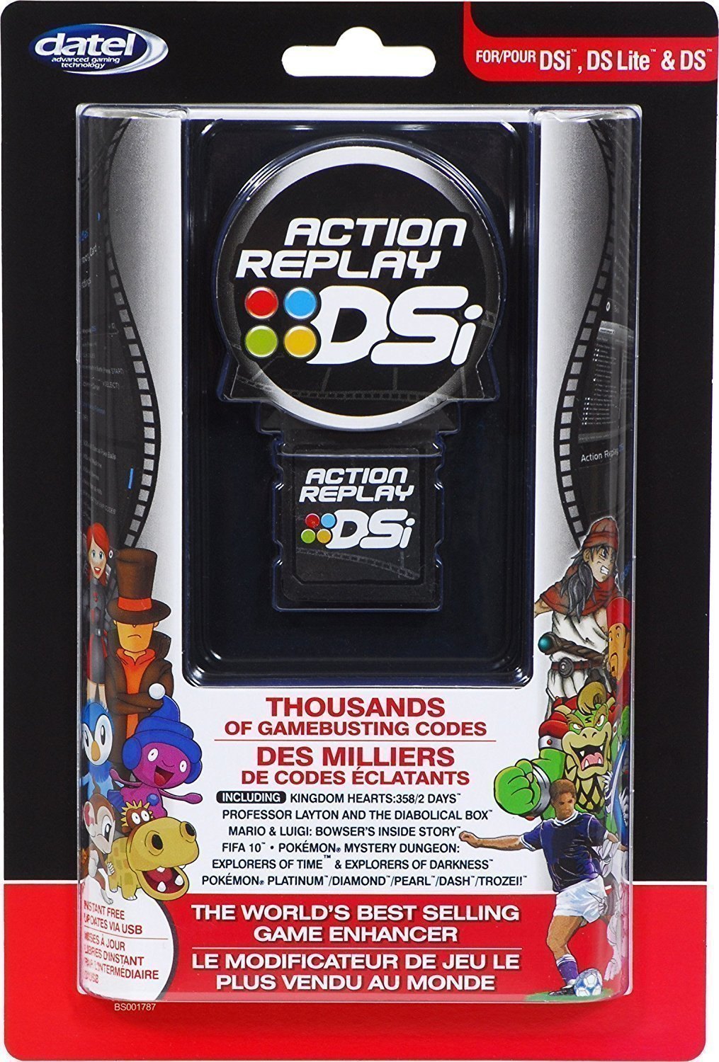

So I got this bad boy right here
and I've flashed it and modded 2 of my friends 3DS with it.
Took a bit, but they both eventually read the card fine.
Now I've got 2 other 3DS here, and well, it won't read, period.
I put the card in my 3ds and it recognizes it just fine.
It's baffling and it's giving me a headache.
Am I missing something?
Anywho the 2 3DS in question are:
Old 3DS XL - 11.5
NEW 3DS XL - 11.6
The two I recently modded were :
Old 3DS -11.6
Old 3DS 11.5
Not sure what happened or what is going on, has anyone run into this?
Maybe just reflash to it's stock, and try again?
Anyone?
This is driving me nuts, I can't find a viable reason why it wouldn't be read.
My friends old 3DS...es. Were from the first wave of Regular sized and XL models.
Maybe thats it? Maybe certain builds from then on block the Action Replay DSI?
I mean, in my experience the AR DSI has to be READ from the DS to boot the exploit right?

You can put a paper behind the pcb to make it read more reliably.
Acekards have sometimes similar problems.
But be glad you could flash your ARDSi at all, my ARDS is so deprecated, Datel released two hw revisions and the first one that I have only connects on Windows XP, the latest version 1.55 is only downloadable via wayback machine and I had to change the header via the ARDS Flashtool to make it install the modded firmware.
NTRBoot worked first try on this card btw.

And yeah just wiggle it around. I put a normal ds game in the slot until I heard the click then removed it and replaced it with the ards too. That worked.

UPDATE
By hook or by crook, the New 3DS got through some how.
All modded and good to go.
Now this Old 3DS is still giving me the same issue, but it's good to see that you DONT need it to read the AR.
It's just dumb luck, but hell, this is taking a long freaking time.
So notes to any other people looking and what my situation was:
I HAD A BLACK LABEL DSI AND FLASHED VIA PATCHED CODE MANAGER .
I HAD A COUPLE 3DS THAT COULD READ IT SOME HOW , THOSE GOT HACKED FIRST TRY WITH MAGNET COMBO.
I HAD A COUPLE 3DS THAT COULDNT READ THE DSI ON THE MAIN HOME SCREEN. THOSE APPARENTLY TAKE LONGER TO GET THE BUTTON COMBO TO WORK.
IT WILL WORK THOUGH. IT JUST MAY TAKE A LONG FKN TIME.
