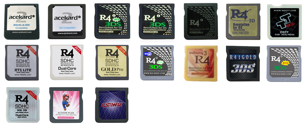

Here are all supported flashcards btw ;)
