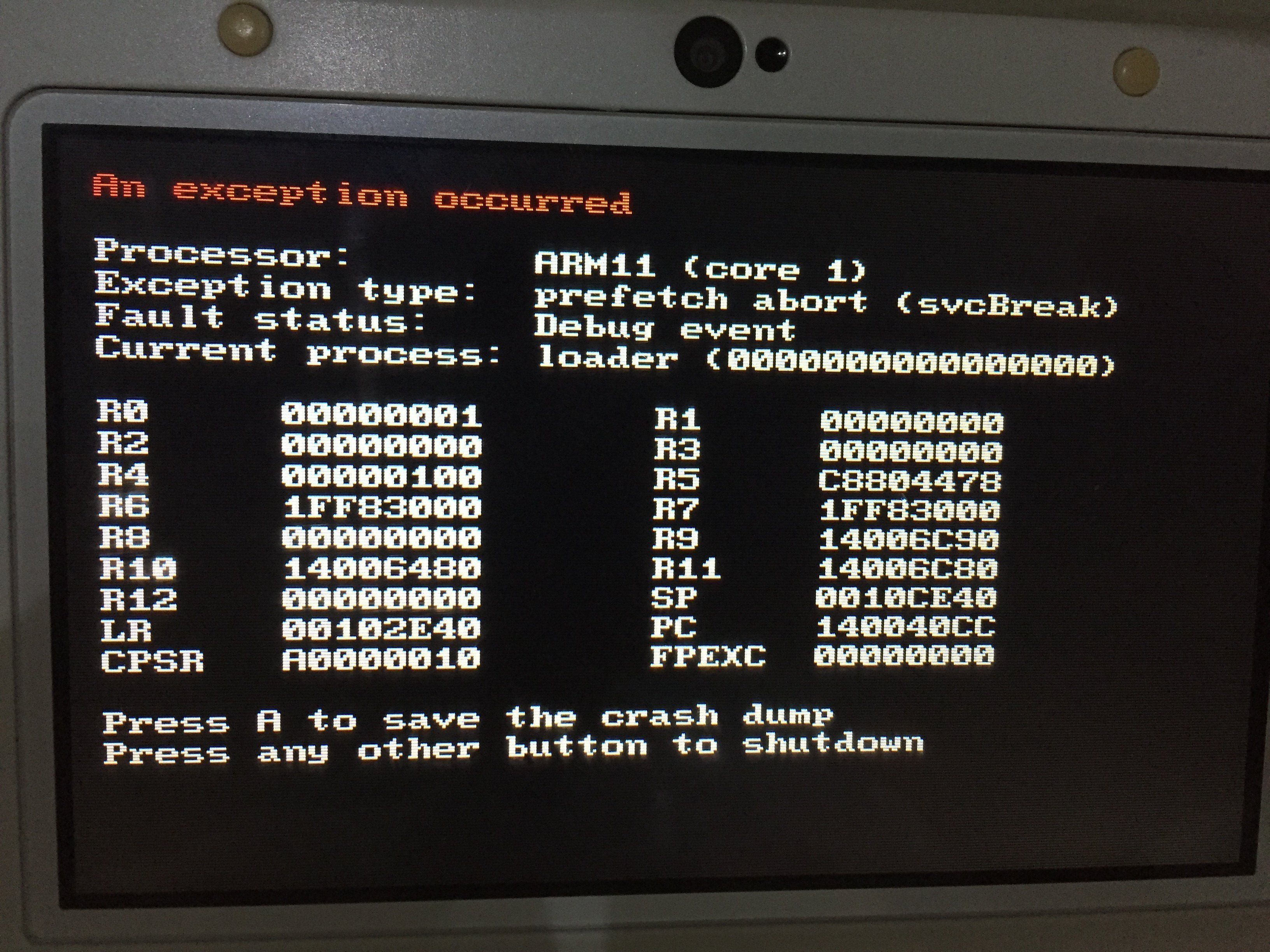

For some reason everytime i boot the homebrew launcher it basically tells me that an exeption occurred
Hardware :
New 3DS XL
Software :
Luma3DS CFW
Boot9Strap
11.8 Frogminer Method
Exception details :
ARM11
Core 1
Prefetch abort (svcBreak)
For more details about the exception i have a picture
CIAs can load
FBI can load
Homebrew Launcher (SteelHax - Rosalina)
Can’t load
A Fake Brick Screen always boots up when the system is on for some seconds then it boots to the home menu
I tried to switch homebrew to another app but it didn’t work
Plz help me
View attachment 149988 For some reason everytime i boot the homebrew launcher it basically tells me that an exeption occurred

What do you mean by Steelhax-Rosalina. Rosalina replaces any other entrypoints, so you just inject the HBL into another app (eg: Download Play). Do you have the necessary files such as the starter kit and the boot.3dsx in your SD card?

@ULikeThisNow, about the fake brick:
As for the ARM11 crash error, try this:
  1. Copy everything off your SD card onto a computer.
  2. Reformat the card in FAT32 + 32 KB cluster size with Windows File Explorer or guiformat.
  3. With the card empty, do a full Write + Verify Test with H2testw.
  4. If the card comes back with clean results, delete the *.h2w test files.
    • :!: If an error was reported, stop the test. Replace the hardware failed card, and go back to step 1 or 2.
    • Your game data and saves may be corrupt if there was error. :(
  5. Copy everything back onto the card.
    • If there was an error in step 4, supplement/replace your essential custom firmware files with the archive found here.
    • This is to ensure data corruption did not affect Luma3DS, GodMode9, etc. found on the SD card.
  6. Insert the card into 3DS and hold (Select) when turning on the system to access Luma3DS v9.1 configuration.
    • For default settings, select only (x) Show NAND or user string in System Settings.
    • Do not use ( ) Disable ARM11 exception handlers. This doesn't fix ARM11 soft bugs but ignores them, which is super bad.
  7. Press (Start) to boot to HOME Menu. Watch this tutorial video in how to Rosalina inject Homebrew Launcher:
Edit - If step 4 had an error.
8. Try Backing up all your game saves + extdata with Checkpoint or JKSM.​
