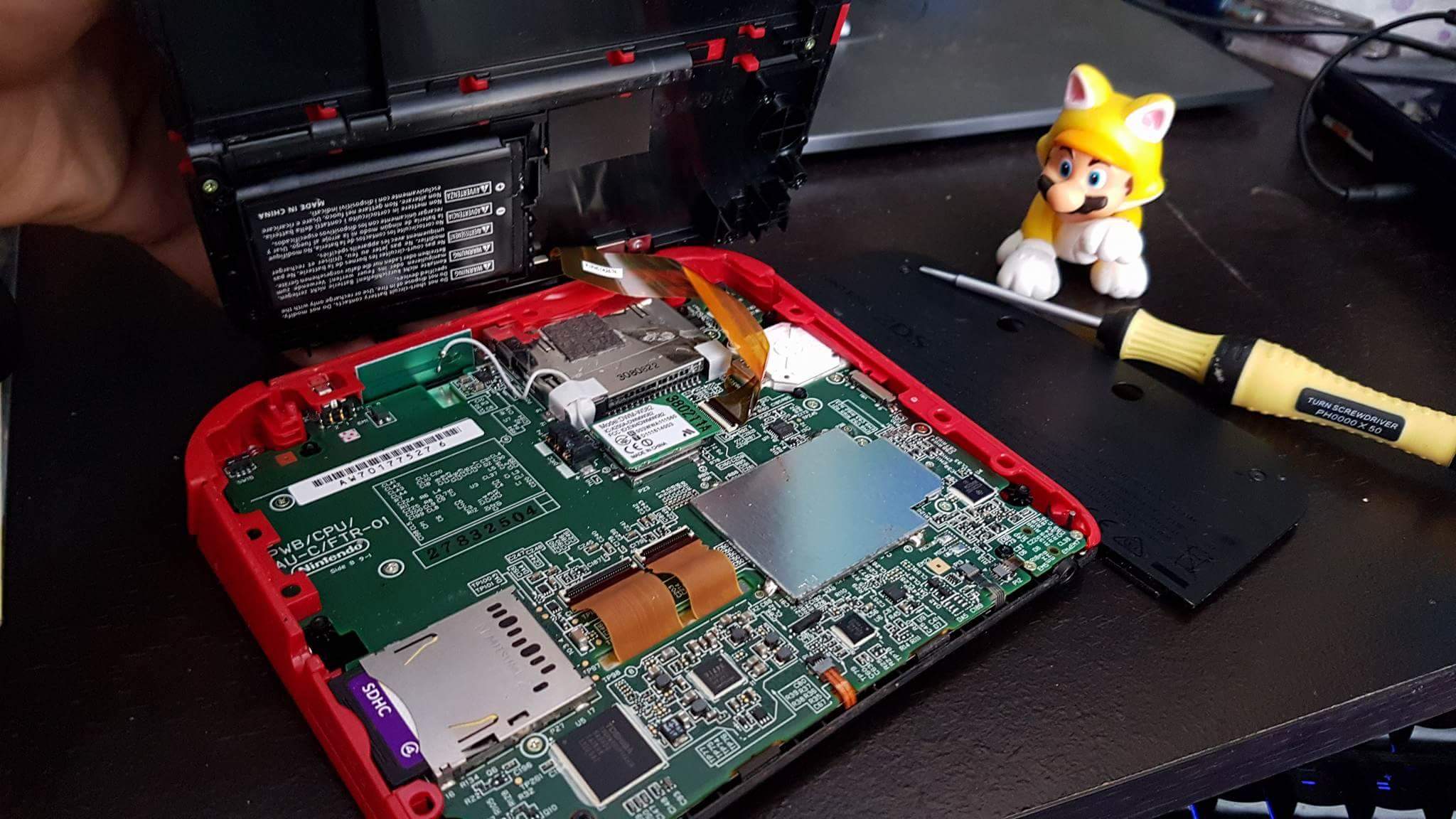

I disassembled it and removed and inserted again the ribbon cables. But no luck.

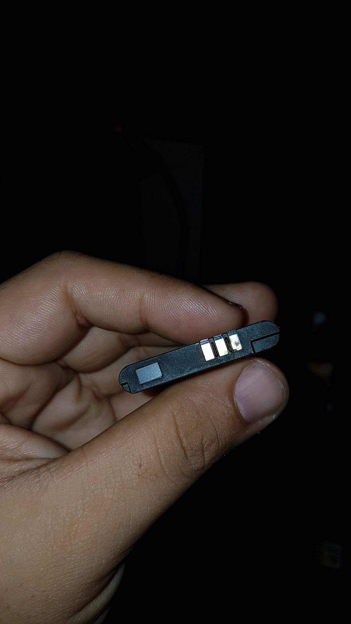

Could it be the battery?

I think I found the problem.
The ribbon that its under the mic really close to the 3.5mm jack has a lot of corrosion. The ribbon has green stuff on it.
remix2k
Mar 24, 2016
52
45
134
That is the LCD's backlight connector and it looks like the gold connector contacts are corroded enough to fail to connect.
That would cause your system to fail it's boot checks and shut right off.
And you are not seeing the screen light up because the backlight is not coming on.
Unfortunately, you're going to need a new screen as you can't get a backlight separately.
Sorry man :(

Thanks man. Is there a way to "clean" that ribbon?
remix2k
Mar 24, 2016
52
45
134
You can try cleaning the corrosion off the exposed gold contact sections but more often then not, the gold contact is actually eaten away and there isn't anyway to save it.
I have scraped back the ribbon plastic to expose more contact and then trimmed the end of the cable so it can slide into the connector and make contact with the exposed contact. I have done this on a few systems I've repaired but it worked once out of 3 systems so.... ;)
