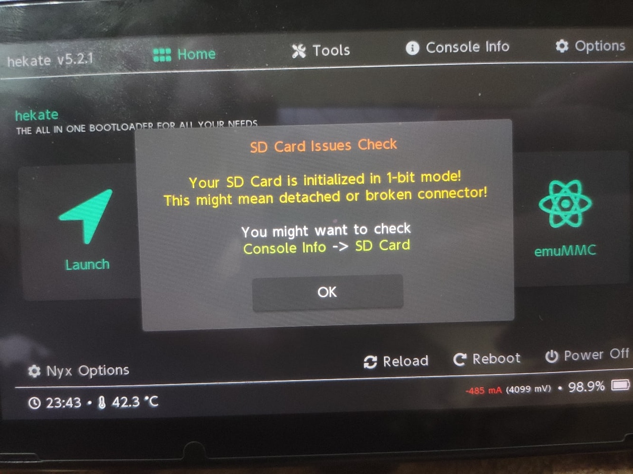

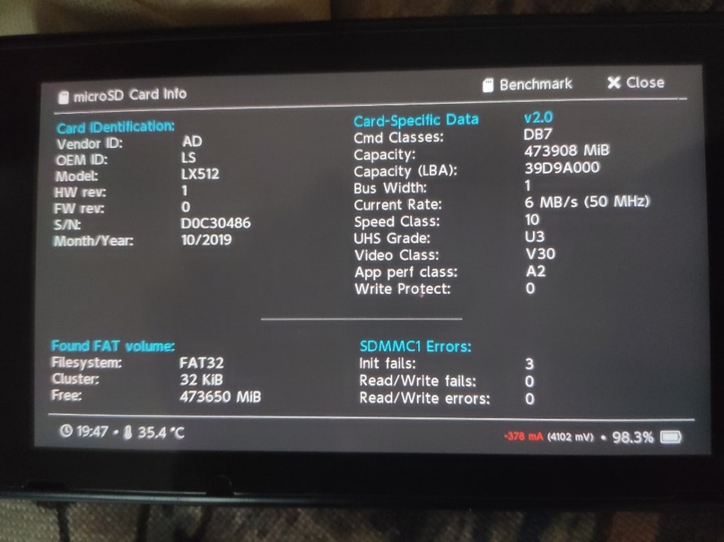

Once upon a time I changed SD Card and saw something new...
Tried to full format (into FAT 32) with Rufus and then check sd with h2testw (it shows no problems with card). But it did not help. Other sd cards works fine. Problem only with this one (Lexar 512 GB). It works normaly before, problem appeared litteraly from nothing. Can't get what's wrong.

I would check the write speed of that card, 1bit mode should be rather slow (sooner/later as the RAM gets filled up). If its slower than your other cards, the card is defective.

Before that problem everything was normal, but now games loads three times slower on that sd.
There is no way to fix it? I using that sd almost few months

I would check the write speed in a card reader on a PC.
1bit mode sounds like there isn't a connection at DAT1 + 2, could be a hardware damage in the card, idk.
I have been through this - use clean function of diskpart in cmd and then rebuild the MBR by reformatting the card to FAT32 (MBR) with the free version of easeUS Partition, or similar software. This should work if your card has logic problems, otherwise that might be a hardware issue.
