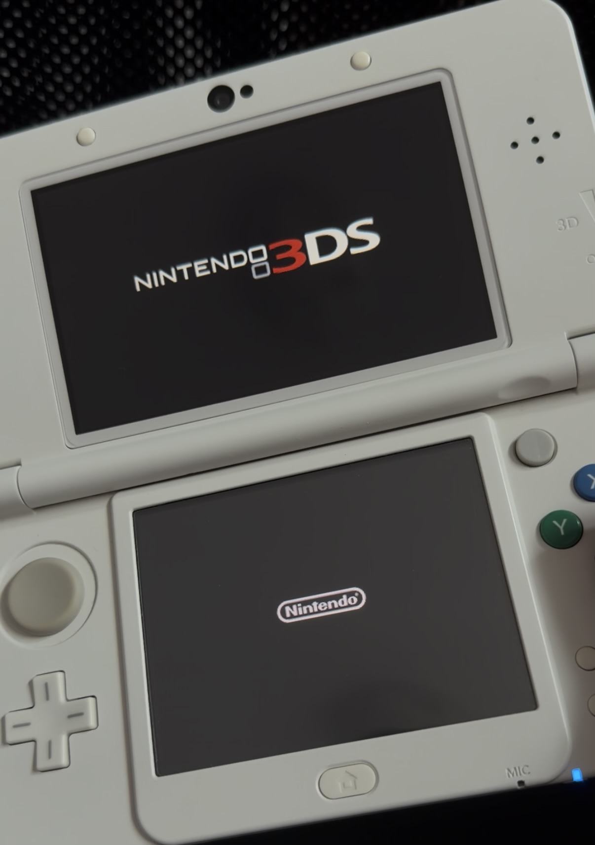

This happens when there's a crash, the loop goes on until a button is pressed to shut it down:
