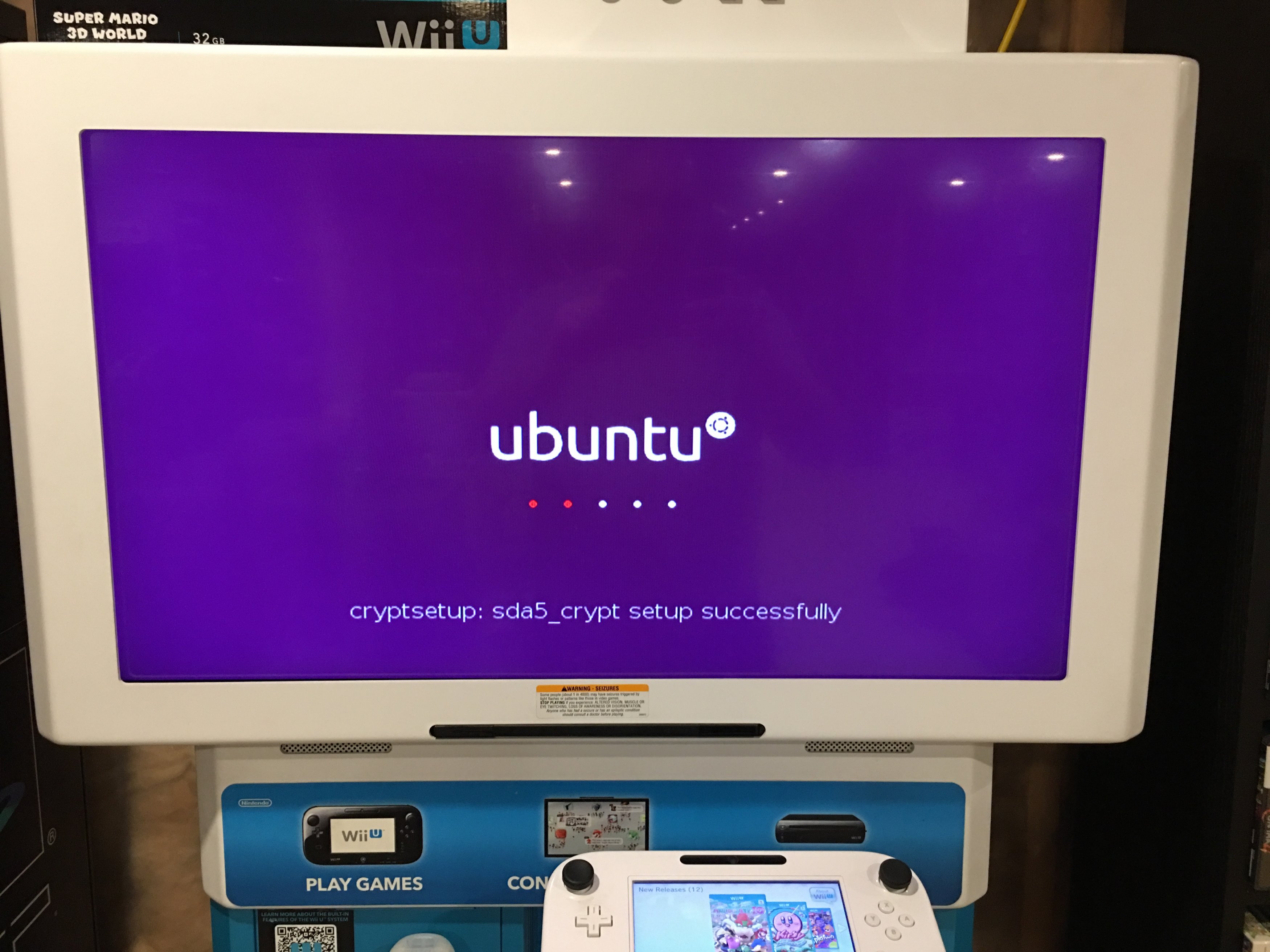

So a buddy just mentioned trying to make sure all the cords from the console were connected, I didnt have the ethernet cord plugged in every time I've tried previously. I dont know if I had just put the usb in a different spot this time, but when I turned it on, it went to the Ubuntu screen, checked the hard drive for errors, it's never done that before, then proceeded to log in. The console might be the usb key? The demos still dont work, but when I swap inputs on the TV from the console to the silver box, it now displays this screen and nothing else happens. I'll have to mess with this more tomorrow. Maybe there are other wires I've just missed buried in the back, there also a coaxial wire coming out the back of the console.
View attachment 168427 View attachment 168428 View attachment 168426
Note sda5_crypt - I'd put money on that drive being LUKS. It'll be interesting to see how that gets decrypted, considering the user never entered a key or anything.
Found a datasheet for that PC: http://cdn.viaembedded.com/eol_products/docs/amos-3002/datasheet/VIA_AMOS-3002_datasheet_v180518.pdf ( https://web.archive.org/web/2019052...datasheet/VIA_AMOS-3002_datasheet_v180518.pdf )
Looks like a bog-standard x86 rig - not very powerful, either. Wonder if that console is empty after all...
(edit: sorry yeah, that console is definitely doing something. I know other people with kiosk consoles too, and they aren't paperweights.)
There could be a disc in that console, if you can get to it I'd definitely try the eject button

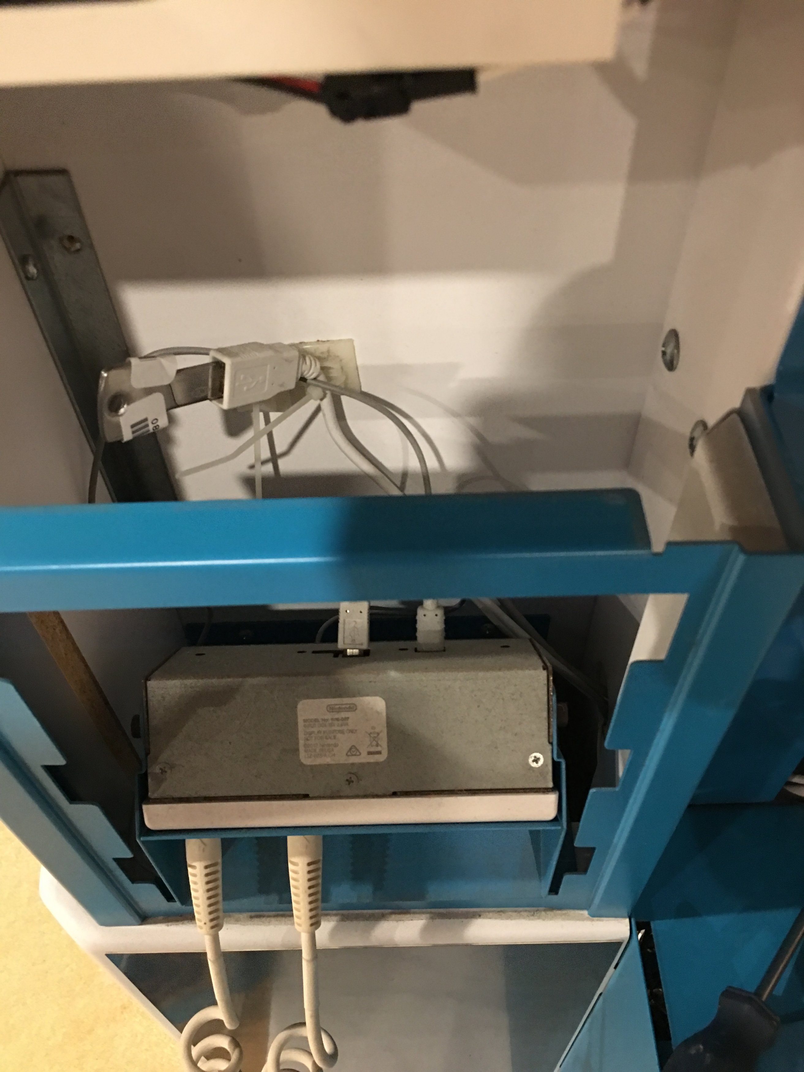

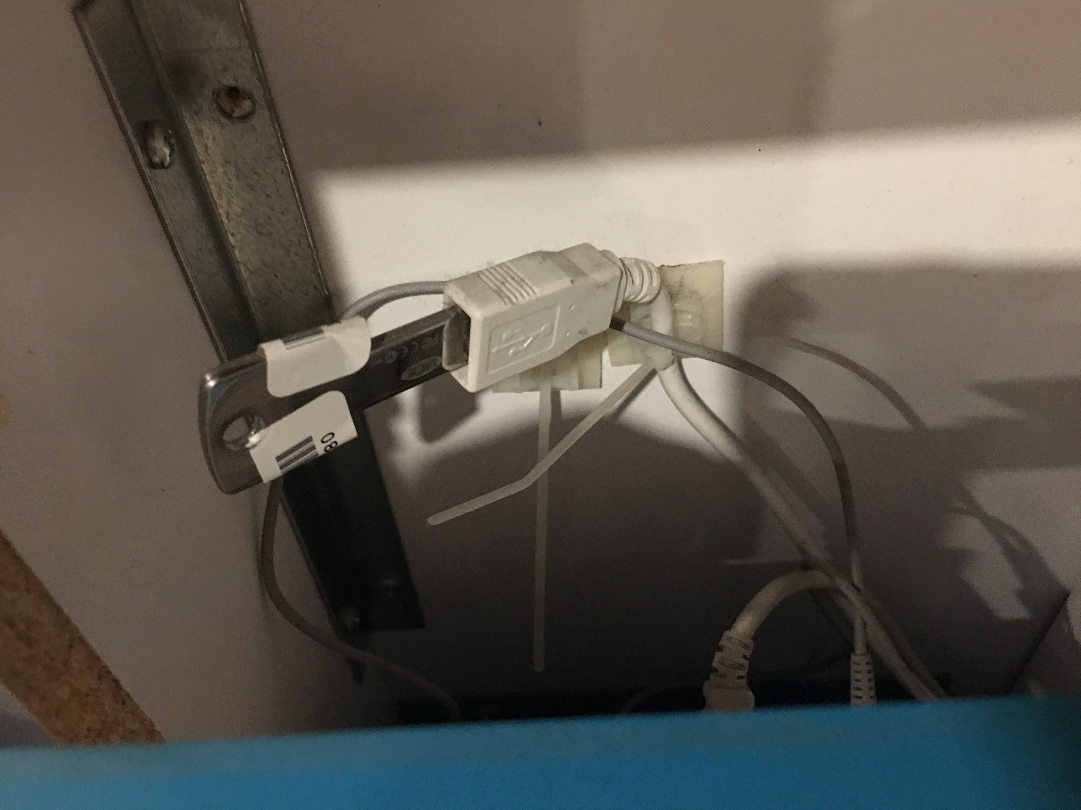

So I took the front of the TV bezel off and found this just hanging out...
So it wasn't the console unlocking the box, it was the actual key. Is this safe to put in my comp?
View attachment 168515 View attachment 168516 View attachment 168514View attachment 168513
That's probably where it's pulling the keys from for LUKS/FDE - you'll have to get the keys off at some point to decrypt that hard drive, though I'm not sure if plugging it into a regular PC is a good idea. Would be nice to find some more info on that first!
Looks like it's one of LaCiE's USB keys. While I can't find that exact one, the petitekey and iamakey look pretty similar - so it's almost certainly a normal USB drive. I'd also put a roughly 99% chance of it either being formatted for Linux or encrypted using the private/public software the manuals keep talking about. I'll have to defer to the Windows nerds on how you can image an entire drive (not just one partition) in a way that's not gonna modify the drive itself, but with any luck it'll have the keys to decrypt the PC's hard drive on it.

Well, the box seems standalone now. With the usb key plugged directly into the box, it unlocks and stays on the Wii U splash screen. There doesn't seem to be any link cable between the box and the console other than maybe the ethernet cable, but then how does the box connect to the internet if the ethenet cable was linked to the console. It would still be nice if there was a random Nintendo rep from 2012/2013 lurking around here that has used this lol.
