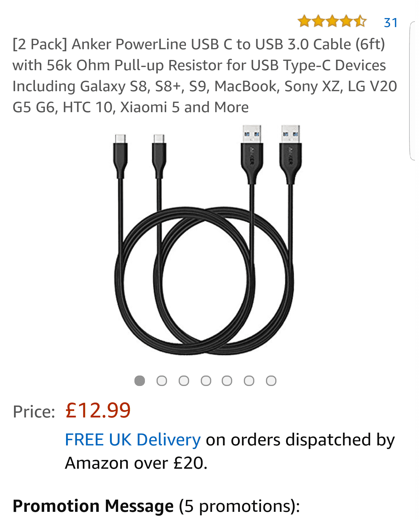

People who can't read are not welcome here. Posting an amazon screencap and waiting for your service request to be filled is not something we suggest users in here should do - or indeed help you with. Look for another poor Shmuck to do your bidding in another part of the internet.
We are not your Alexa. And tell that to your offspring as well (which will most likely grow up with Alexa).
Abusing people so you don't have to do any intellectual work doest scale. They only get angrier, the more you do it.
Buzz off.
Also yes, I know the most likely answer, yes it is a one word one. No I'm not giving it to you - because you can find one yourself. Or at least one, that solves your "issue" for the same price. With about 60 seconds of work.
There are thousands of cables out there. Going by brand doesnt work. Listing "the one you'd like to buy - because amazon suggested..." is dependency enabling, unfair to all other manuacturers, and more importantly - doesn't scale. We are not your personal shopping coach.
steplay29
Jun 10, 2009
92
belfast
Visit site
838

Smart ass,Amazon did not suggest it was actually a guy on the forums and was just double checking myself.dont get high and mighty over a question that was posted in the correct forum.
There are thousands of manufacturers. How do you expect "I was only double checking" would work with images of even lets say 20 of their products in this forum.
I will not accept "i was just double checking" as an excuse, for not trying to understand the criteria. Also as far as I'm concerned, "just double checking" can also be used to retroactively "cotton ball" not checking at all.
Oh by the way - is this a cable I should buy?
Or this?
I find it deeply disturbing that we are now doing image recognition services with attached information crawling for whatever the "top amazon products" in a certain category are. For randomns - that were just *screencap* doublechecking.
Thats crossing a line.
We are not your business buddys on hotdial.
We should have no interest in pampering selfrightous individuals with individualized service demands, and NO INTEREST in learning anything but "getting a product recommendation" - by shortcutting the "learn a thing" process.
Also - its not even that -not even a page before this one you have the links listed - but now its become "just double checking".
Think about what behavior you are enabling here.
Think about what it means, if your "recommendations - a la carte" are wrong. Do we now also offer recommendation corrections services a la cart?
It doesn't get more low effort than posting an amazon screengrab of a cable with "should I buy?" attached. Then add a quick lie about "only doublechecking".
Also - only 2 image recognition requests per person, right? A day? A week? How would you like to handle this.
And remember - if you give a wrong recommendation, based on any of the thousands of products that could be pulled - there are fewer people in here that would have to correct that. So - no, no "easy personalized" services in here.
And also no "just ignore him". This behavior is asocial and abusive. If you are double checking, reference the original post, and say so in your actual request. That way "minimal effort" to do something on your part - can be assured. Reactions might be different then.
-- Also, just out of interest, because this was a "verification" question. @hippy dave did you verify - that those cables would work? Or did you just post what aparently @steplay29 "already had seen" - posted it again, an thereby created a false premise of an independant verification? Also - if this was just a verification, based on the thing you already saw - @steplay29 - that would be ok, for you, right? Just to make the decision process (without knowing the actual criteria) a little bit more transparent.
Just kidding - I don't believe that the image post was a verification attempt. At all.

Are you trying to turn the whole forum against you? You are just being toxic now. Please stop picking fights and being rude to members.
Some people here have questions about the safety of their products they are looking to purchase. They have every right to ask questions.
