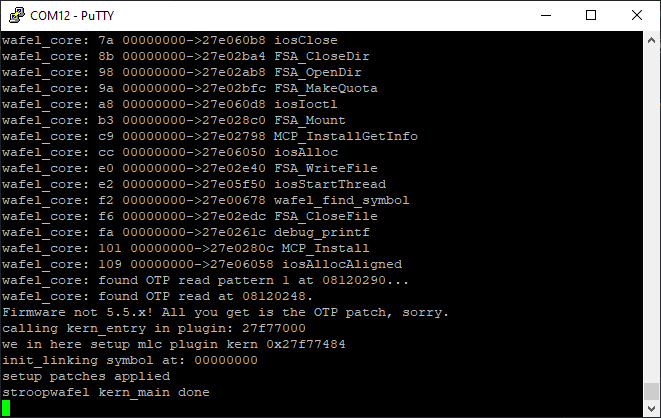

EDIT: Tried booting with OSv10 as stated in this post: https://gbatemp.net/threads/wii-u-blinking-blue-light-no-image.640588/post-10259653
Made some progress but got stuck at:
00:00:01:191: FSA fsa_core_ops.c(1511): failed to issue command to FS (-196640)
I attached the log file to this post.
EDIT 2:
Tried running wafel_destroy_mlc but got this error:
we in here MCP 0x5202008

00:00:00:628: SCFM:Start init. BUILD_TIME:[16:02:03]
00:00:00:633: SCFM:FSAInit
00:00:00:634: SCFM:AddClient
00:00:00:635: SCFM:scfmMountSlc
00:00:00:636: SCFM:scfmLoad
00:00:00:637: SCFM:Done init.
00:00:00:638: PCFS: Disabled because we are in PROD mode.
00:00:00:640: MCP: booting from NAND
00:00:00:641: MCP: Boot PM flags - PON_COLDBOOT
00:00:00:661: MCP: Cafe OS SDK Version 2.13.01 Build 69088 Branch sdk_2_13
00:00:00:663: MCP: Booting on Espresso (0x0000700100000201), Latte (0x25100028), RTC (0x01)
00:00:00:665: MCP: Platform - boardType(CF), boardRevision(11), devicePresence(0x00000000), sataDevice(3), consoleType(1)
00:00:00:670: ISFS: FAT block entries check start
00:00:00:672: ISFS: fs_ops.c(2215)FAT block entries check start
00:00:00:677: ISFS: FAT block entries check finished.
00:00:00:679: ISFS: fs_ops.c(2292)FAT block entries check finished.
00:00:00:692: FSA: [uptime 0.692 s]: Attached volume to mlc01 (raw): Capacity 5088 MB, 10420225 logical blocks of size 512 B.
00:00:00:698: FSA: [uptime 0.698 s]: Attached volume to ramdisk01 (raw): Capacity 125 MB, 129022 logical blocks of size 1024 B.
00:00:00:702: MCP: Formatting Device ramdisk to wfs
00:00:00:854: FSA: [uptime 0.854 s]: Attached volume to sdcard01 (fat): Capacity 60350 MB, 123596800 logical blocks of size 512 B.
00:00:00:862: FSA: [uptime 0.862 s]: Attached volume to ramdisk01 (wfs): Capacity 125 MB, 129022 logical blocks of size 1024 B.
00:00:00:866: MCP: Format Complete
00:00:00:875: MCP: Formatting Device mlc to wfs
00:00:01:078: FSA: [uptime 1.078 s]: Attached volume to mlc01 (wfs): Capacity 5088 MB, 10420225 logical blocks of size 512 B.
00:00:01:081: MCP: Format Complete
iosPanic(): MCP: failure in PM(788)...
EDIT 3: Good news! The Wii U is working again! I ran the setup plugin after running the destroy plugin (both with the OSv10 running through the 2nd option) and it installed all titles successfully! The Wii U booted up and is working just fine, even without defuse! It shut down and a red light started blinking, but I suppose it happened due to overheating because the Wii U was burning hot. I'll reassemble it and test everything again. Huge thanks for everything @SDIO
