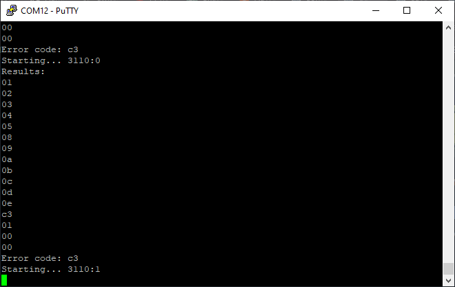

I wired the pico just like your diagram using the custom code for the different pins, except for 3.3V and GND, but defuse doesn't seem to be working. I checked all pico connections with a multimeter and everything seems fine.
This is what I get from the serial communication:
I'm using a 1gb sd card for this, wrote boot1.img to it and formatted as FAT32 using the default windows formatter.
You need to connect the GND of the Pico with the GND from the Wii U

OK as expected the eMMC is failing.
These errors are from just one log

So I would suggest replacing the eMMC. If you don't want to source a eMMC and do BGA soldering you can get a NAND-AID (you can ask @V10lator for one, but shipping the letter from germany can take a while) and then rebuild the MLC on a 64GB SD card in the NAND-AID: https://gbatemp.net/threads/how-to-upgrading-rebuilding-wii-u-internal-memory-mlc.636309/
Instead of buying a NAND-AID you could also just use a micro SD adapter and solder wires from the pads on the MB to the contacts of the adapter.
Without soldering there is also redNAND: https://gbatemp.net/threads/fixing-...-soldering-using-rednand-with-isfshax.642268/ (you can launch minute from defuse, so you don't need ISFShax for now).
But since you have already disassembled the console and soldered the pico, you probably want to go for the proper fix by replacing the eMMC internally
Luckily I already ordered some NAND-AIDs from V10lator expecting that the emmc would be dead. Can I remove the Pico after doing the linked tutorial for rebuilding the NAND on a micro SD card?

There is something strange about your slc as both the first extractor and the check had problems with it. But since your Wii U boots into the Factory Reset screen and the other extractor worked, I assume it's a problem with the tools and not your SLC
Oh by the way, the Wii U stuck in the factory reset screen is another one. This one we're talking about just stays stuck on a black screen.

What is the power LED doing when booted without defuse? (you can just remove the USB from the pico, since you didn't connect 3V3 it will then just boot without defuse)
And yes, after the rebuild it will work without defuse, as long you don't use the unlimit plugin.
The LED stays solid blue without defuse.
Great, I have some spare 64gb SD cards here. The only problem is that apparently the Wii U firmware is 1.1gb and I don't think I have a 2GB card. Can I swap it for an SDHC card in the front slot after defuse has booted up?
