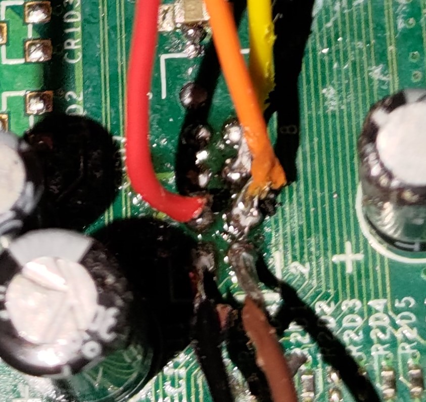

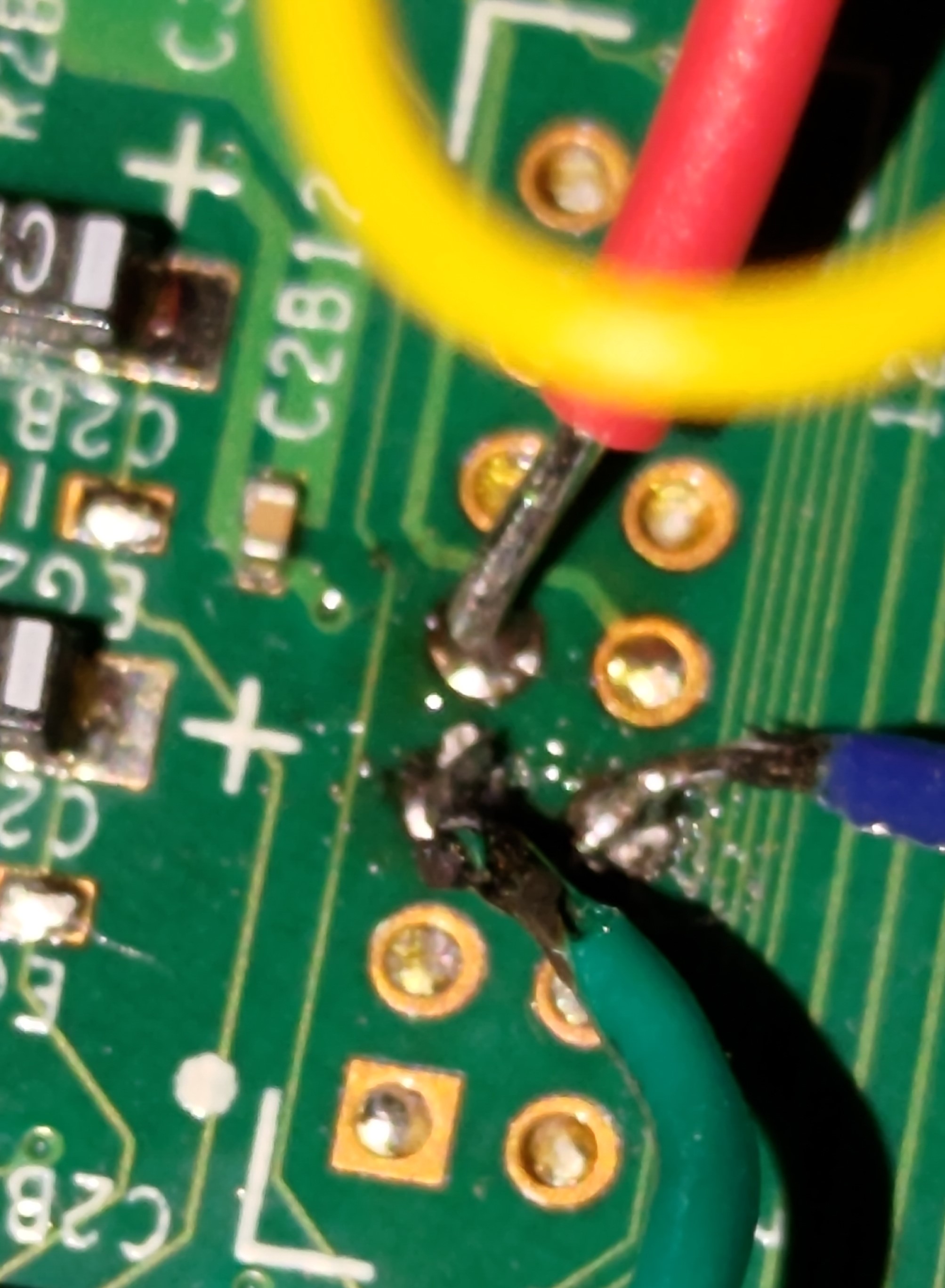

and i didnt share photo because i wasnt near the xbox
so here you go

so here you go View attachment 409760View attachment 409761
That soldering really isn't the best. Some of those wires look like they are barely holding on. Especially the Red
I've always had a bit of trouble with ground(black) personally so if you are as well and would like an easier approach and one less small point. You can "cheat" the ground wire and solder it directly to the AV or HDMI port. I usually just tack it onto one of the bits hanging off of the AV port like the old RGH chips
thanks for the info
yeah its my first time
