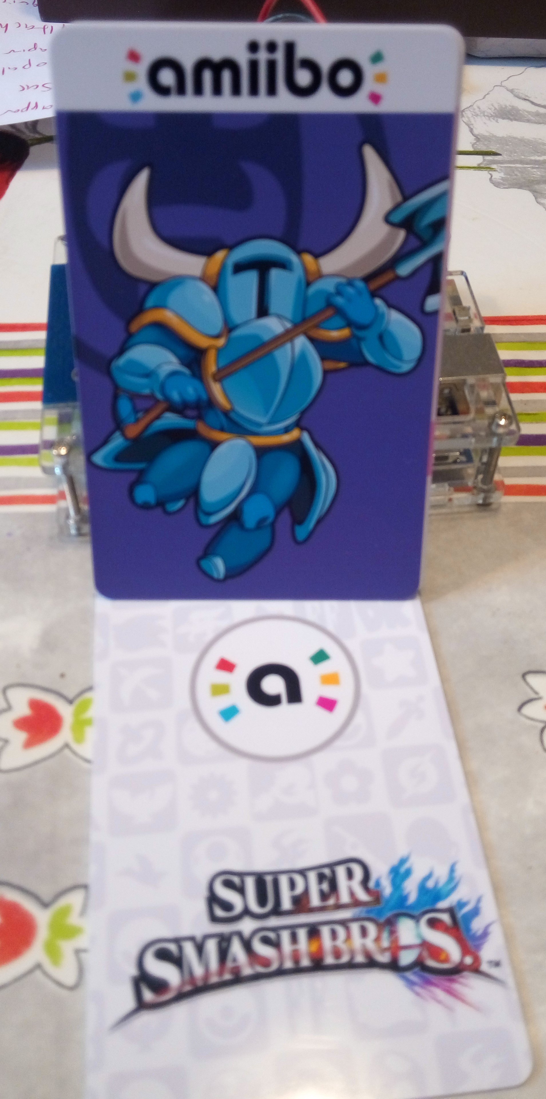

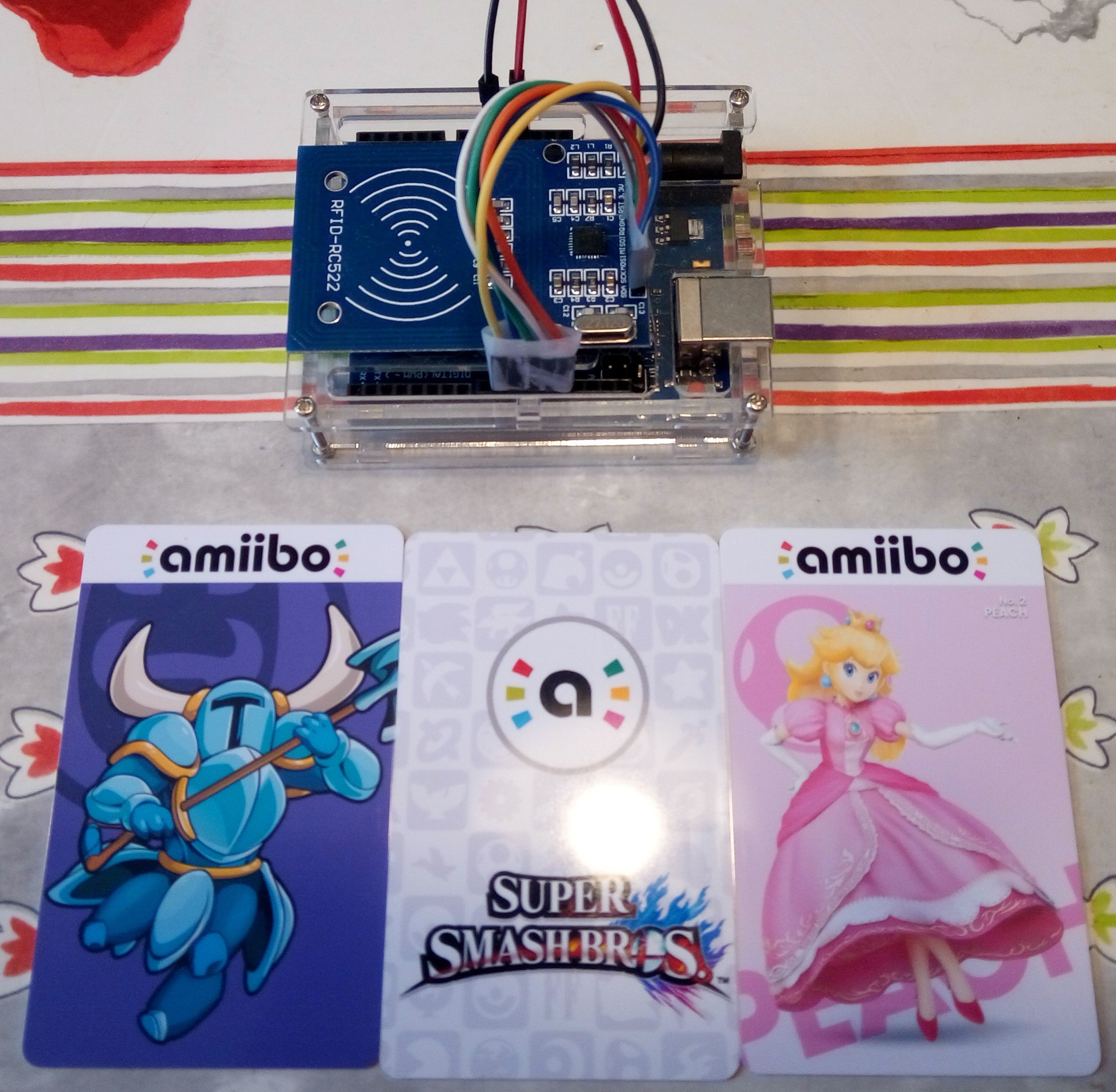

Hello,
Just to say everything is working, on the round tags and on my inkjet printable pvc cards:
