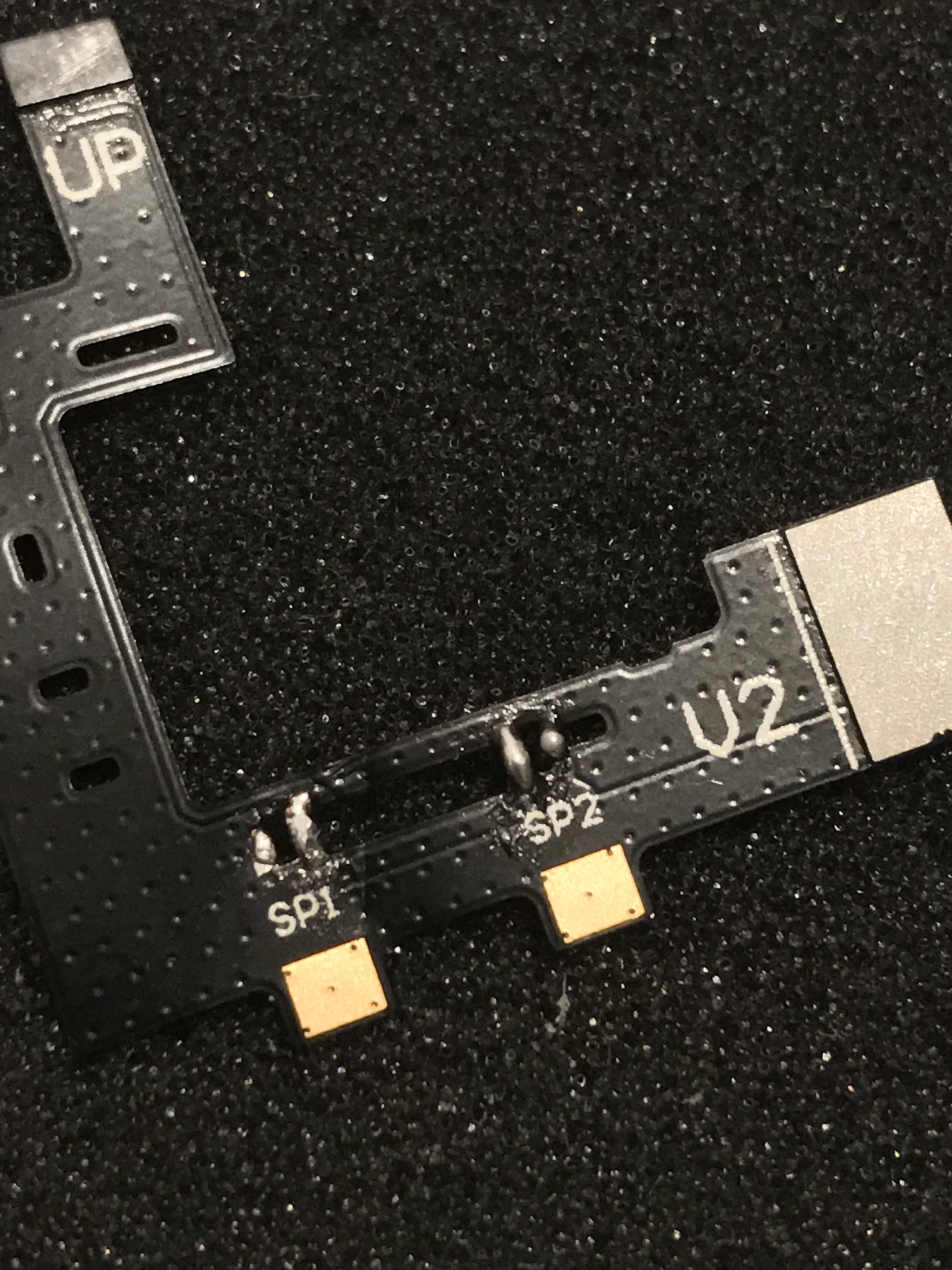

Tried my best to pretin the V2 while i wait for my v2 switch. Hope i didn’t broke it though. I had to redo the SP1 because I’m stupid. I bridges both pads so I had to use some solder wick to redo them. I honestly thought it melted. Did I do alright?
To much solder on sp2 , i think you will have difficulties when you will try to align , buy some solder wick ,use the right amount of flux and remove the excess solder if is the case.

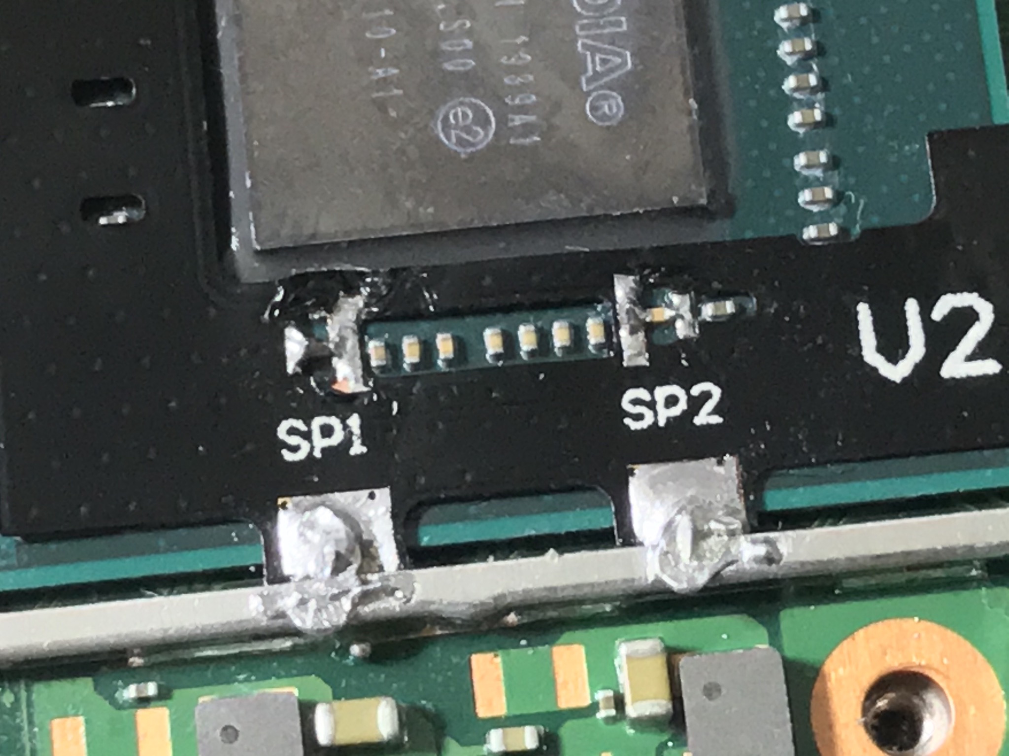

For some reason. I installed sx core v2, it seems fine. It booted and updated the sx core but it turned off suddenly. Now it’s just stuck in green led. Can anyone help me?

I tried to redo the soldering. Now it’s just stuck on bluescreen lol. Anyone knows what’s the problem?

Mine is bluescreen. not blue led. The led is just green, and the screen is BsoD.
@ModderFokker619 will you be able to fix this?

oof thats actual damage to the console
What could it be? Can solder splashes do this kind of damage? I saw something in the mico sd card board that looks like a solder splash. Haven't tried removing because I'm afraid to damage it more.
Could be many different things https://switchbrew.org/wiki/Panic_codes
Things to check, traces that run to the charge chip, charge port, game card reader, wifi chip and check the video lcd ribbon cable and connector.
Is It instant blue screen or Nintendo logo and then blue screen? If it's unfixable without having to use a donor board there's still hope as I sent in two switch lites under warranty to Ninty both with evidence they had been opened/soldered on and one of them has already been replaced with a refurbished unit which will be here Monday.
Instant. I'm trying to get a return/refund as we speak but the thing is this was purchased as a gift from amazon.ae(where I am right now).

Hi Akira,
Judging from your pic, you shorted the left side cap. Your solder runs over the top of the cap and connects both sides.
