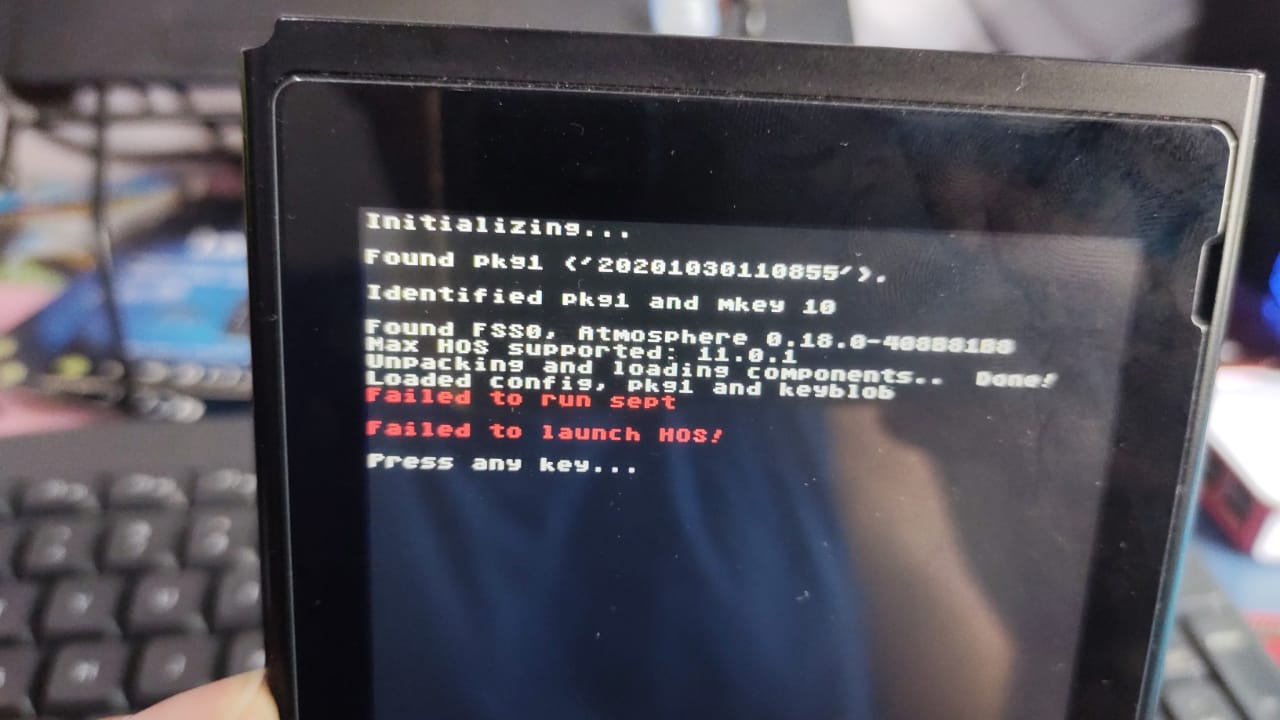

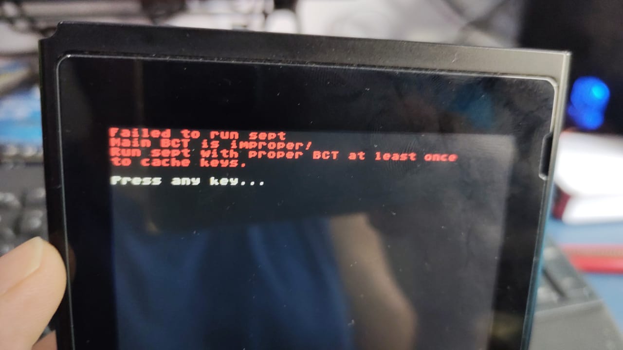

Hello,
I just came across this console XAW1010 jailbroken with SX Core. The console is at 11.0.1 and I'm trying to run Atm but I'm getting this message stating the "main BCT is improper".
87da9c9a-ce22-400f-86a0-987d6f0acd70.jpg 80f2bda4-f3f4-47a1-a042-dc20606f8cf7.jpg
If I switch to SXOS boot.dat and do a cleanup and genuine boot it boots fine.
I understand there is a new check in Hekate 5.5.4 that catches this error and presents a message (the one above) but I'd like to understand what it is.
Can I have some insight?
And most importantly, can it be resolved?
Thanks!

I googles a bit and found out the BCT is the boot configuration table.
I also found out the briccmii payload bricks (and attempts do unbrick) the first byte of every BCT's pubkey in BOOT0.
I was wondering it there is any way to try and uncorrupt this BCT table.
Maybe a "donor" BOOT0?
Thanks!

I asked the TX support on discord the problem was fixed just by going through the SXOS options > Then Click SX Core and do a Cleanup > Go to Payload.bin > Then Launch the Atmosphere CFW. That seems fixed the BCT improper problem.
amazing. that simple. after the cleanup it works like a charm! got the keys with lockpick and can start atmosphere. downgraded emunand to 11.0.0, got my SX OS license today (website was working today, phew!!) and can finally enjoy the magic =)
THANKS BRO :yayswitch:
PS it works with my original BOOT0 and BOOT1 so @fjay69 probably those files are not required, but thanks anyway for your support!
Well, this actually worked for me... Not on the first time, though.
One of the times I performed the cleanup and ran Hekate through the Payload menu (using autostart to automatically boot atmosphere), Lockpick ran (yeah! automatically, I think, because I didn't boot this payload) and it dumped the keys and asked me to press a button to shutdown.
After I turned the console back on it worked flawlessly!
So, try running this:
Cleanup, Payload Menu, Lockpick payload, dump keys from sysNAND, shutdown, turn on again, cleanup, Payload Menu, Hekate payload, boot into Atmosphere (sysNAND), shutdown and try booting Atmosphere (emuNAND)!
Best of luck!
EDIT: After some "occurrences" of this issue I managed to fix it by just doing the "second" part. So try starting directly from the second "cleanup" (in bold) forward...
