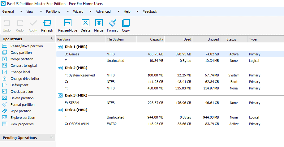

@d0k3, formatted my 128 GB mSD to Fat32 32kb cluster size. Used latest Emunand9 to format (full setup). After full setup in which sysNAND was cloned to emuNAND, I injected my emuNAND backup. There is now a 1.84 GB unformatted partition and a 117 GB partition on mSD. Is this normal? On an O3DS the same thing but unallocated partition size is 944 MB.
The new 3ds has a different nand chip, either 1,2 or 1,8. I believe it was common sense.
So this is normal? Disk 4 with 944 MB of unallocated space. Shouldn't it all just be one big partition and not 2 partitions?
the unallocated space is where your EmuNAND/RedNAND is. If you do not have an EmuNAND/RedNAND anymore, you can resize the FAT32 Partition to fill the whole SD Card again.
What he said. emuNAND doesn't exist on thin air. It's a partition in your SDcard... This is the unallocated space.
My bad, I usually only use windows to view mSD/SD and windows doesn't show the partition so when I opened EaseUS Partition Master 10.8 that was the first time noticing the partition. I always assumed is was part of the main partition that was just called by CFW/Gateway.
You couldn't have assumed that because every time you create an emuNAND, the maximum size of your SDcard decreases. So it's logical that there is an unallocated space. It's common sense even for people that know little about such stuff.
