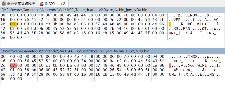

I verified Euro and JPN GamePAD firmware from drc_fw.bin extract files. Only two files different: ERR_.bin and INDX.bin.
Indx.bin only one bit different: Japan is 0, Euro is 2, like WiiU console system. (nor sure, just think about it).
The region is read from the EEPROM not from the firmware. To change the region you would need to write to the EEPROM which might mess with other things.
