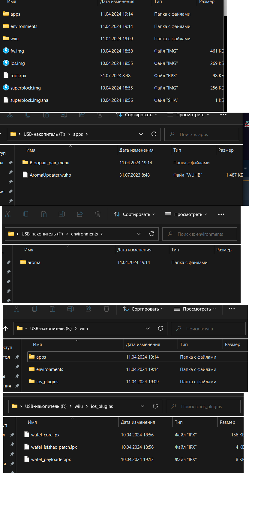

i tried rebuilding my MLC with SLC files again. is it normal for the led to blink blue (not red or orange) for more than 30 minutes. is it normal for mlc replacement or isfs just not recognizing the problem and not showing errors or my NAND chip was broken idk xd
btw it does not shows the logs

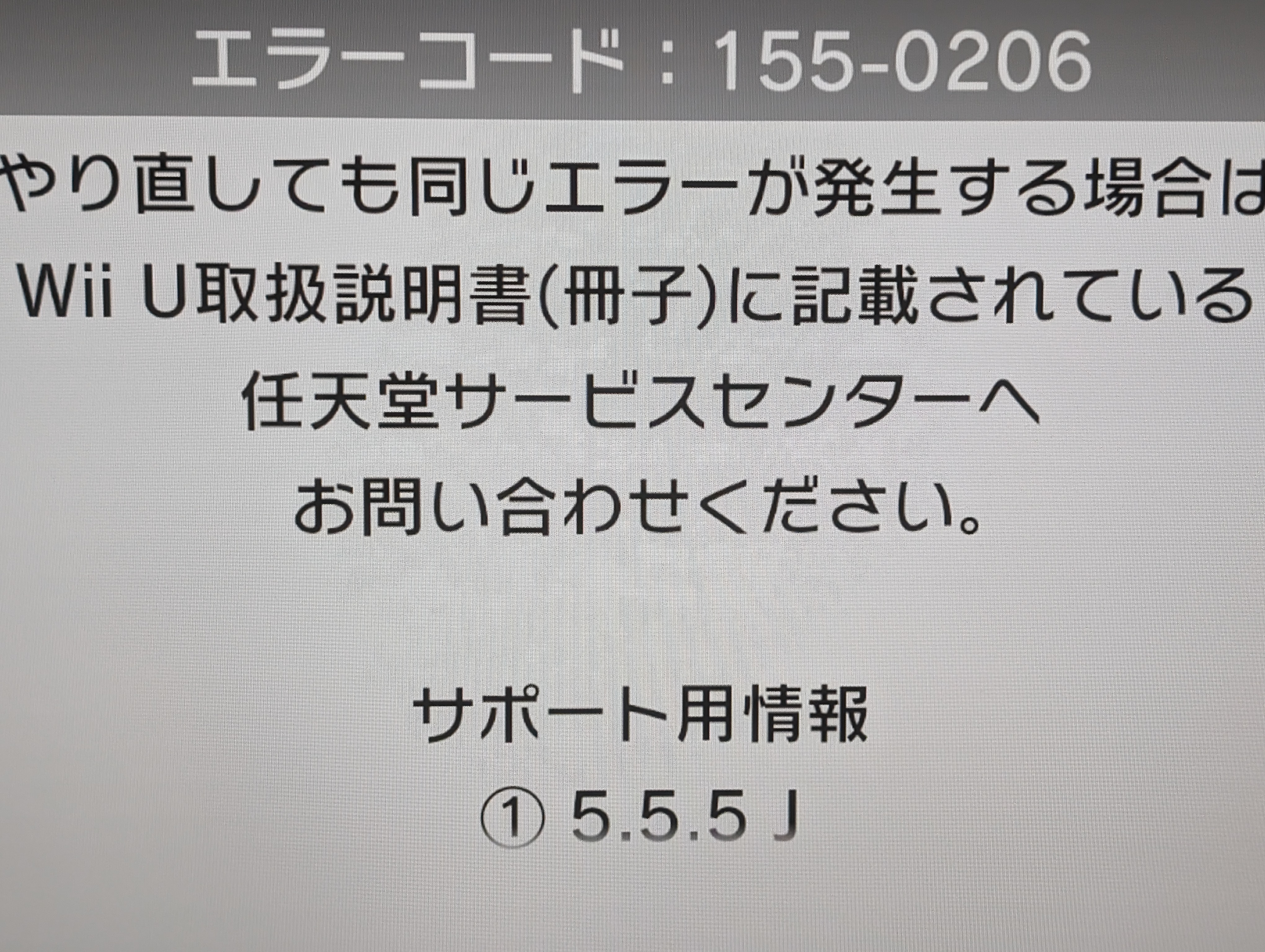

Hi,
I'm trying to change my European Wii U to a Japanese version, but the problem is that it crashes when I try to create a mii (in the initial console setup) and I can't skip this step unfortunately...
do I need to also install the SLC applications? (I still have the SLC European apps)
(Btw, when I restart the console, I get an error and I have to completely install the MLC again (because otherwise I am stuck permanently on error 155-0206)

seems like I was missing your last post. It shouldn't take that long. Please show the setup log.
You can also dump the system crash logs in Backup and restore. Maybe they show something helpful.
No, the SLC titles are the same for all regions. Can you show the setup log? Maybe something failed to install.

sorry bro, the setup log file was not created on the sd, but i did create a system crash log. bro sorry, i am not very knowledgeable about programming, and low architecture programming in general, but can you tell me if i might have corrupted NAND memory after all and will have to do NAND aid?
here is the logs zip file

if it starts blinking blue it should have already created a wafel_setup_mlc.log on the SD. Else make sure the SD isn't write locked.
Hm your logs are just filled with this
334: FSA fsa_core_ops.c(1511): failed to issue command to FS (-196640)
00:00:47:339: FSA fsa_core_ops.c(1511): failed to issue command to FS (-196640)
Beause that is spammed so much, everything else was evicted from the log. Maybe you could try to run it just short, so we see what happens before in the log.
The error means "UnsupportedCmd"
Oh okay...
I deleted the old MLC download and completely re-downloaded everything... but unfortunately I'm having the same problem... here are the logs:
bro, no, i can put the files on sd so my sd is not locked, but wafel_setup_mlc.log is not created on sd. also I read that you created a plugin wafel_destroy_mlc. should i use it and maybe it will help me?

That is your problem. Look at the Manually fixing the sys_prod section in the guide, that should solve your problem.
my sd is not locked
Sometimes the Wii U detects SDs as write locked, even if they are not. Then it helps to tape over the WP switch.
No, that never really worked and is not needed anymore. Earsing the MLC and deleting the scfm.img in minute is now the reliable way to do it.
ok thanks ill try then

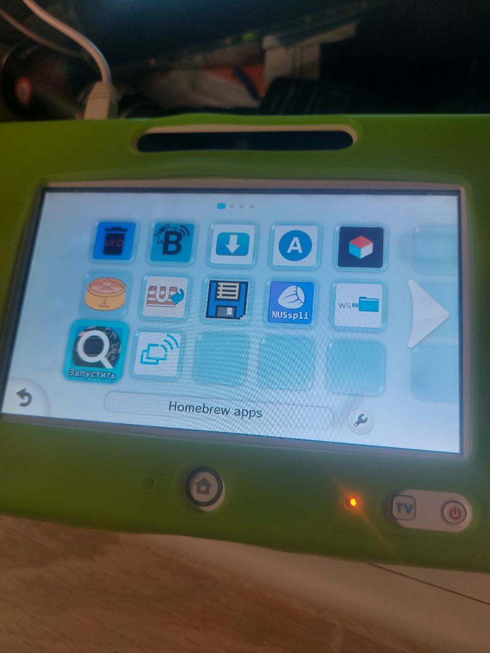

also i pick up the gamepad error. it also shows me with loaded payloader and aroma file

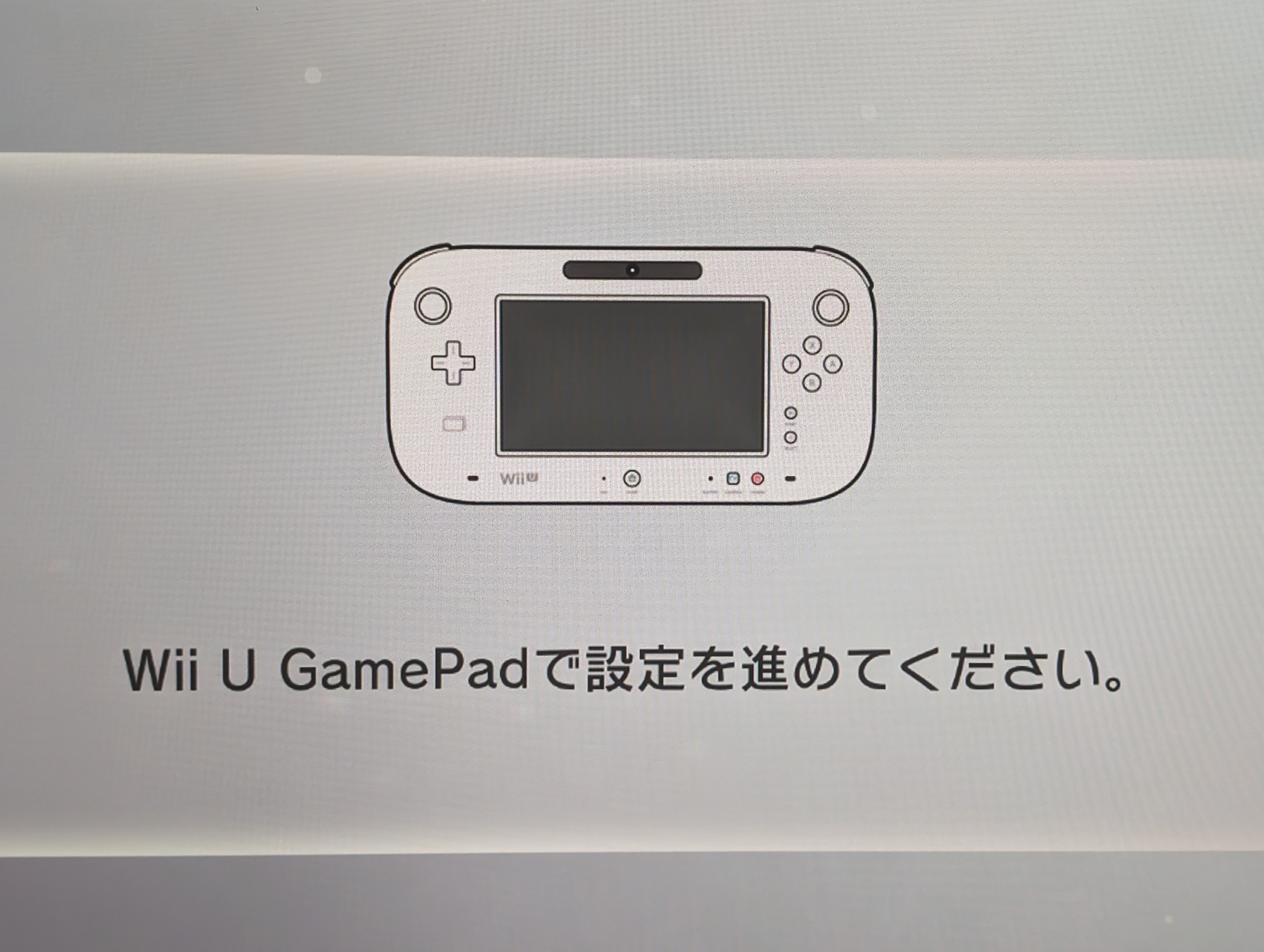

when I selected "Patch (sd) and boot IOS (slc)" the power led started blinking yellow instead of blue. its been doing that for 15 minutes now. what should I do?
Edit: the light is solid yellow now, but the screen is the same.
Edit2: thought the mlc titles were corrupted and backed out to try redownloading them, retried and now it stalled with a solid yellow light on the loading "wii u menu" screen
