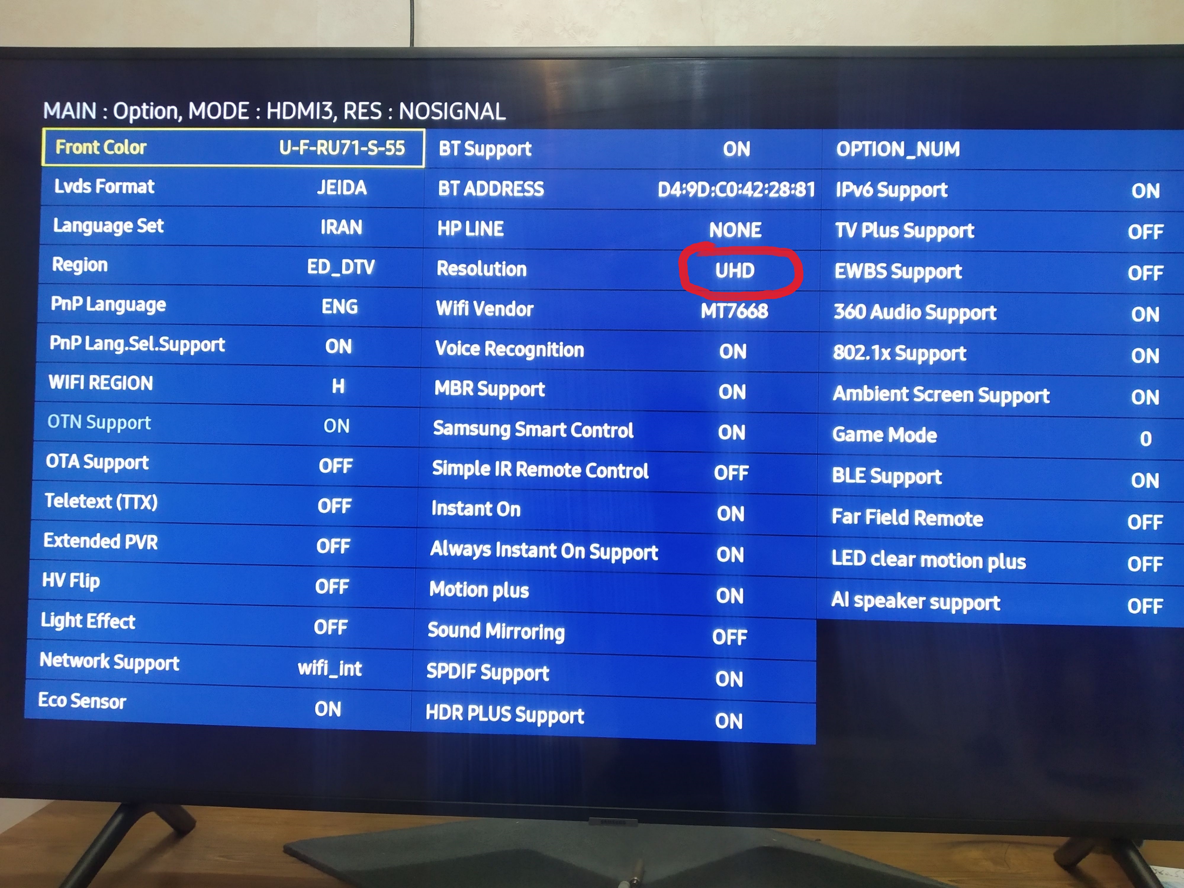

How do I do that? I want to limit it to 1080p, but I don't see any option for that.
you need to go into service menu then options:
t-dome
Apr 22, 2022
7
74
Here
32
Angola
Thanks, didn't see that. I changed it down to HD, but it doesn't work. My devices are still recognizing and outputting 4k. Next week I will buy a HDMI 1.3 cable, that was the lowest spec cable that I could find here.
can i ask you what are you trying to do? and yes not all options works on every model some options in servicemenu are like duds

I'm trying this:
Tried with HD and FHD, doesn't have any effect at all. I reverted it to UHD and I'll leave it like this until I get that cable.

i ment it more in a general way why do you want to cap your resolution at 1080p
I have a Steam Deck, and in game mode it always sets the maximum resolution that the hub/cable/TV support. Even if the games are set to the same 800p internal resolution and the Steam Deck upscales to whatever the TV displays, they are 10% slower in 4k than if the TV would be set to 1080p.
There are workarounds on the Deck to lower the resolution, but they have other downsides. I have also tried it on a 1080p TV and it's perfect like that, just that TV is small and in another room.
damn to bad i can´t help you but atleast thats good to know for me later im still waiting on my deck

I am sure they will fix it, the menus are totally wrong in 4k so it's obvious. They just have to add an option to change the resolution in game mode to 1080p (in desktop mode you can change it but there you don't have GameScope then). But I just found a workaround 10 minutes ago even for this. Put it into sleep mode, wake it up and then the menus are displayed correctly.
But now still the problem remains about 10% performance loss in 4k.

Something I noticed: after entering the service menu and "changing" the resolution, my sound and picture settings were reset. I'm sure I didn't change anything else in the service menu.

i experienced that myself a lot even without changing something in servicemenu like for instance my picture settings resets themselfs every other day or two (without internet they last a bit longer) my guess something tripped samsung watchdog (samsung dont like enduser tinkering with servicemenu i heard on 2019 + models its even a bigger problem)
Do you know what the game mode setting does? I notice yours is 0, but mine is 2...
Also the latest fw for my model screwed up ARC, TV does recognize the sound bar support ARC but states it's not on the correct port but it is!! There's a comment said there's an option to turn the hdmi off then on again which might help. I browsed awhile but didn't found an option for that.

I'm also interested in this, I have a QE65Q60A (2021 QLED) and my PS5 in game mode have some issues with 4k, there is a bit of a ghost and no Motion Plus or other settings seems to fix it (also the settings that should make the game run smooth, the 0-10 slider inside Motion Plus, doesn't do anything on PS5, but on Switch actually works).

IMO, I would only use Game mode for VRR. Unfortunately I have neither PS5 / switch, so I can't comment. But ghosting does sound like a refresh rate issue.
