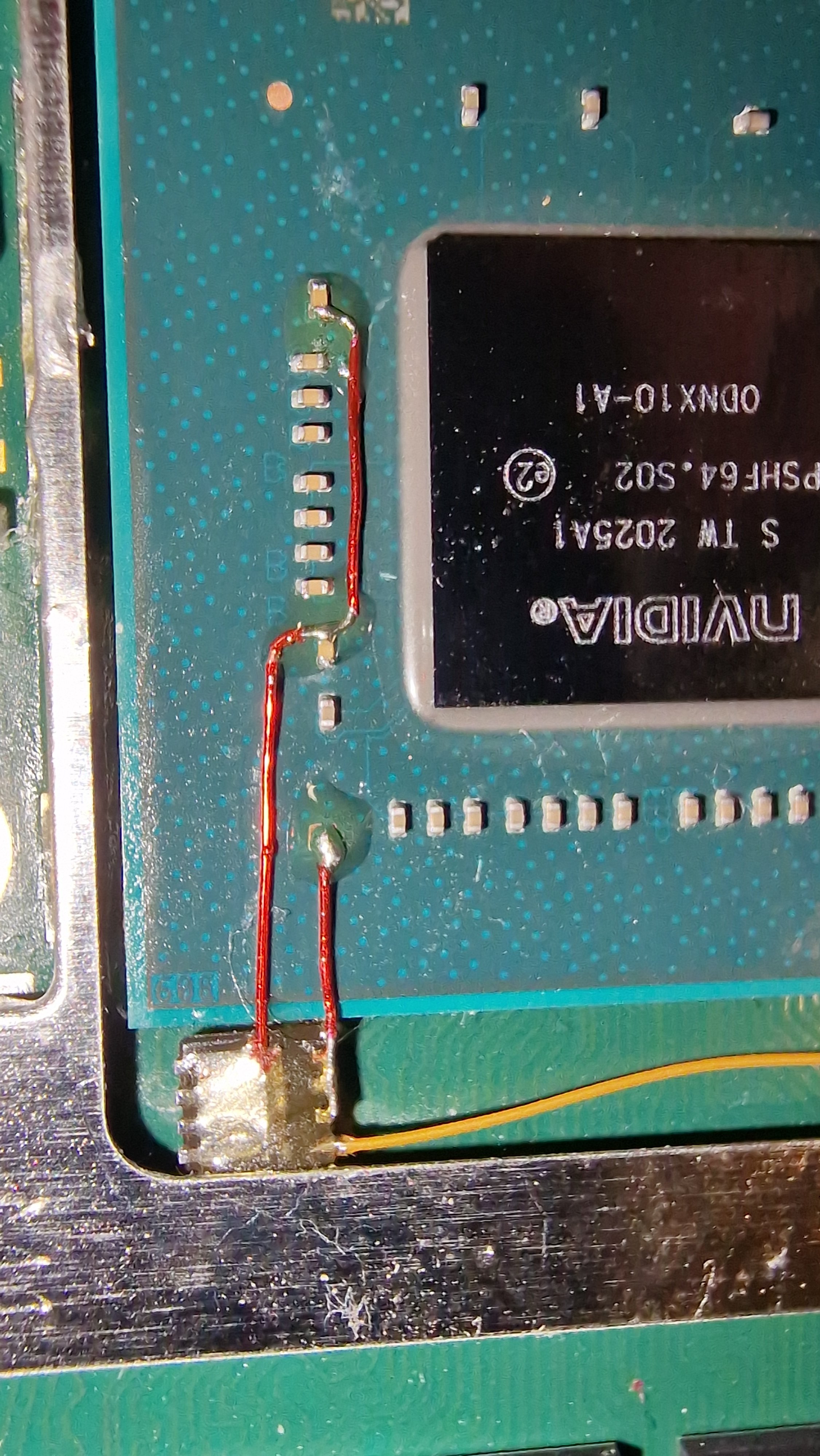

You guys said that for mosfets i need thicker wire right? How much thicker we talking?
Welp, I use 36awg (.127mm) wire to run from my mosfets to the caps on the APU, and try to keep the runs short by keeping the mosfets close to the APU die. Then the CPU pin that comes from the rp2040 to the mosfet can be 40awg (.08mm) since it's basically just a signal voltage to the mosfet.

wait ur using a single mosfet on horizontal caps? isnt 2 necesary?
2 mosfets are not required. There seem to be cases where 1 is not enough but I still did not have a case like that, i've done all my installs like this: single mosfet, single wire on both caps, ground to apu point.
good to know. what mosfet are you using? it doesnt seem to be the IRFHS8342, so im just curious.
