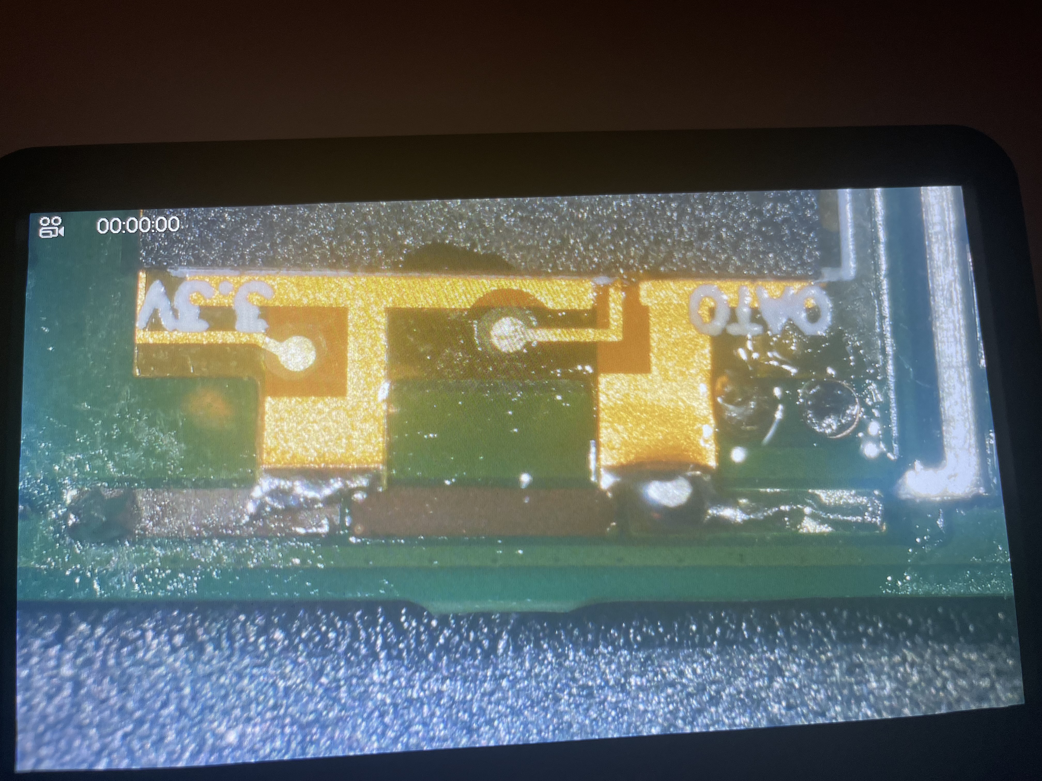

got a pretty fucked up dat 0 adapter, as you can see, it does not match up at all but my multimeter is giving out the correct readings, do you guys think i can proceed with this one? Or do you think my chances of bricking my console are too high to risk it. (Just tested it with a known good one and it gave me 526, went and tested it with the fucked up misaligned one and it gave me 526 too. Do you think its in the correct place?

I have the same ones... so it could / should work, but i would recommend to cut the dat0 adapter that it fits better.
These 3 anchor adapters are not the best but after cutting they should also work.
Even if it is shorted it will give the right diode value.
If I were you I would not use it but if you have to use it try to modify it as abal1000x did in the other thread
