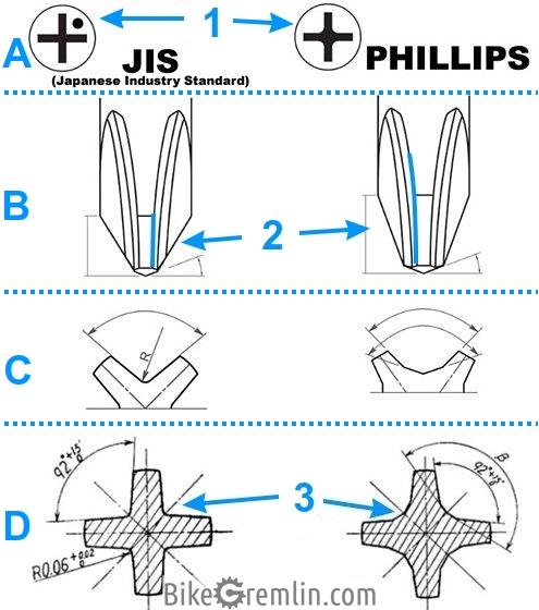

some oleds' silver screws are getting stripped. Seemingly some units have very tight screws. Anybody experience this? how to avoid screws in the metal plate and motherboard getting stripped?
Just need to use perfect fit screwdriver not just some cheap one that "fits ok"
Try something like this (I know it's expensive but they last a lifetime)

They use Japanese standard of philips screws so if you wanna be 100% you need to use a JIS screwdriver (it should be 2mm but not sure of the size)

I wouldn't recommend this kit. The screws inside the switch are JIS-type as noted below. The PH screwdrivers in this kit could potentially strip the screws.
The size is JIS 000 as noted in this iFixit guide. I have the iFixit screwdriver set that includes JIS-type ends and they work really well. But you can also buy a JIS-only set for less money if JIS is the only type you are missing. They aren't easy to find though.
