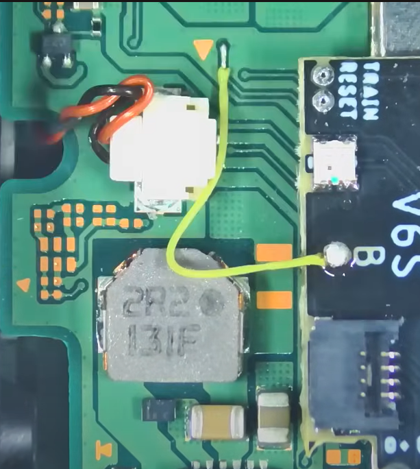

it should be a great solution .Any idea on the final price for each ?
Could be around 7usd each for the chip once they are batched manufactured. Could be cheaper also. Once I receive my samples from jlcpcb i will post some progress here and the pros/cons.
Im also planning to implemet the mosfet in the board itself so no need for the flex cable, just a single 40awg wire on sp1/2

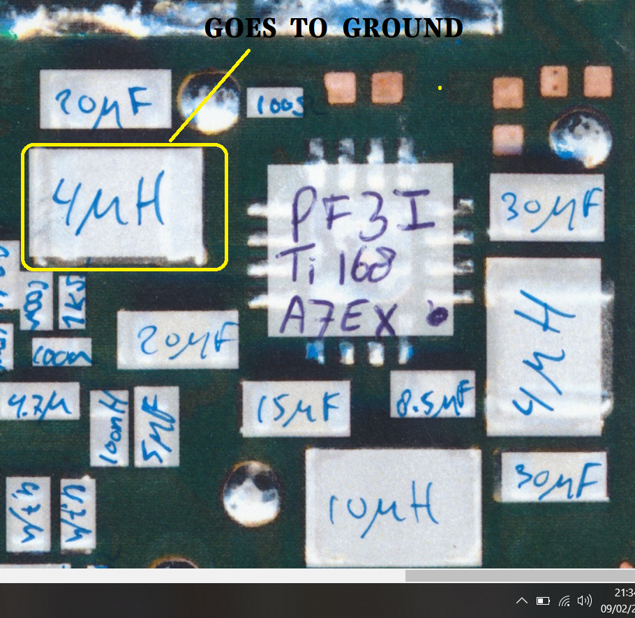

a 4MH ceramic inductor\capacitor. Test it putting the red probe off you multimeter on one edge of the capacitor and the black probe on the other edge (in diode mode\continuity mode) and see if it´s bridged to ground. If it is, most probably is broken.
It is inductor in value of 4µH(micro Henry) NOT MEGA HENRY nor mini Henry.
FYI, DMM testing inductor in most case could only test continuity and it should beep. However, for the OLED LCD drive chip, top left inductor is designed to goes ground,therefore if you measure resistance from ground to that inductor it is normal having beep as well.
(Proper measurement of inductor need high end LCR meter.)

I don't know how to carry out this measurement, I ask you to explain to me in detail how and in which points (even with a drawing) I have to use my multimeter.
Now that I know what the "ceramic capacitor" is, I found it on Aliexpress, but which one is the right one?
Another thing, I encouraged myself and tried to turn the switch back on even though it was damaged but I couldn't see anything on the screen at all. I know she's alive because the chip glitches. The screen remains totally black. I don't want there to be anything near this chip that has to do with the screen power supply perhaps?
this one
KAMIKAZE METHOD?
The component you are refering to is a SMD inductor most likely 0805.
You can get it here: https://a.aliexpress.com/_Ez2Yqip

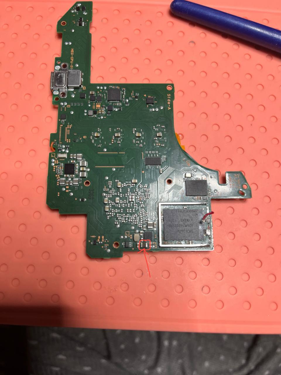

This motherboard was successfully modified by me, but at some point, after a few hours of gaming, the touchscreen and right joycon stopped working.
So I disassembled the motherboard and when reassembling it something made contact (I put the metal protection back on the nand and it moved to that area making contact) and this chip in the image made white smoke. I think it doesn't work anymore.
Is there a way to see if this chip is still alive?
Anyway....This little chip What is it? I'm looking for it on aliexpress
A series of unfortunate eventsView attachment 419003

It's a nice idea, but wire length seems to matter a lot for the mosfet so I'm not sure it will work as well as one could hope
Thanks for the insight, i will try to make a couple of test boards once the chip comes on my old v2 switches and see the glitching performance. 🙏

This look to me like a great ideia. Having the Mosfet on-board will make it quite simple.
I'm curious to know if the length of the cable from the sp2 point to the MOSFET drain being longer influences the glitch time. On the other hand, we will have the Gate output up to rp2040 shortened.
This has been tried already (almost a year back) and it did not work.
It all pointed to wires being to long and since timing is really the key for this glitch to work, it makes sense.
However, as far as I remember, all the atempts to make this work were done by connecting the mosfet wires (from the custom board) to sp1&sp2, so this was before abal1000x came up with the idea to attach mosfet to the back of the board.
Maybe using the points on back of the board could make this work but that would defy the purpouse of having the mosfet on the custom board so.....

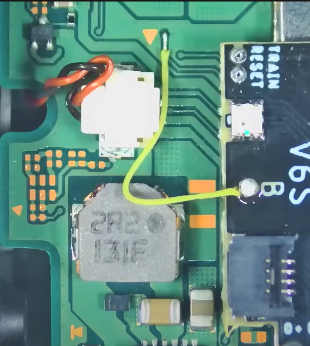

Yes, it serves a purpose. The least invasive solution is to cut a hole for the chip with a dremel, see photo
Cutting of the shield is not required. You can run the wires carefully through the hole where the fan is and lay the board on top of the metal guard, just place some kapton tape to keep from shorting.
