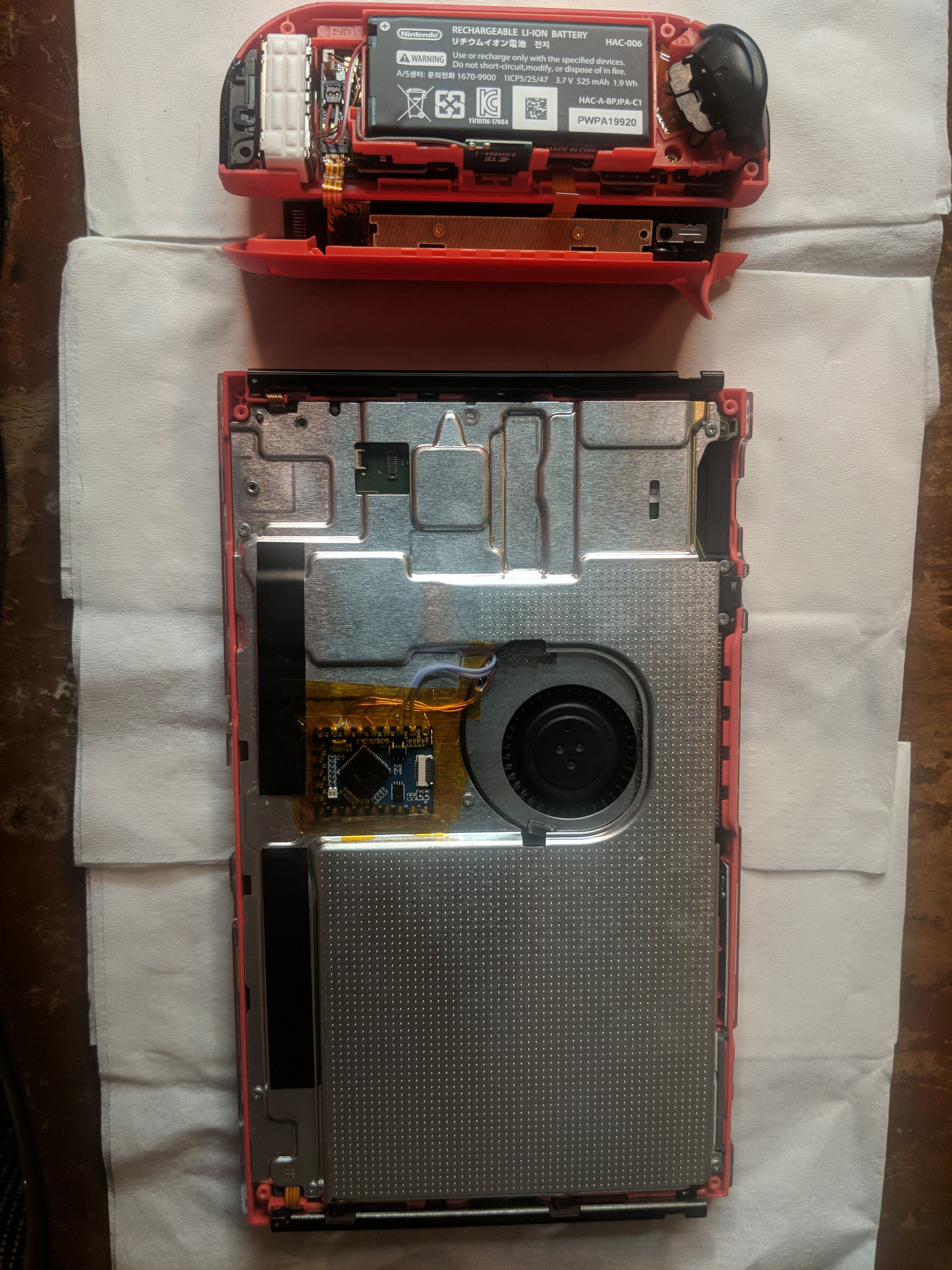

Cutting of the shield is not required. You can run the wires carefully through the hole where the fan is and lay the board on top of the metal guard, just place some kapton tape to keep from shorting.View attachment 419356
This is what I prefer as well. Just additionally grinding a small hole in the corner to make a cable way to relieve stress when closing the metal sheet instead of getting pressed with the fan.

I always preferred the method of cutting the metal protection with my dremel. fits Modchip better.

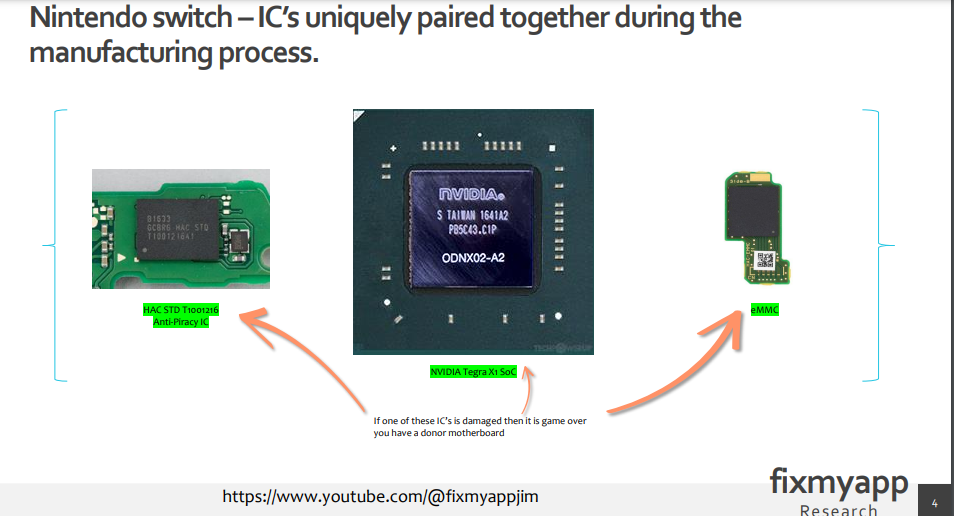

I doubt that emmc married.
Many people modified that successfully.
Some say it is not paired to the cpu so i haven't changed that ic yet. I have checked the pmic , it seem to be ok (no crack, no evidence of work on it) . there was a missing pad on the missing cpu board but i don't think it a funtional one so i ignored it.

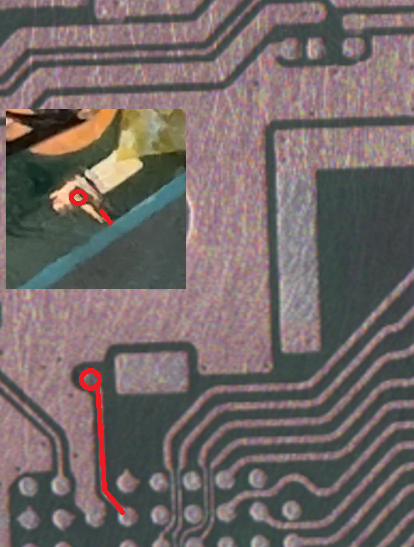

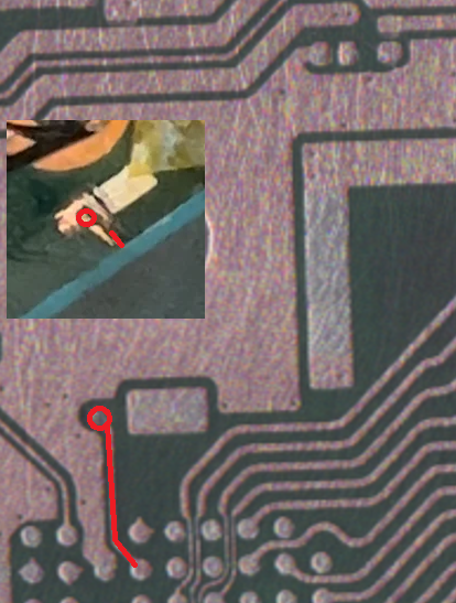

Hey yall, I tried installing picofly 2040 on my oled and I kept getting the *== error then it booted to ofw. I used the fpcb cable and the voltages read correctly and so I unsoldered the D point. Doesn’t want to boot anymore. I desoldered everything and nothing. I made sure the mod chip threw other codes by unsoldering the B wire and C wire. But anyway here’s a pic. Should I diode test something? D still measures correctly.
Are you sure your red circled via point still have connection to the rest of the red trace? Measure the continuity if you have sharp prob lead

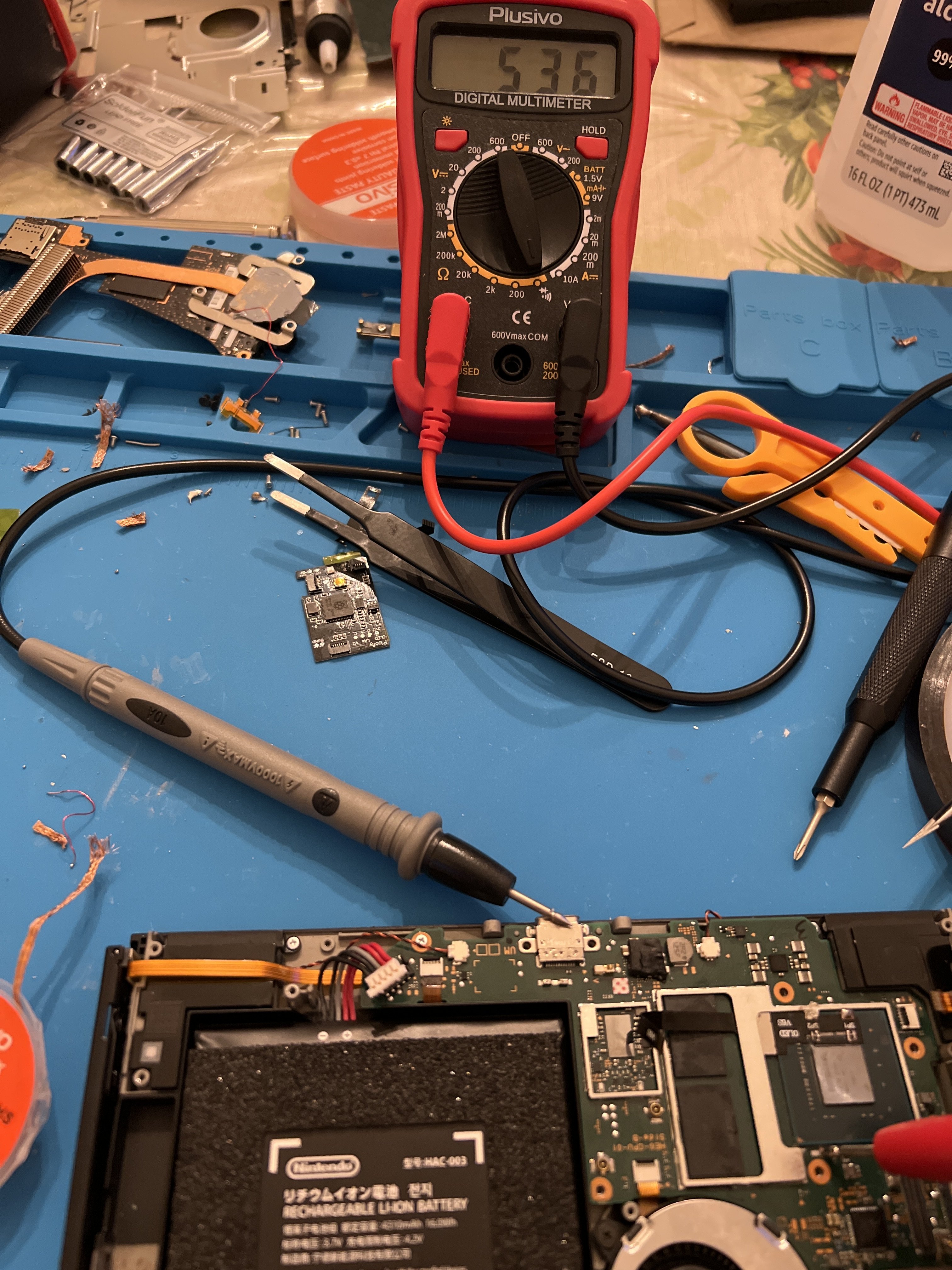

Yup the dot reads 535
I also noticed that if I prob the trace line not the via, it’s 619. Would that cause the switch to not boot up at all? Regardless if the mod chip is on?
It is. You have to make a blob between the trace and the via as my picture below i took from a case i fixed or run a wire connecting them.

you cutted the CLK point. Naturally the Switch wont power on or boot. I agree with @jkyoho, you need to rebuild via. Be very careful not to destroy the litle piece of trace that went under the Tegra CPU. It´s your last chance because if you fail to solder a thin wire from via to trace after that only removing the CPU to get into CLK which becomes a more accomplished task.

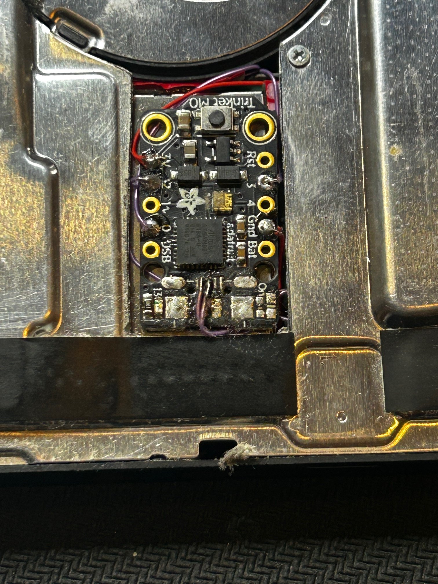

What's the point of the trinket if pico fly is much easier install? I've never installed a trinket before so I would like to know the benefit.
That is a very old photo from the time in which there was no Picofly or whatever. I used to install it on V1 to emulate RCM without the need to use a jig and to inject payload into SDA and SCL. it worked very well:)

Hi
you cutted the CLK point. Naturally the Switch wont power on or boot. I agree with @jkyoho, you need the rebuid via. Be very careful not to destroy the litle piece of trace that went under the Tegra CPU. It´s your last chance because if you fail to solder a thin wire from via to trace. After that only removing the CPU to get into CLK which becomes a more accomplished task.
Thank, do you recommend I do the wire or the blob for the sake of testing? I am waiting on my solder mask and microscope before I do anything
