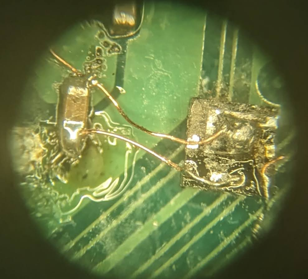

I'm getting the ==* mosfet error on my rear-soldered mosfet. Is there a way to further diagnose the error, such as low current or something? Or can I only just keep redoing and redoing the joints?
Thanks for any help!
Put your mosfet closer to capacitor and use thicker wires for source and drain
I'll try that once this 30 awg (instead of 40 awg) arrives. What's the advantage or reasoning behind that? I see it posted but I don't understand what the mosfet is doing that requires certain thicknesses. Presumably to have the lowest possible resistance?
MOSFET shorts power rail of boot processor to cause a glitch. In pulse it handles 20-40A, so you need to use short and thick wires. 0.2 mm wire is good for this job.
In your picture, the upper joint in the cap might be a cold joint since sometimes the enamel on the wire does not burn and the wire is just traped inside the solder joint while still insulated. The other points are not making good contact as well.
You should skip the wire and press the mosfet to the cap and solder directly.
See the pic (sorry for the quality).
