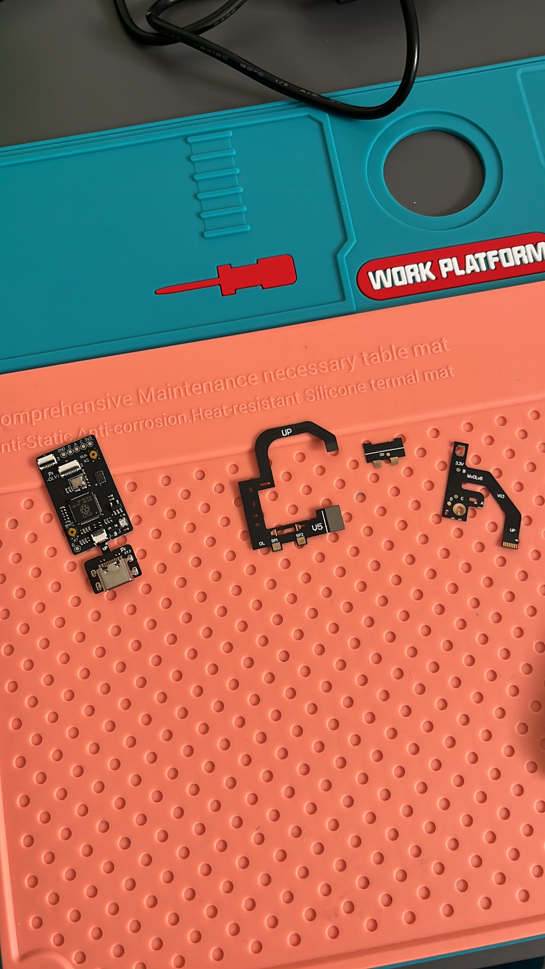

Can someone help me?
I have an oled switch with rp2040 clone. The switch sometimes starts in heckate, other times it doesn't but it tries to go in OFW, the word nintendo appears but then a black screen, and the picofly clone light is Fast yellow yellow- slow yellow. I have not found any information regarding these lights flashing like this.
also I can't go to OFW either from heckate or by pressing the + and - keys while starting the console. Help!

is the Chip Picofly ? if yes, wich resistors are you using in Dat0, CMD and CLK ? It looks to me that you have a bad Dat0 adapter (wich flows the successfully boot) and when it fails, naturally, switch will try to boot into OFW. Post some Pics please. And by the way, did the sinthoms started immediately after the chip installation ?
The chip is this one
Edit1: yes, the sinthomps started immediately after chip installation.
When I start heckate for first time, I got a message regarding slow Emmc (I think, sorry for my memory)

i could bet that the problem is in the flex that you are using .I stopped using those exactually to prevent malfunction. You can find more users reporting malfunctions also due to the use of these cables. If you remove it and do a clean install, im shure you get you switch back.
even when i have HWfly to install i reject the flex . Awg 30 is the best for me. I have been using it for over 20 years (since the Playtation Modchip)

The most common issue, replace resistors on cmd and dat0 to 100ohm. (On the modchip)
Then everything will work
Look here: https://gbatemp.net/threads/hwfly-shaped-picofly-boards-start-shipping-in-china.632179/page-8
Post #158

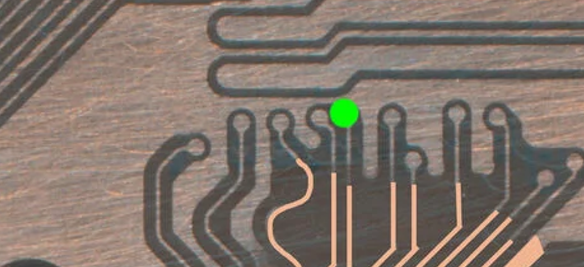

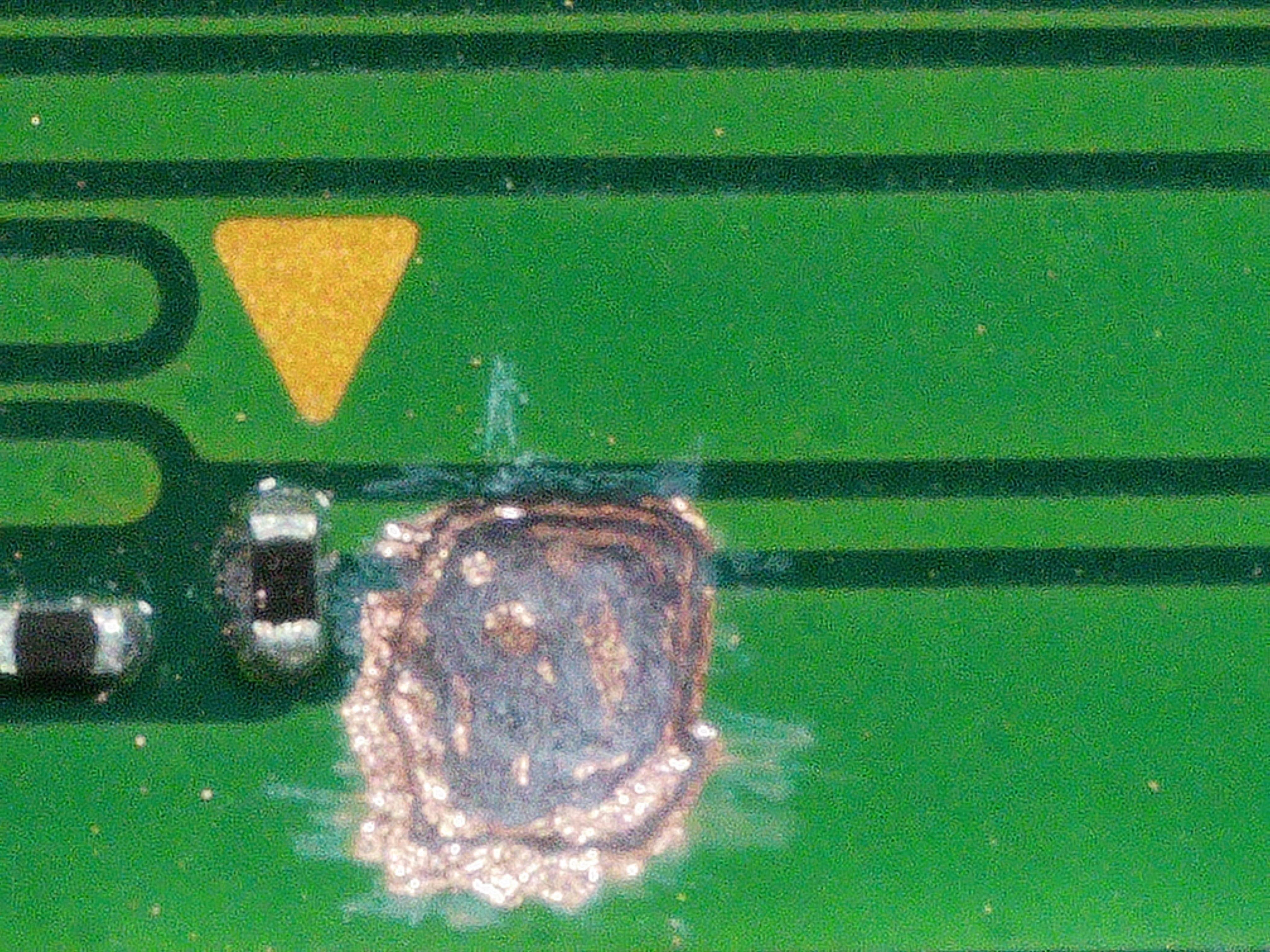

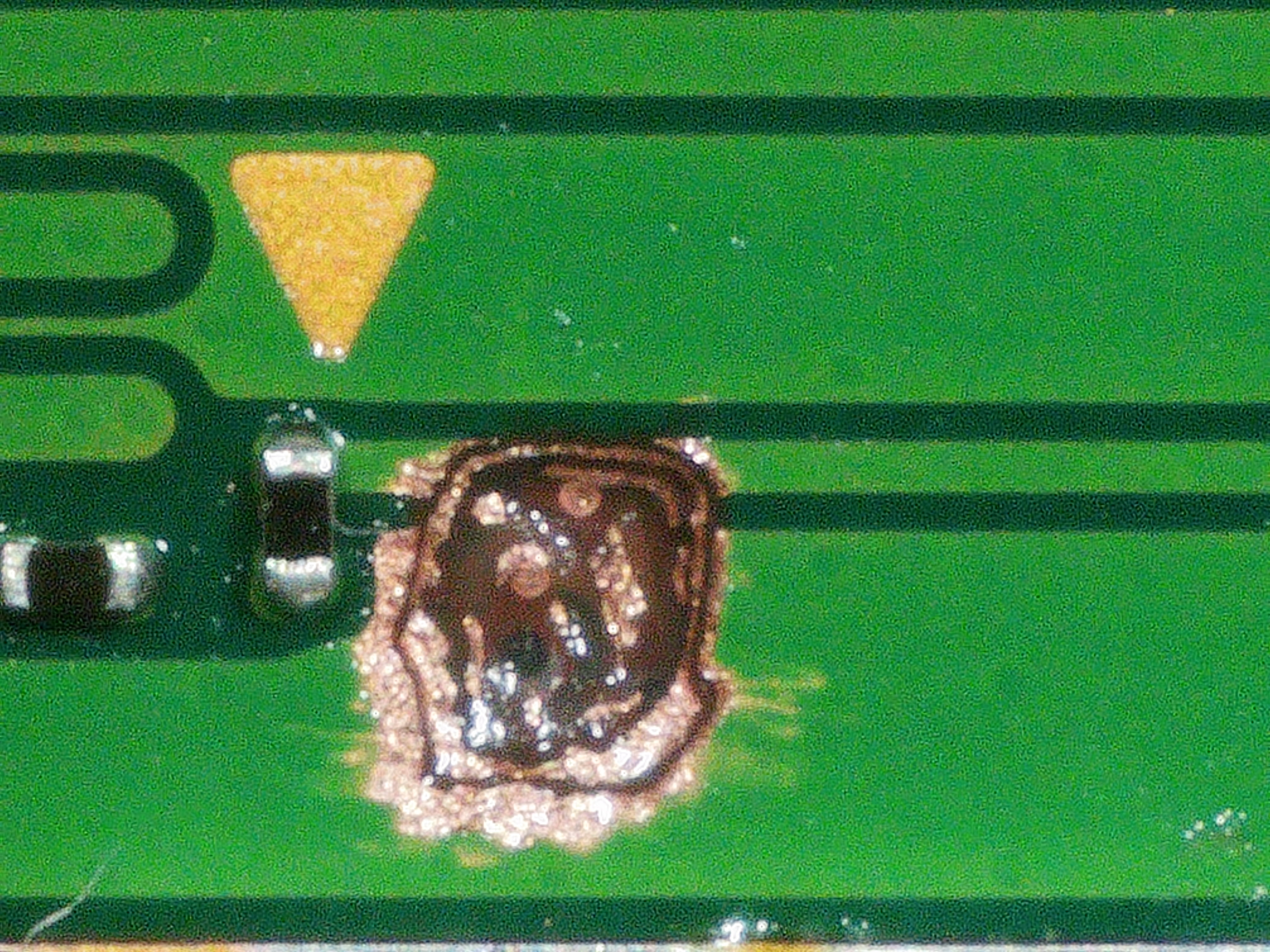

i thing i kill my oled board. can someone help with D0 pointView attachment 418388
After :
Drill it a little bit more to expose Dat1 under layer and connect it to the cpu path way via. then I protected everything with solder Mask and go for Dat0 rebuild . Used low melting temperature solder paste and reflow it for a while until the solder grab into what's left of the via.Then just put a litle pice of copper wire and reflow it again. Success :)
1529645b-0c17-4762-a4dc-5ab91b2d70f2-jpeg.418960
Thanks to @psycho-neon and @jkyoho for their excellent advices and demonstration of knowledge.

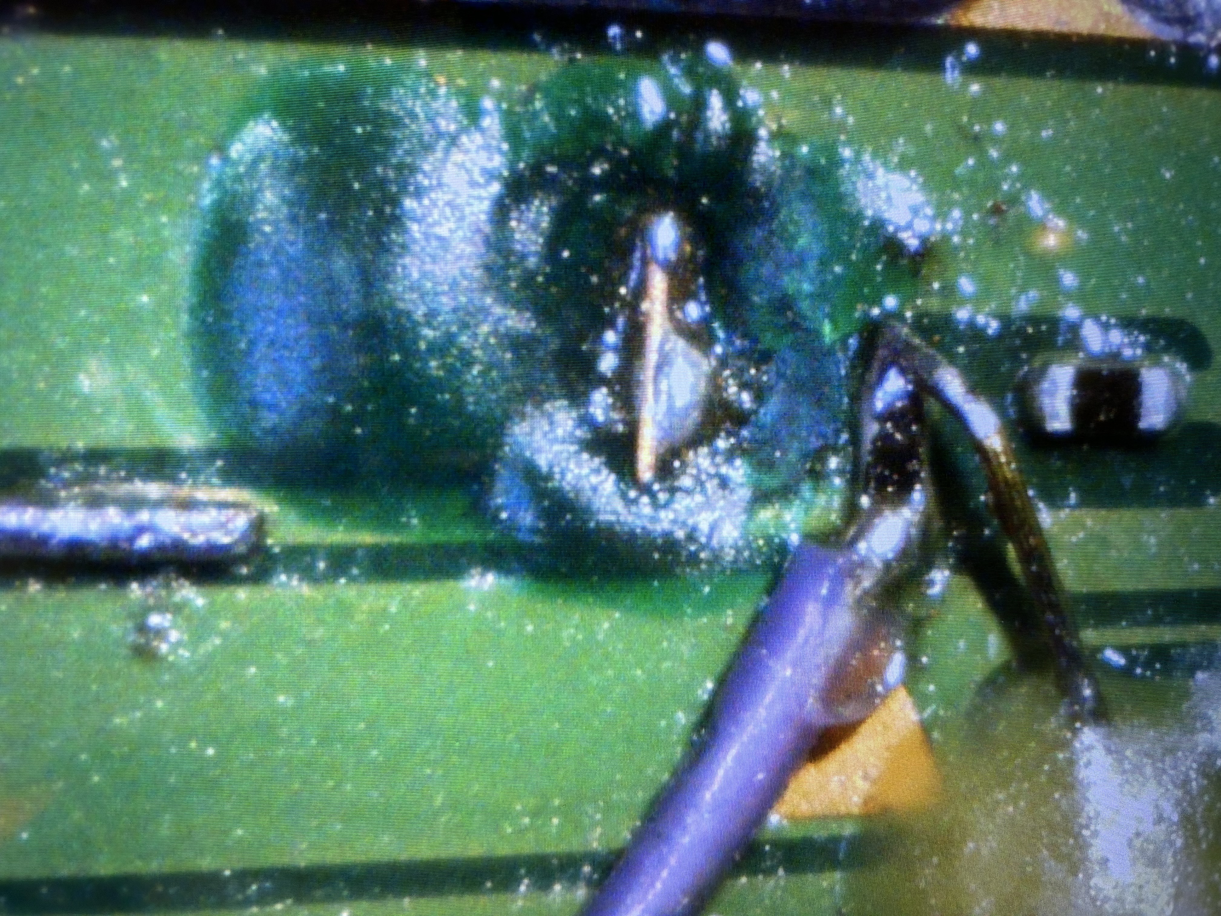

This motherboard was successfully modified by me, but at some point, after a few hours of gaming, the touchscreen and right joycon stopped working.
So I disassembled the motherboard and when reassembling it something made contact (I put the metal protection back on the nand and it moved to that area making contact) and this chip in the image made white smoke. I think it doesn't work anymore.
Is there a way to see if this chip is still alive?
Anyway....This little chip What is it? I'm looking for it on aliexpress

@Viktorsilva
A series of unfortunate eventsView attachment 419003

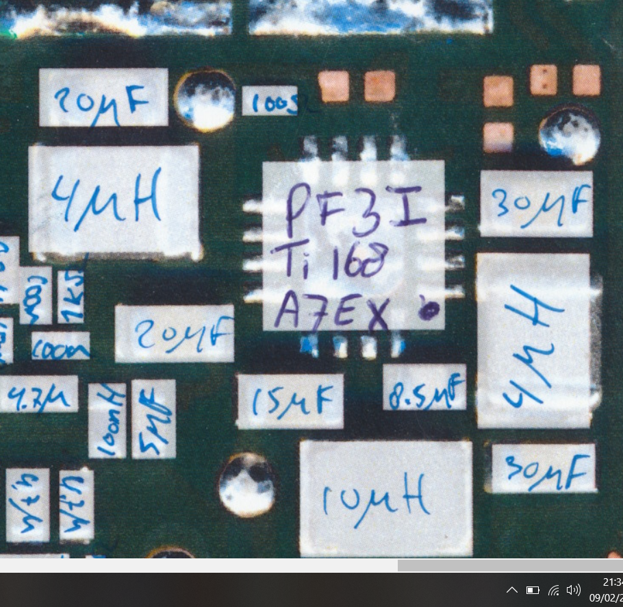

So this is the component that you may have broken :
a 4MH ceramic inductor\capacitor. Test it putting the red probe off you multimeter on one edge of the capacitor and the black probe on the other edge (in diode mode\continuity mode) and see if it´s bridged to ground. If it is, most probably is broken.
you can check in this video how to do a capacitor check:
The lcd models like V1, V2 and lite have a backlight circuit. But Oled screen have their own independent light sender, that´s why is called Oled (Organic Light-Emitting Diode). That said, im not shure if that component could influence the absence of light on the screen (probably yes). Have you tryed to remove completly the Modchip installation ?

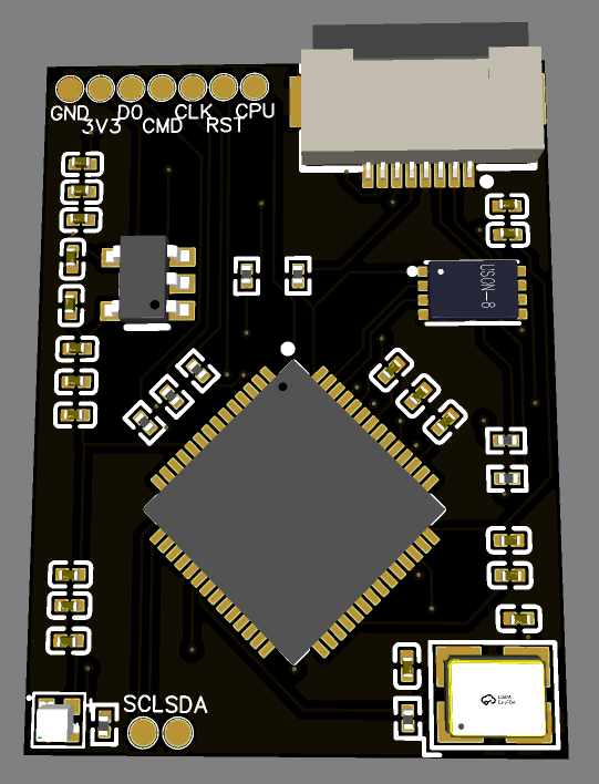

Tried to modify RP2040 Tiny to easier cable routing. Let's see how it goes once they arrived from jlcpcb.
it should be a great solution .Any idea on the final price for each ?
