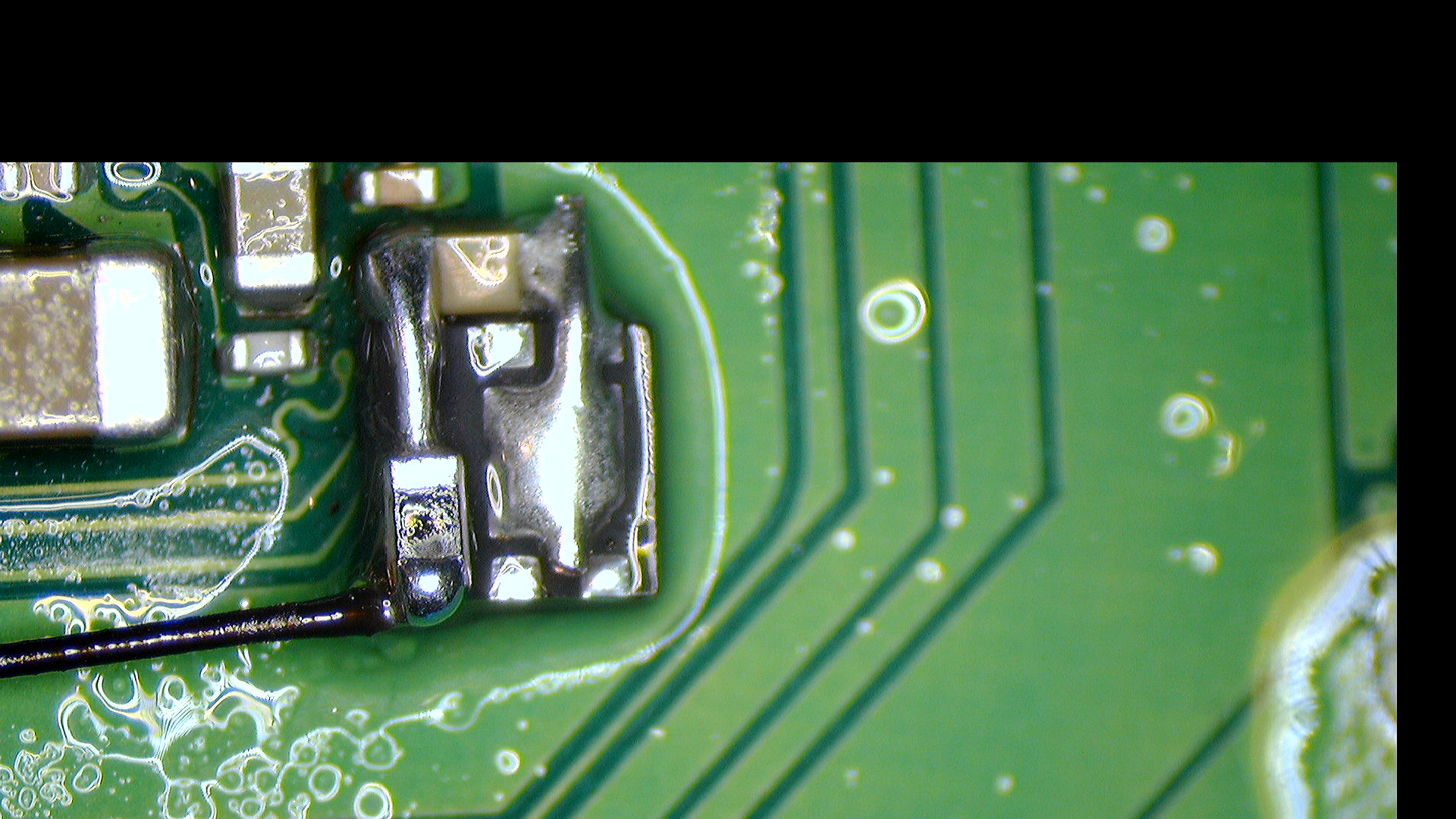

Hello fellow modders!
I have an OLED switch modded with the 2040 zero chip.
It always has a problem of inconsistently not booting into hekate, instead going straight to OFW, which was solved by rebooting several times until it finally starts hekate.
But now I've tried too many times to boot without success.
Upon inspection, my chip blinks the Long-Short error, indicating that D0 is not connected. I checked the wire with a multimeter and it looks okay.
Can anybody help me find the problem? Thanks :)

Its the dat0 adapter issue. It may give you a reading, but it could be shorted to dat1. I would suggest to re-set the adapter and give it a better anchorage.
Otherwise, if you have the tools, go for reballing or kamikaze.

That´s a common error on the Oled. Dat0 adapters are crappy. You really need to push it underside EMMC after you get shure it stands in the right place. At the same time you need to anchor it with solder.Only then you can stop pushing it underside. In you case, i bet that multimeter gives you the right value because when you touch the dat0 adapter, you press it just a litle bit but enought to make contact. Im shure your RP2040 will start booting again.
You can try Kamikaze or Reflowing the nand and solder dat0 directly in the bga point. Those are solid connections!

Dat1 via is gone ? At leat it looks like yes. All ready reply to you PM. You can bring your switch to me and maybe i can save it. I advise you not to do anything else. I live next to Parque das Nações .
i did successfully rebuild 2 vias on a nintendo switch oled in a very similar disaster. You can check it on this thread :
https://gbatemp.net/threads/picofly-a-hwfly-switch-modchip.622701/post-10349793
Dont forget to isolate the cpu solder points with kapton tape. Clean all the area with IPA solution first.
Kamikaze mod is risky but provides a solid connection to Dat0. Yes, you can reball the EMMC and make it solid too, but you will create thermal stress on solder joint and if i can remember problems like RSOD on PS3, PS4, Xbox 360 , etc....they all where created by the thermal stress (composition of lead-rich tin with low temperature melt point) even with professional welding done on a factory production line.That´s why i prefer the kamikaze too. Dat0 adapter could bend after some weeks (caused by heat).
Nah, RROD and YLOD was caused by lead-free solder that was cracking due to thermal stress.
if they had used solder with lead the problem would not have happened.
But due to the regulations, you cant have lead in your products and thats why they used a lead-free solder alloy that was not tested enough regarding thermal stress.
Lead solder is always better, except for health issues.

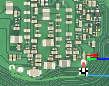

Here's two easier/safer mosfet positions on the back of the motherboard for the Switch Lite. They're both working fine. I moved the rp2040-zero LED to the home button led while i was at it just to test. Looks pretty neat, but not very useful.
I will personally not be using these points since the added time it takes to remove the motherboard makes it not really worth it for me, but I guess they might be helpful for people with less experience who are afraid of the apu caps.
I believe the big pad super easy position on the back for the OLED that I posted about before should be the standard recommendation though; it is far superior to all other locations (the pads are even pre-tinned!) and the motherboard has to be removed anyway.

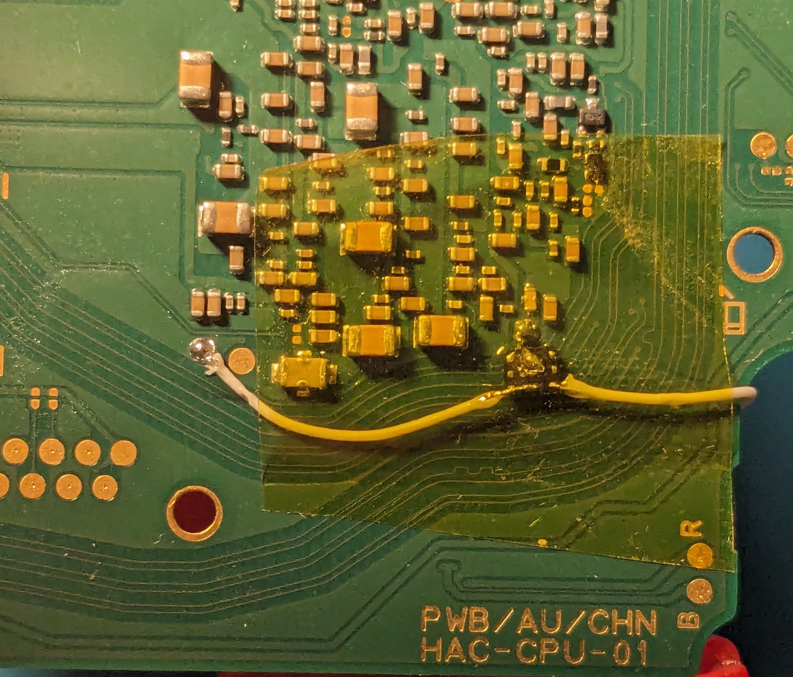

Been browsing the last 200 pages to try and find these references lol! Thanks for this image - I'm also trying to find the same kind of point on the V1/V2, to save the images for reference. Do you happen to have one for those as well?
I poked around with the multimeter, here are the points on V1/V2:
Confirmed working as well, I just finished installing the picofly in a V1.
Or my shitty drawing of it next to the original back mosfet location from Abal.
