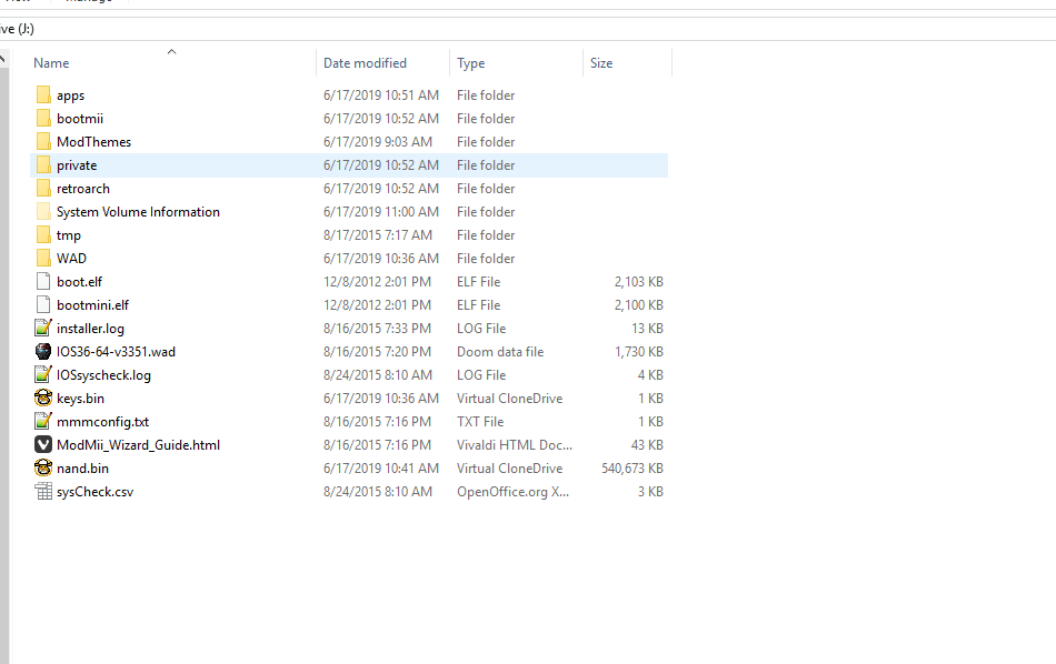

Hey guys,
I'm sure there's been at least 300 other people that have asked similar questions here so please bear with me. I've finally gotten my Wii out of the box I've kept it in over 2 years in order to finally play some games.
But when I turn my Wii on with an SD card, I just get a black screen and repeating blue flashes along the Wii's disk slot/tray. When I turn my wii on without the SD card, however, I can freely access the system menu.
Something to note is that without the SD card, I'm still able to access Priiloader. But with the SD card, I can't (this might just be due to me fucking up by pressing and holding the RESET button either too early or too late)
I have a NAND and key backup from when I first installed BootMii back in 2015. I did a chkdsk /f on the SD card, and while it worked after with the card in, I put the SD back into my computer to back everything up and reformat the whole drive to deal with some corrupt or undeletable files (I obviously then placed everything back in the SD card). From what I know, no major files were corrupted (like the nand.bin).
Is this a brick? And more importantly, can it be fixed?

Hello.:)
Please can you try to read the SD Card on an PC ? And could you be so kind and post an screenshot from the Folder/Content of it please ? To get sure it is not the SD Card itself.
Thank you.:)

This is the root folder of my sd card if that's what you're looking for (August 2015 was when I originally homebrewed my Wii, June 17th was when I reformatted and backed up my SD card.
Thank you.:)
Can you copy this content to another SD Card and try this one please ? To exclude that maybe your SD Reader from the Wii is broken.

Sounds like your booting into bootmii but the video mode isn't being displayed on your wii. Use a bootmii config editor or manually edit it in notepad to try a different video mode.
Edit: or just rename the bootmii folder to something different, but you will want access to bootmii for brick protection so just renaming will solve the immediate problem of loading the system menu but not the root problem.
If it was just video mode that wasn't loading properly, wouldn't I still be able to use the wiimote (and wouldn't the disc tray not keep flashing repeatedly?). Anyways, renaming bootmii worked it seems, but I'd like to keep that on.
My bootmii.ini looks like this.

Got a breakthrough! I found the older bootmii files that I had right after 2015 and put them in the bootmii folder. The Wii launched with the SD card in!
However, I won't say I fixed it yet, until everything seems safe.
