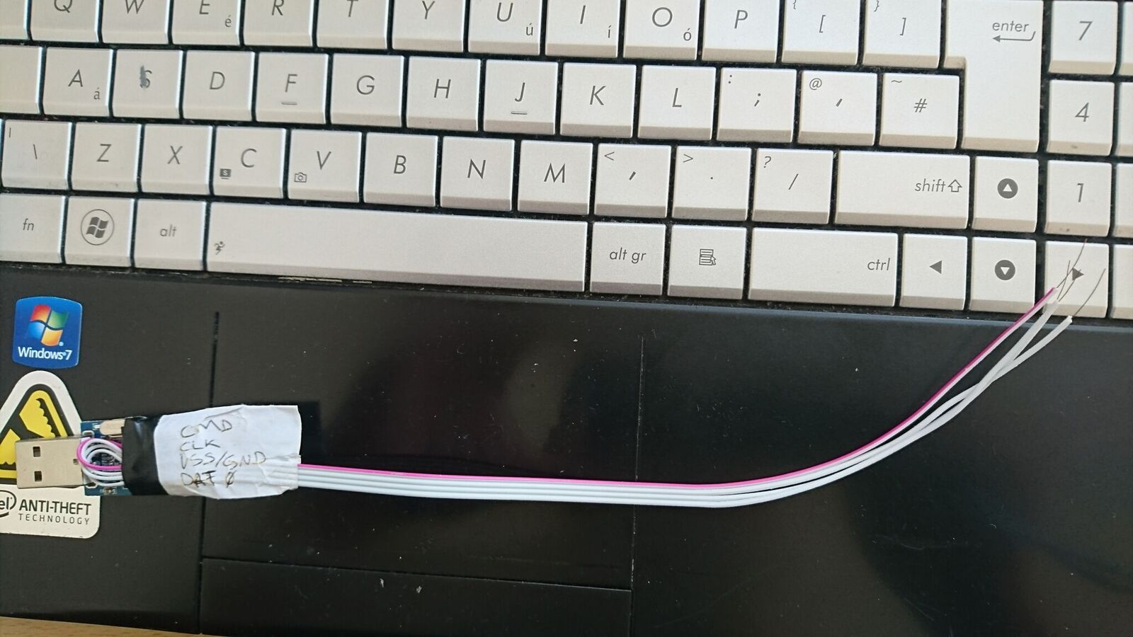

i have soldered wires on my 2ds when i plug it on pc i get blue screen with 00000200 but nothing happen on pc there is no message to format---sorry for my bad english

Provide some images of your SD adapter and the modifications done to your 2DS

Thats a microSD card reader, you'll have to solder directly to it instead of the franken SD card reader like I did to mine
dsc_0496-jpg.44060
Also we won't know if your microSD card reader will work without knowing the chipset, you can see this is a GL827L. Notice the blob of solder I put on my card reader to bridge two pins on the switch wire that detects if a microSD card was inserted.

is that work http://img.china.alibaba.com/img/ibank/2014/254/837/1343738452_1627648519.400x400.jpg
