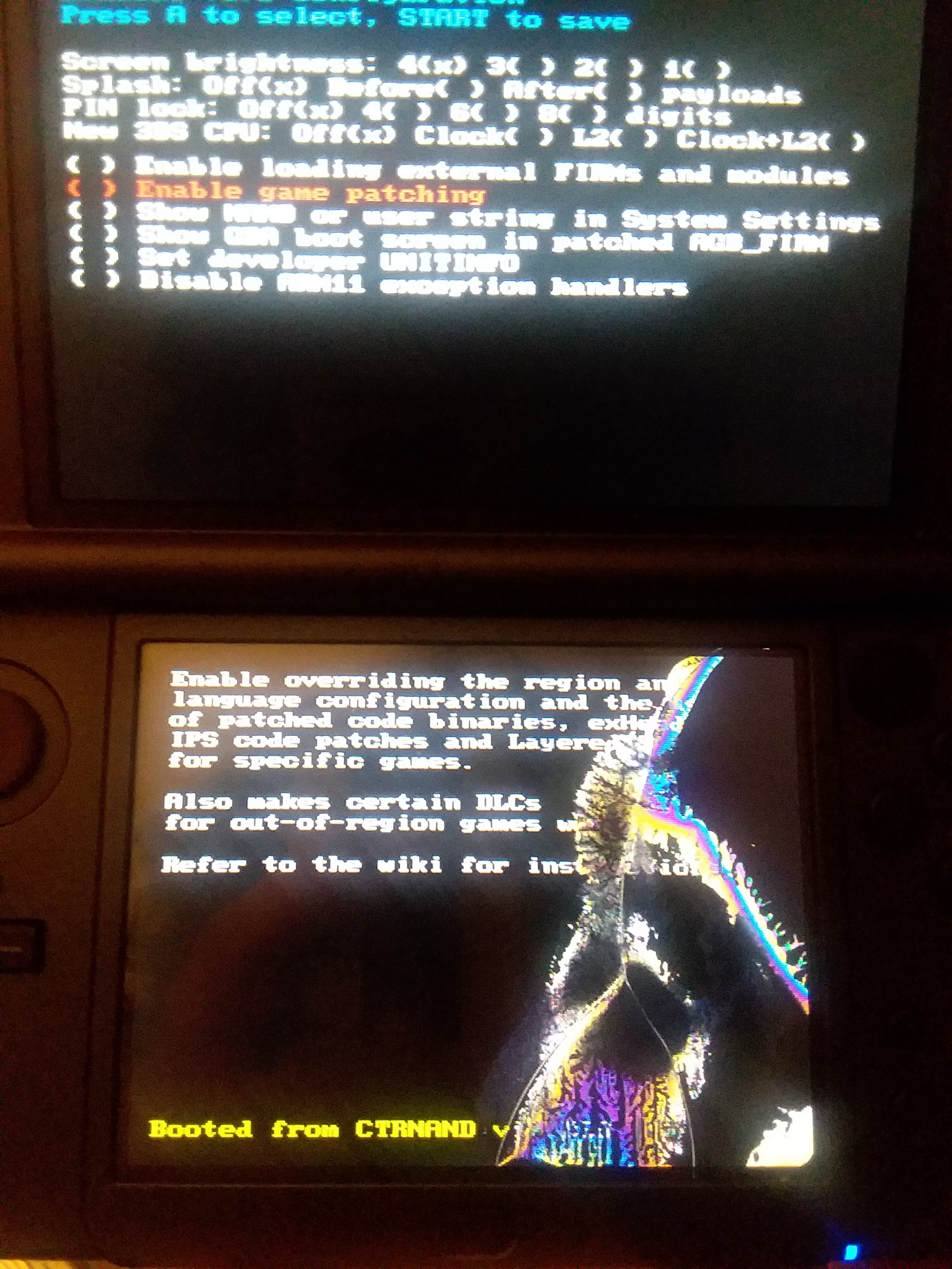

Can you reseat the golden contact patch to get those buttons to work again? How badly damage are we talking about here? Pics?
  • Dent in the battery socket that causes the magnet to freak out at times
  • Loose as hell AYX buttons
  • The touch screen is half dead
  • R and ZR won't work at random times
  • I managed to fix it but at first the power light wasn' working, that's how I eventually learned that the magnet was freaking out
  • Pic of screen below:
    It'd be cheaper just buying a refurbished gamestop n3ds online than getting my local repair man to fix everything

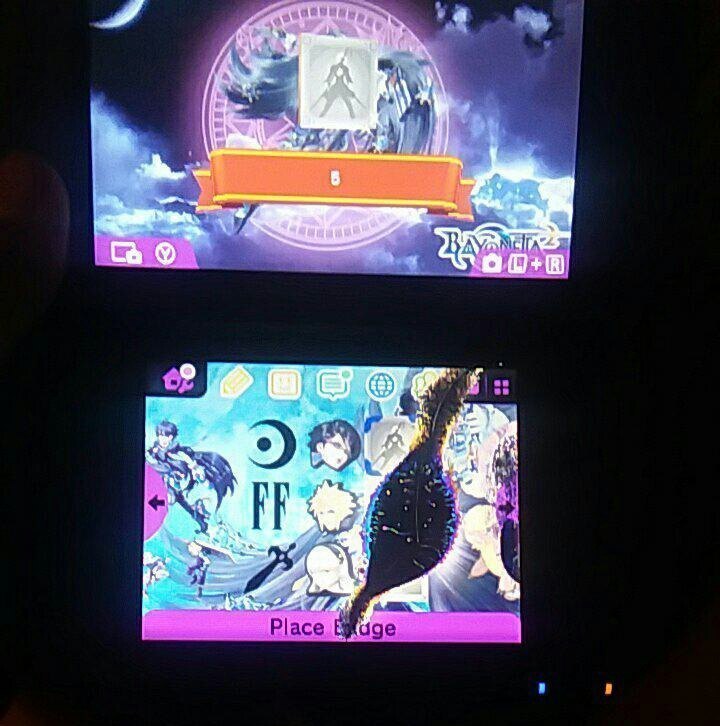

EDIT: More recent picture, this is from after I dropped it:

Lol i'm gonna tell you right now, this is an extremely easy fix and much cheaper to repair than buying another console.
Simply buy a new replacement screen bottom screen for your model.
An example: https://m.ebay.com/itm/NEW-Nintendo...B0AAOSwqrtWofgO:sc:USPSFirstClass!02906!US!-1
What is the nature of the broken buttons? How are they broken? Are the contacts bad or is the plastic you press broken? Is it the rubber pad? You posted a photo but there is no lighting to make out anything.
If it's the contacts, then you will need a replacement daughter board (power board). Those go for $10.
If the plastic buttons, $10.
https://m.ebay.com/itm/2015-New-Ver...y4AAOSwDrNZREIi:sc:USPSFirstClass!02906!US!-1
Here are the rubber contacts. $9.
https://m.ebay.com/itm/2015-Nintend...rwAAOSwXz9ZlojB:sc:USPSFirstClass!02906!US!-1
His system is a New 3DS. You can't buy replacement bottom LCD for this system.
They've only started selling the top LCD some time the last few months at aliexpress, so there's hope for the bottom one available later.

Cool, good thing mine's an XL and that I just wanted the files so I can gut it open later, also no it's worse than you think, I used industrial pliers to squeeze the buttons down and I don't think a loud crack should've happened
Follow this repair guide: https://www.ifixit.com/Teardown/Nintendo+3DS+XL+2015+Teardown/36346
Step 19, picture two:
53GNqvVGkG4VpnJ6.huge
Check if your golden patches shifted or do what @Pluupy stated, replace that board outright.
Steps 21 & 22 for lower LCD replacement.
Oh crap what were you trying to do?!
But yeah The ABXY buttons of the new 3DS are conveniently on their own board, seperate from motherboard, so replacement is very easy. If there was a snap, then either the buttons themselves broke underneath or the board.
If the c stick, some buttons, and console power is still functioning, as the daughter board is responsible for those, then it's likely you just have broken plastic on your hands.
Best to open up the console and give it a look. Of you happen to open it up, be careful when removing the bottom after removing screws, as there are four ribbon cables attached to the base that can easy break.
