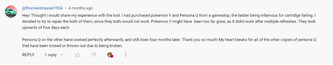

I had this comment on the YT video
  • Love
Reactions: impeeza and SMNFXCN
