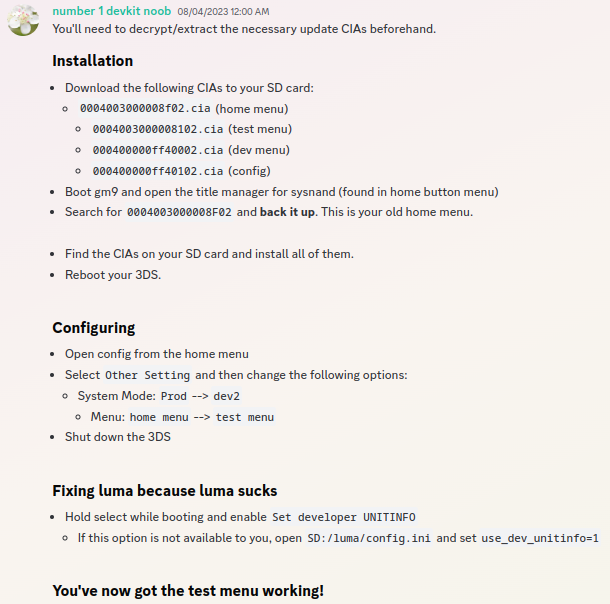

One user tested the SystemUpdater on real development hardware and it would not boot, likely due to age. This also will not normally install on a retail 3DS with CFW, though there is a way to boot just the home/test menus and dev apps. Instructions are pictured below:
Reminder that development software can be unsafe for the average users and you should only download for research and only use if you know what you are doing.
