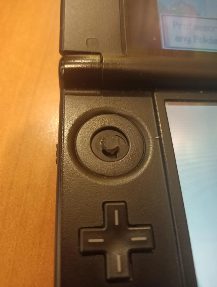

Looks like theres a plastic part under the rubber part that crumbled into pieces. Do I need a new joystick module or do I just need one of these caps?: https://www.amazon.com/HeOTER-Joystick-Thumbstick-Control-Replacement/dp/B0DKMX73Z2
If its the cap, can I just slide it over this nub?
For $9 you might as well spend a tiny bit more and get teh whole module and rubber piece and do a full replacement. You can get them for $10 on aliexpress or like $15 on amazon
The part wears after a while and gets hard to move. So you might as well just do the whole part and only open the system 1 time
woooow when I did buy mine couldn't find any module replacement in less than 40 bucks.
Maybe I got lucky ? I did this last year and a local shop charged me $50 to install it
Albeit maybe a bit high for an install but I refuse to open handhelds besides the switch
