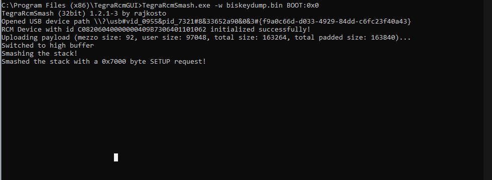

i also just tried the tutorial on this website called "A definitive way to test if your Switch is patched or not (purchases after 07-2018)"
when i run the payload it says the payload was injected but i don't get any of the keys or anything in the console which tells me the payload isn't being run. i have attached an image of the console

Just because you can inject the payload doesnt mean you're not patched. You can push a payload on a patched system it just wont do anything after. Black screen.
If your system is not patched and you get a black screen it's usually related to the SD card.
Yes, but i was pushing payloads the other week and it was working. I was running cfw and everything, until it ran out of battery and now it's not working, I have also checked my serial number on a couple of websites and it's not patched.
What else could be wrong with my sd card I have tried formatting it as exfat and fat32 and I have downloaded new files from sdsetup.
Also if it's the sd card why am I not getting anything when I run payloads that don't need files on the sd card like the one in my previous post where I wasn't getting a response with the keys.
