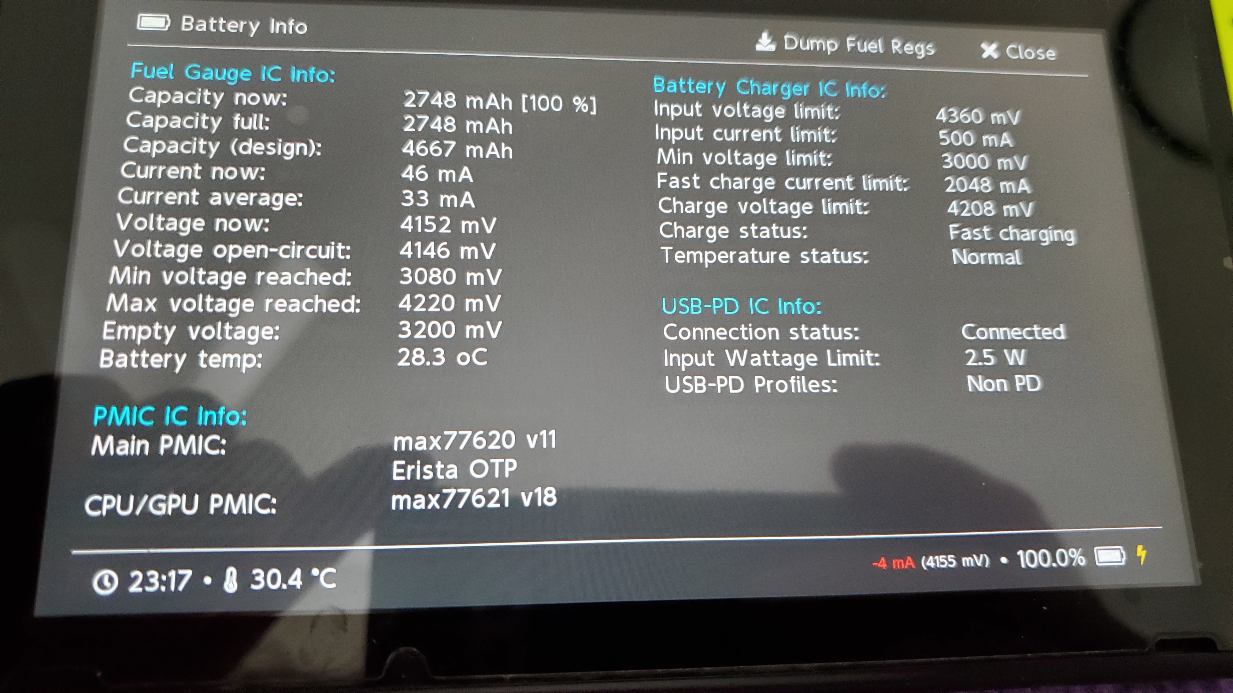

Provide a hekate battery report, show the capacity full and capacity design.
Is this what you mean?
I would love to start clean just to rule out foul play. Where would I go to find those? When I first searched, I found a guy on YT who basically was a one stop shop for all info, etc. Was very helpful for just getting started. I don't know what the MEGA pack is. The only tool it provided that I have used is DBI.
Is this what you mean?View attachment 361836
That's like half the capacity. Is it a third party?
EDIT: Tried running a desync fix?
Yes that is what I am looking for, your capacity full that is what the capacity is when it is fully charged, so it looks like you only got 58% of what the original battery life.
What is a desync fix? Yes, I think it is third party. Bought from Mobile Sentrix IIRC.
Would this indicate that the battery is not as advertised?
I wouldn't say your battery is new, or even close to new, you should have around to 4600ish mAh battery life to be consider new.
Normally when a lion battery is round 70-80% of capacity it's at end of life and will deteriorate fast.
That's pretty much dead at this point

Those instructions were given to me by somebody else. Hekate ran for almost 3 hrs! I also took this opportunity to redo my SD card from scratch.
