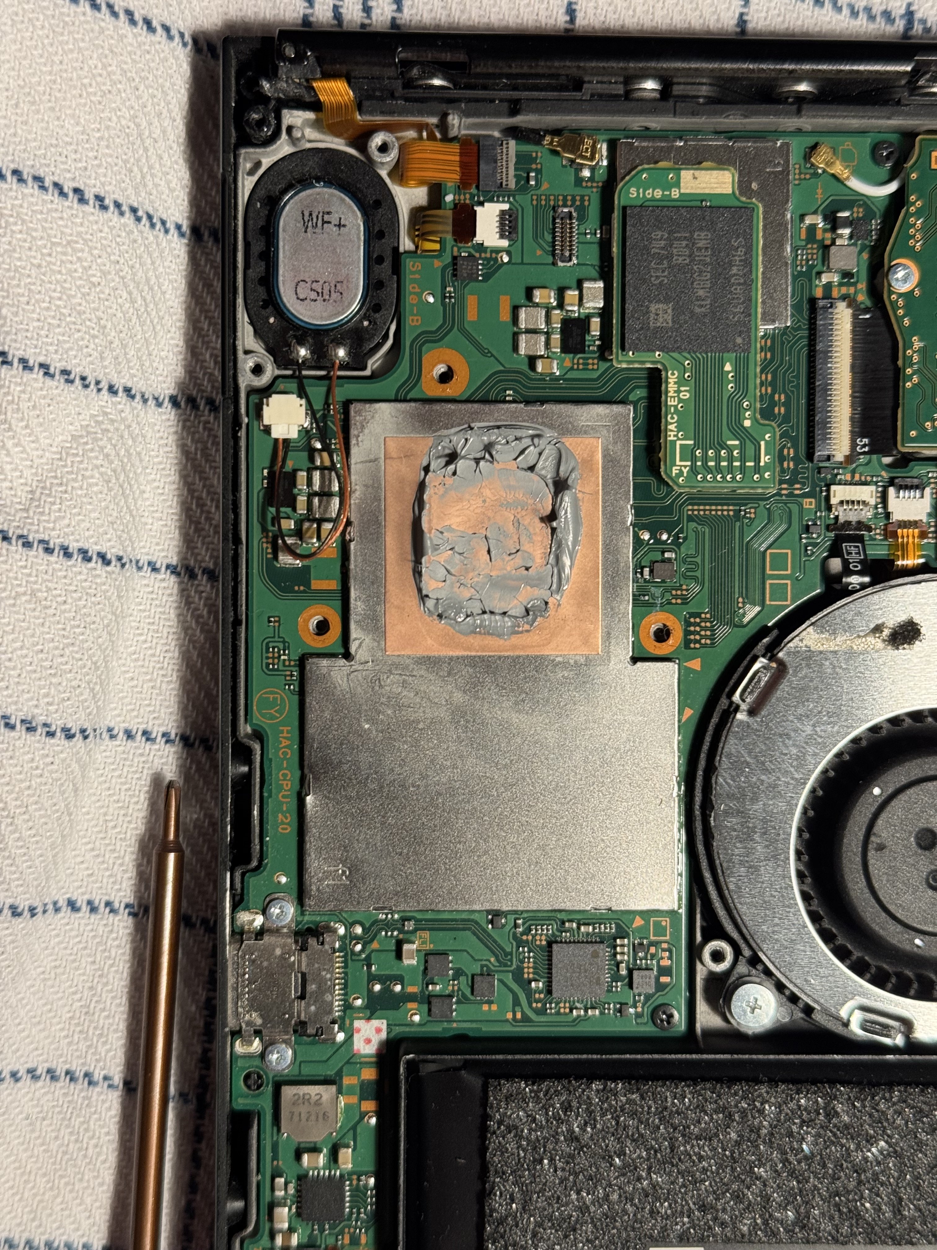

After trying to replace the thermal paste and fix the fan on my V1 switch it won't display anything anymore.
It's detected by the RCM Injector program, and I'm able to successfully Inject a payload.
I even feel haptic feedback from the controllers when booting into Hekate!
I intially though it was the SD card reader, but Injecting Tegra Explorer (which doesn't need an SD card) also has the same issue.
I then found online that it could be the 53 pin ribbon LCD connector but, reconnecting that and verifying that it's correctly placed hasn't worked.
Could anyone help me with this? I have attached some pictures, but if they're not detailed enough or don't show the necessary areas, please let me know.
Thanks!
