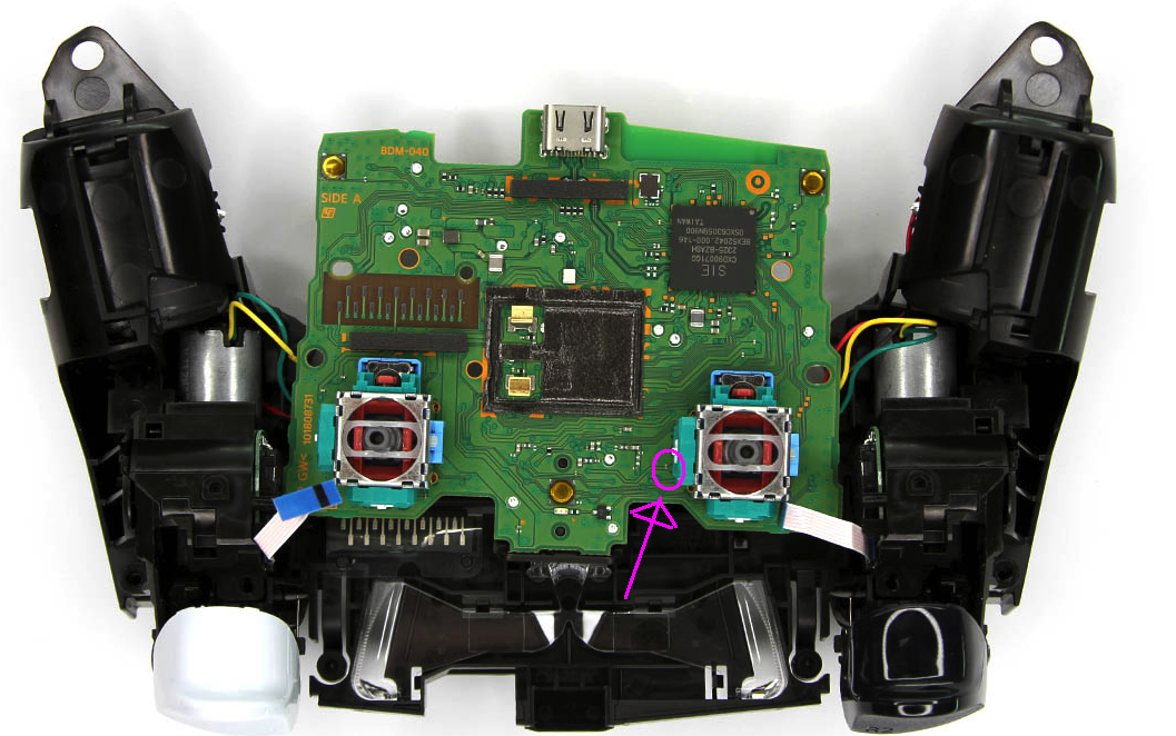

I had an PS5 controller (BDM-040 : CFI-ZCT1J) with some drift issues laying around for quite some while.
I decided to put some hall sensors in it like I have done before with other controllers.
The controller is now blinking 3 times orange when plugging in the battery or the USB-C cable.
After that no response what so ever.
Does anyone have any idea what could be causing this behavior?
Things I already checked :
- All ribbon cables seem fine and I don't see any obvious damage to the PCB.
- Someone suggested removing the sensors as a faulty sensor could also cause problems. That did not help.
- I tried resetting the controller MacGuyver style with paperclip.
- I tried leaving it connected to a charger for about 2 hours but it didn't show it was charging
The battery is now at 3.4 volt.
I read that the voltage of the battery is 3.7 volt so might it be too low already?
i charged up the battery to 3.7v with another charger but still the controller is blinking orange 3 times.
So it doesn't seem to be the battery.
I'll try to get some new ribbon cables.
Getting ribbon cables turns out harder than I thought with this gen/rev 3 PS5 controller.
China Post will deliver them somewhere next month hopefully.
I tried measuring the 'old' ribbon cables but they seem fine.
I also tried cutting off a millimeter at the bottom as someone suggested on Reddit.
But so far to no avail.
Still 3 blinking orange light when pressing the Ps button.
The search continues...
Edit :
Holy handbags, Batman!
Found the issue.
Drunk on my own confidence, there was 1 thing I never bothered to check : checking for shorts between the + and - on the PCB.
It was even mentioned in one of the first posts that I read about the issue.
A visual inspection revealed no problems but just using my multi-meter quickly revealed that there was a short somewhere.
Then it dawned to me that when removing the old sensors, I did bump into 1 tiny capacitor at the time when using some wick to clean things up. I was happy back then that I didn't wipe off that capacitor with the wick but I might have bridged both the legs of this capacitor. My camera could not zoom in enough to see if that was the case.
It sits right next to one of the sensors. Note that another of such a capacitor sits in the bottom right of the other sensor.
It's just a super tiny capacitor but it only sits between the + and - of the sensor to smooth the voltage line.
So it isn't really a problem to remove it, especially with a hall sensor.
To check for a short, just measure continuity between the outer legs of the sensor.
Any sensor will do as they all have their outer legs connecter to the + and -.
The middle pin is always the signal pin for the sensor.

After removing that tiny capacitor, my short was gone and the controller worked again.

This fixed my issue. It was the bottom right of the other analog sensor. Bridged solder from my botched thumbstick replacement, but cleaning the solder has returned operation to my dualsense controller. Thanks for solving this.
