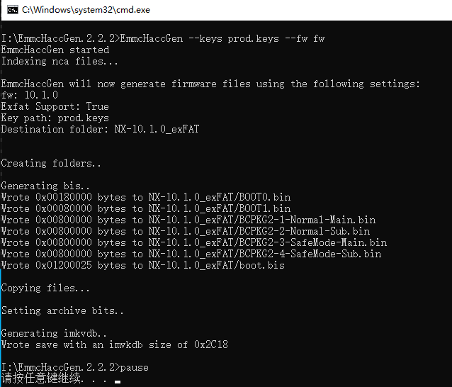

I have a switch mariko (motherboard from the factory, no official system), it can't start, stuck in the second LOGO (not a CYW4356 problem), I used the latest LOCKPICI_RCM to extract the prod.keys, and then tried to restore it through the USB cable. Finally, I tried to use SX CORE to start TX OS, but it was still stuck in the second LOGO; if Spacecraft-NX was used to start the atmosphere, it would prompt Unknown pkg1 version.

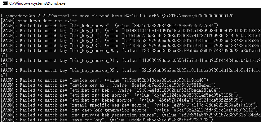

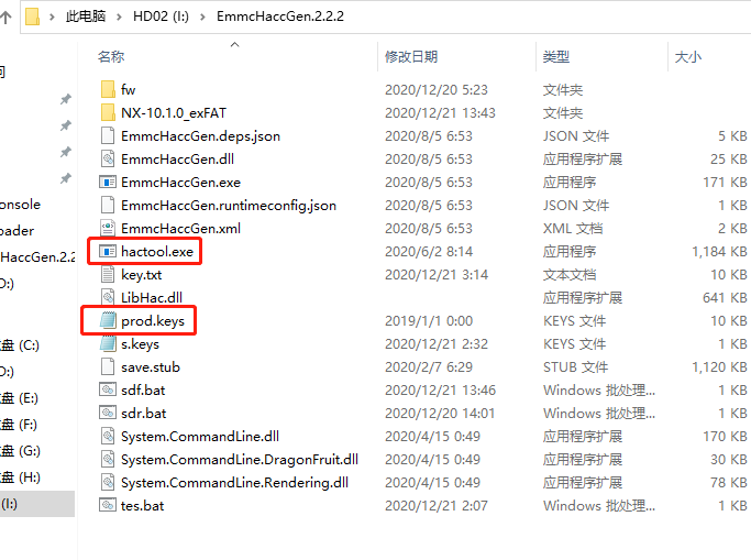

But when I use hactool.exe -t save -k prod.keys NX-10.1.0_exfat\SYSTEM\save\8000000000000120, it always prompts that prod.keys does not exist. The following prompt is also that the key does not match, but I have put prod.keys In the same directory, and it is effective to decrypt the system smoothly.
I have also seen that when someone uses hactoo, they also receive a prompt that this prod.keys does not exist, but they don't know how to solve it.
If you can answer my question, I will be very grateful!
